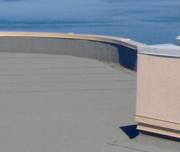

Gotta like a spring-loaded roof hatch that isn’t locked. , a beautiful roof and a nice view of Mount Baker, Washington.

Nice pic John, most of the hatches I get to go through either don’t want to open or bite your fingers when the lid closes.
As for the roof covering, it certainly looks shiney and new, but I’d question the lack of cant rail where the flat roof transitions up the parapet wall, that covering will crack along that interface.

Thank you, sir. Good point, all the inboard structures have cant strips but there are none along the outer parapet wall. This may have been a Tar and Gravel roof originally, BTW. The drains are in depressed channels along the outer walls.
The important thing for my client buying the condo unit was, yes, the roof has been done.

Do you expect to see cant strips on all flat roofs and do you write up missing cant strips if there are no seams at the transition area?
I’ve done many commercial flat roofs in Boston and many do not have cant strips installed. They do continue with the rubber right up alongside the parapet with no seams involved. I don’t have an issue with this. If you do, I’d like to hear your reasoning.
Hi Dave,
no I don’t write them up on some membrane roofs, it depends on the manufacturers installation instructions, however I write them up on all modified bitumen & T&G roofs, none of the ashalt based systems have the flexability to cope with the differential expansion between to roof and wall intersections, and they will fail quickly.

EPDM is the only roofing material that will transition properly and fold at parapet without causing an issue. But… do that what another roofing material and you’ve got imminent issues.

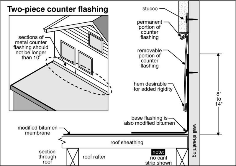

From these two illustrations, a wide metal flashing is another possibility?
They may have torched-on right over the flashings.

John, your 0106.jpeg is IMO as bad as just running the mod bit straight up the wall, as it is a 90 degree bent single layer it will still fail very quickly. I have the same illustrations myself, but have never seen one done like that, and would write it up if I ever did.

Thanks Gerry. I will agree with your judgment on this one, as I am not quite smart enough to disagree. Or dumb enough, either. :p:p
