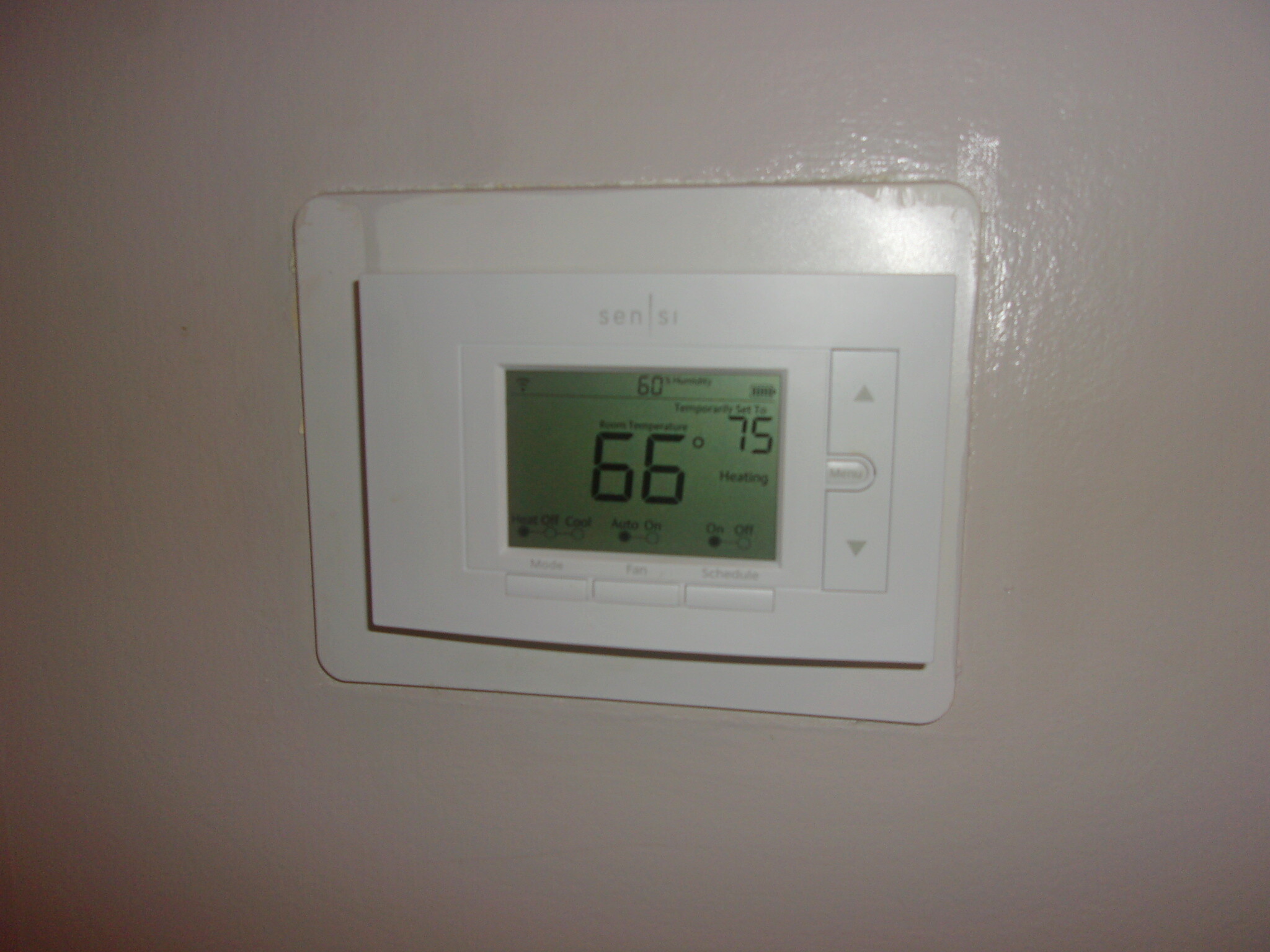

Hey guys, I inspected a home today that had an older Ruud heat pump. The data plate said “air conditioner” but the model number (UPKA-035JAZ) says heat pump. The label on the unit says “heat pump”. The thermostat didn’t have an emergency/auxiliary heat setting. This is the first time I’ve come across a heat pump set up for cooling only. When I tested the heat the furnace in the crawlspace came on. I didn’t test the cooling since it was 37 degrees outside. Now, I don’t know if the Ruud unit works. I can log all this in the report and recommend evaluation by a qualified HVAC specialist, but I’d like to know for future reference if anyone has come across this setup, and is it ok?
Did you see a reversing valve anywhere in the condenser? I could be wrong, but I feel like I’ve seen some units labeled with “heat pump” but no reversing valve and set up as AC only with a gas furnace.

Hey Michael, I didn’t see a reversing valve, although I didn’t look as closely as I should have.
Hey Brian, Yes, there was a Ruud furnace in the crawlspace. Same age as the heat pump.

Is there heat in the house?
Yes, and it worked.
The thermostat is not for heat pumps but it works just fine because you have a furnace for heat.

Hey Thomas, Thanks for the diagram. I’m aware of the operation of a heat pump, I’ve just never encountered one that was setup to be used for cooling only.
Hey Dave, thanks for your response. Back to my original question; I’d like to know for future reference if anyone has come across this setup, and is it ok? In reading your response I can’t quite tell if you’ve encountered this type of setup before, or if you consider it ok.
I have a heat pump duel fuel setup. I have rarely used the the heat pump for heating. It’s mainly my AC cooling when used.
Hey Thomas, I just moved into a house that has a heat pump with a gas furnace for “emergency” heat. I hate the heat pump heat so I use the furnace to heat and will use the heat pump for cooling. Similar to what I encountered in the inspection today, however, I’ve never seen it setup in this fashion; a heat pump without an “emergency” heat setting on the thermostat. As such, I didn’t know if there were any different ramifications I was unaware of or didn’t know existed. Thanks again for the feedback.
I have a heat pump with gas backup at my house and there is no auxiliary heat option on my thermostat. Mine switches to gas when the outside temp drops below 40.

Thermostats on southern states HP’s does not need an EM / Aux switch because much of the time there is no 2nd stage heaters installed. They are an option, not a requirement. So if you find them missing it was likely intentional.
