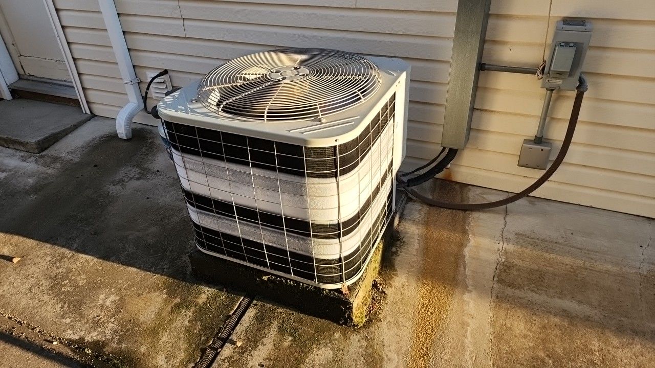

Do these frost stripes on the heat pump mean anything? I have not observed this before.
There are many reasons for this to happen. Google it.
Looks normal for a heat pump in heat mode, it has a built-in defrost cycle to melt built-up frost. As long as it’s heating and does not ice up entirely, you’re fine.
Thank you!
It’s low on refrigerant charge.
Defrost sensor does not get cold enough to allow defrost. Eventually it will totally freeze up.
What was the ambient outdoor temperature and humidity?
