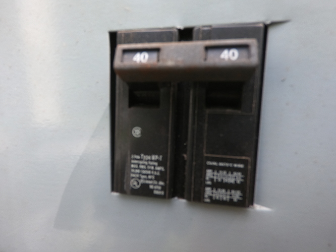

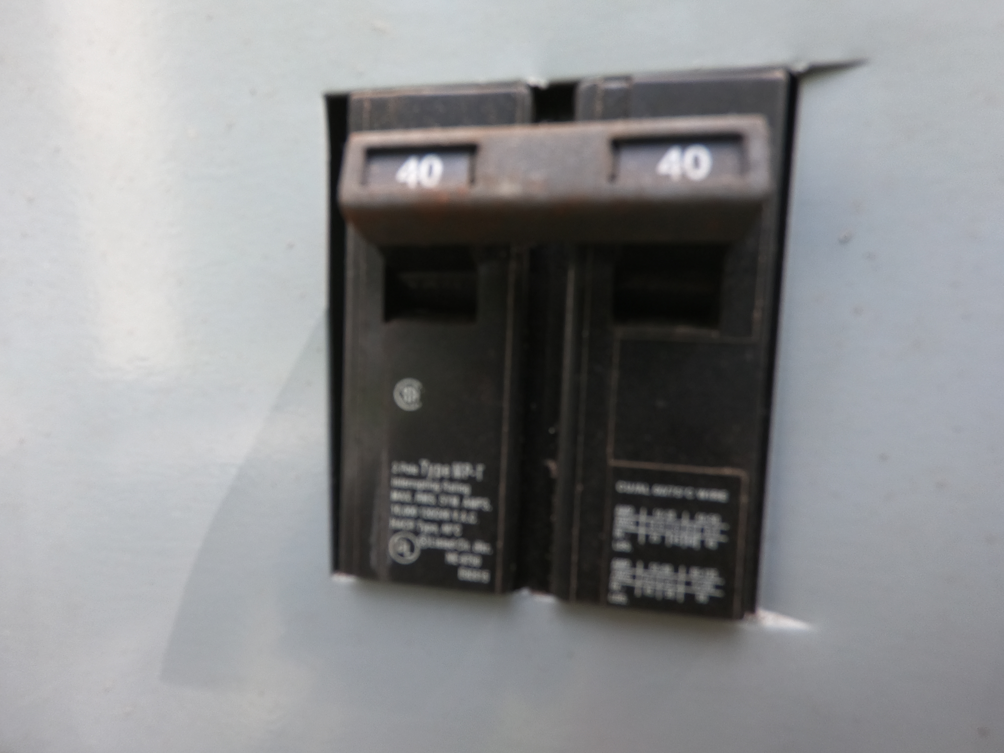

I have a quick question about the overcurrent protection regarding the condenser unit. The unit outside is listed for 35 amp max. and the breaker at the main panel is a 30 amp breaker. The service switch/ safety switch near the outdoor unit is a 40 amp breaker. Is this correct for the switch to be rated higher than the in-panel breaker? I believe it is since it should only be used as a service switch for repairs/ replacement. I am just looking for confirmation to my initial thoughts.

What you are calling a service switch is simply a disconnect around here. Regardless the lower rated breaker (main panel) will trip first. Rating of the disconnect is insignificant unless it is lower than the breaker in the main panel.

Yes, the lowest rated breaker is the one to pay attention to. Sometimes the difference in breaker ratings is due to the exterior coil being changed out because of age related failure.
