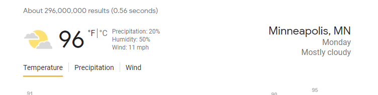

Can you southerners please keep that heat down there? Us Minnesotans are still carrying our winter “insulation” and we can’t handle this 100 degree crap.
