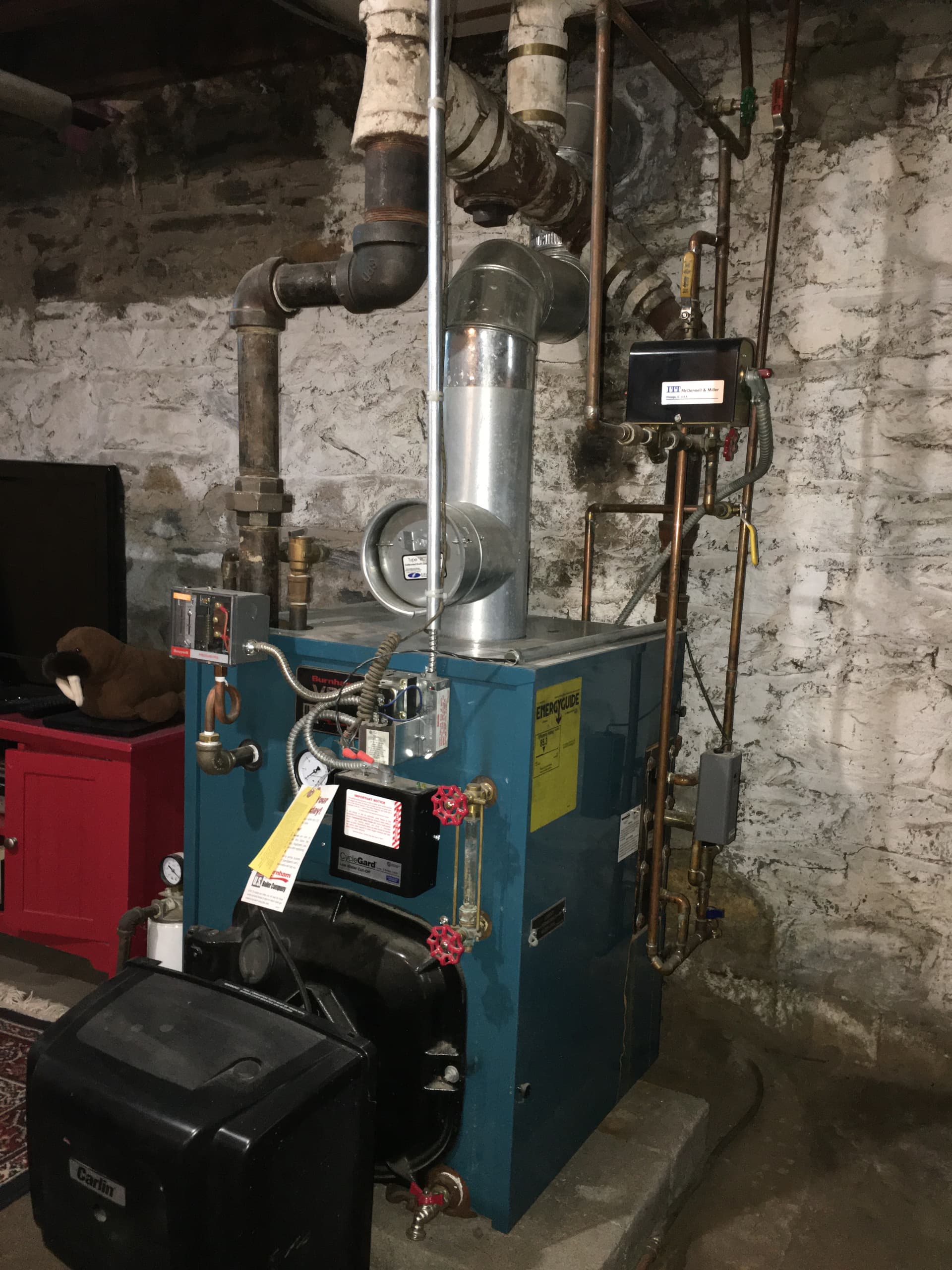

I’m taking the InterNACHI course and trying to identify my HVAC system. Could someone take a look at the photo and tell me if I’m correct?
Based on the label, it is a Burnham V8H boiler, oil, with a cast iron heat exchanger, low-temperature. I assume it has a tankless water heater because there are a couple copper pipes coming out of it and no water heater that I can see (nor an expansion tank). I also assume it’s gravity feed because it has 2 huge cast iron pipes, and it doesn’t look like there is a pump. But I can’t figure out the pipe arrangement. The radiators only have one pipe going into each of them with an adjustable valve. Does that mean it’s a one-pipe system? Is there anything else that is obvious about this system from the photo that you would put in a report?
The sight glass helps you know it is a steam system. And, I would put the potential ACM in the report.
And, the expansion tank is probably in the attic.
Google this and it should tell you everything you need to know.
It is a STEAM Boiler System.
Sight glass, pigtail, single pipe=steam system
What is ACM?
Asbestos Containing Material
