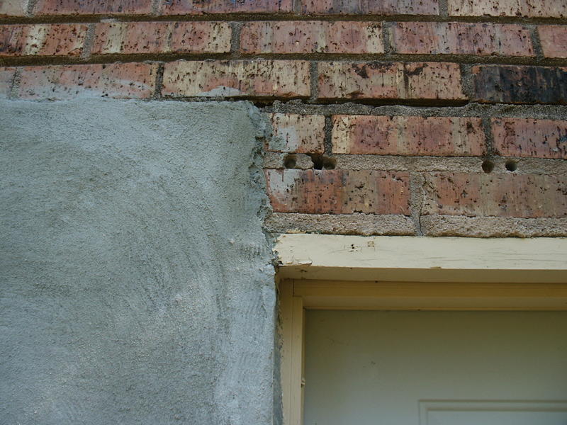

Also as Marcel mentions, the full height parge coat in the crawlspace is suspicious. If it was installed to hide a crack… the movement causing cracking appears to be continuing, since the page coat is cracked.
I’d be surprised if that parge coat was installed originally. People don’t usually spend money when they don’t have to and parge coats are usually installed either to protect material which weathers easily (not usually a problem in the crawlspace), to stabilize surface deterioration of old brick (is this covering concrete block foundation?) or to hide an ugly condition.

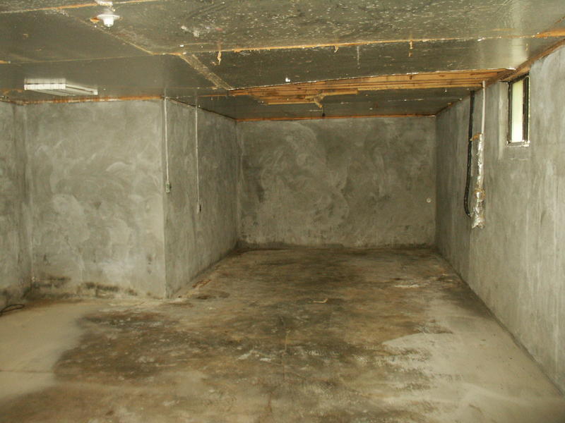

That makes a lot of sense thank you for the help. The picture that your worried about is not a crawl space, it is actually under the back porch, you can see it in the picture of the back of the house. I attached another picture of it.The home does have a basement and the walls are fine, but the floor seems to have a crack (note picture). The basement walls are cinder block, so the house maybe cinder block behind the brick, is that possible? Also, I attached the cement deck in the back. Notice the erosion under the deck and the rotten wood steps that need replacing. When it rains here, it can really down pour. It doesn’t really freeze in this part of the country, but I am sure once in awhile it may.
The best view to see what maybe under the parge, is the picture of the bricks above the header of the basement door. The bricks seem a little old. I was told the house was built in 1983, but I have a feeling that it maybe a little older.

Just do your best to keep exterior runoff away form the foundation. It looks like the basement floor and lower sections of some basement walls are discolored. Makes me wonder if there’s a high water table. If that’s the case you might investigate installation of a sump pump in a pit.
