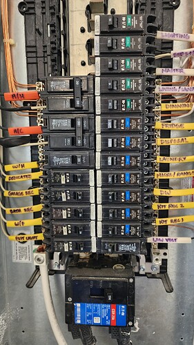

I inspected this new panel a few days ago.
I see this the below all the time. Granted a lot of the older ones fail to trip, but the latest ones make it super simple. Anything built after about 2018 looks something like this.
Yep. Yes. Correct.
Just a side note, the multiple cables into the top of the panel through the large knockout is incorrect. The cables should be secured to the panel with cable clamps.

Is there a limit as to how many cables can be installed per cable clamp? Do you have the NEC # by chance?

I think I found it…
312.5 Cabinets, Cutout Boxes, and Meter Socket Enclosures
Conductors entering enclosures within the scope of this article shall be protected from abrasion and shall comply with 312.5(A) through (C).
(C) Cables](Chapter 3 Wiring Methods and Materials: Wiring Methods and Materials, Florida Electrical Code 2020 | UpCodes)
Where cable is used, each cable shall be secured to the cabinet, cutout box, or meter socket enclosure.
Exception No. 1: Cables with entirely nonmetallic sheaths shall be permitted to enter the top of a surface-mounted enclosure through one or more nonflexible raceways not less than 450 mm (18 in.) and not more than 3.0 m (10 ft) in length, provided all of the following conditions are met:
  1. Each cable is fastened within 300 mm (12 in.), measured along the sheath, of the outer end of the raceway.
  2. The raceway extends directly above the enclosure and does not penetrate a structural ceiling.
  3. A fitting is provided on each end of the raceway to protect the cable(s) from abrasion and the fittings remain accessible after installation.
  4. The raceway is sealed or plugged at the outer end using approved means so as to prevent access to the enclosure through the raceway.
  5. The cable sheath is continuous through the raceway and extends into the enclosure beyond the fitting not less than 6 mm (1/4 in.).
  6. The raceway is fastened at its outer end and at other points in accordance with the applicable article.
  7. Where installed as conduit or tubing, the cable fill does not exceed the amount that would be permitted for complete conduit or tubing systems by Table 1 of Chapter 9 of this Code and all applicable notes thereto. Note 2 to the tables in Chapter 9 does not apply to this condition.
Informational Note: See Table 1 in Chapter 9, including Note 9, for allowable cable fill in circular raceways. See 310.15(C)(1) for required ampacity reductions for multiple cables installed in a common raceway.
Exception No. 2: Single conductors and multiconductor cables shall be permitted to enter enclosures in accordance with 392.46(A) or (B).

Dave, the clamps will be listed for the number and sizes of cables they can be used for. A typical 2 screw NM connector is typically good for 2 flat cables or one round cable. An SE connector is for one. Something like the black button NM connectors have similar listings as the 2 screw. The manufacturer website should have the information or on the packaging.
There is a new connector called the Wire Waffle that has individual clamps for multiple cables in a large KO.
