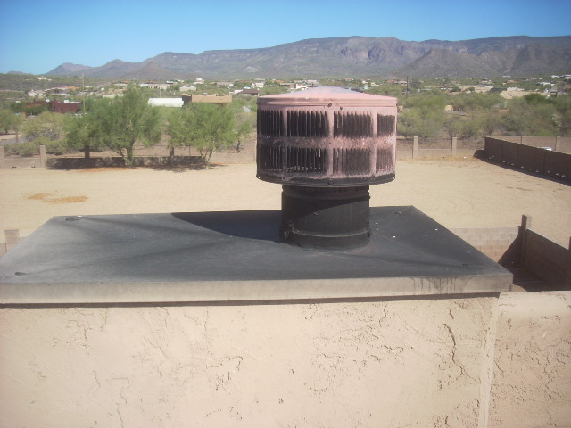

How Hot
does it have to be to cook the firebrick???:frowning:

4 year old fireplace:shock:
Might not have been firebrick, but even firebrick eventually breaks down.
Is it one of those prefab firebrick backers that only looks like brick? I have seen them crack before as well. I think throwing the wood against the back of the firebox doesn’t help either.
Put some duct tape on it.
I second the fake backer. I’ve cracked those myself.
Love those big fires…
Tim
if it’s only 4 years old and in death valley, it’s probably not fire Brick,those manufactured units are not really designed for big roaring fires imo,…
It is indeed Refactory Firebrick Liner.
That is how prefabricated fireplaces come.
And, damaged as it is, it is now a defect and a big deal. :wink:

Well, maybe…maybe not. A couple of years ago I inspected a run down 4-plex that had fireplaces with refractory firebrick liners that had completely deteriorated with a couple of them missing altogether. I talked to the manufacturer of the fireplaces and they informed me the refractory bricks were essentially cosmetic and might help radiate a little heat out into the room but were not critical to the operation of the fireplace and the lack of them did not affect the UL listing of the fireplace nor did it affect their warranty.

But then again, I would like to see some documentation that says a UL listed fireplace can be used with out all the components in good working order.

I would not like anyone casualy reading this thread to think that the condition shown, should OK’d by a HI, at least not without further investigation
That is all.:mrgreen:
Don’t take my earlier post wrong, I certainly do write this condition up as a deficiency and recommend replacement or repair but I temper it with the idea that some manufacturers may not view this as a serious defect, others may.
That’s very true…
and it would make it in my report as well, because without the manufacturers manual You have no idea if it is an integral part or a decoration…
