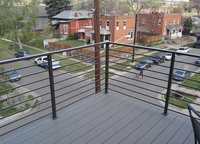

2017 build, 3rd floor exterior deck. Inspected by the city and not in violation of any codes. If I had a small child it would get torn out immediately.

Legal? Who knows and who cares? Maybe someone didn’t like the look of the original one and wanted this one put in for a better view of the neighbors…again who knows and who cares?
Write it up in the report just like anything else…horizontal, climbable balustrades…child may climb and plummet to the earth below …blah, blah, blah.
Buyer’s may not care. Buyer’s may care. If the buyer’s want to find out if it’s “legal”, tell them to contact the local building officials.
Out of your hands…next.
BTW, if you tore it out it would be more unsafe :wink:

I’m fully agree with the assessment, the comment has been made and report submitted. I’m just venting on how this could be allowed as legal…
This is how it was when it passed the city inspection, and there is no code violation.
I’m merely stating that I’m shocked that there is no code to prevent this.

It is code compliant. You can note it as a safety item, but nobody is going to make them change it.

If anybody had real concerns, they would simply attach glass or plexiglas panels. Having it “torn out immediatly” is a fools overeaction to a minor problem.

The climbable horizontal sections can be made moot by adding plexiglass, as Jeffrey stated, or other solid board material, between the posts, or a woven fabric material attached on the top and bottom most inside horizontal rail, from post to post, to impede climbability.
A less expensive fix than starting from scratch, which would be in effect making an ‘Acceptable Solution’ for the guardrails in my opinion, but I am not an AHJ.

R312.1.3 Guard opening limitations. Required guards shall not have openings from the walking surface to the required guard height which allow passage of a sphere 4-in (102 mm) in diameter.
You can call it a safety recommendation if you want, but you can’t mention it is not Code compliant, nor how a client needs to repair it. That is not your purpose here.
