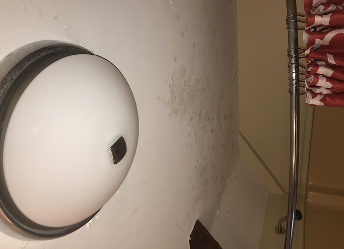

I inspected a bathroom ceiling. I found what looks to be some microbial growth. The paint was peeling away from wood and the wood was a little soft to the touch. This should be repaired before more damage is caused.

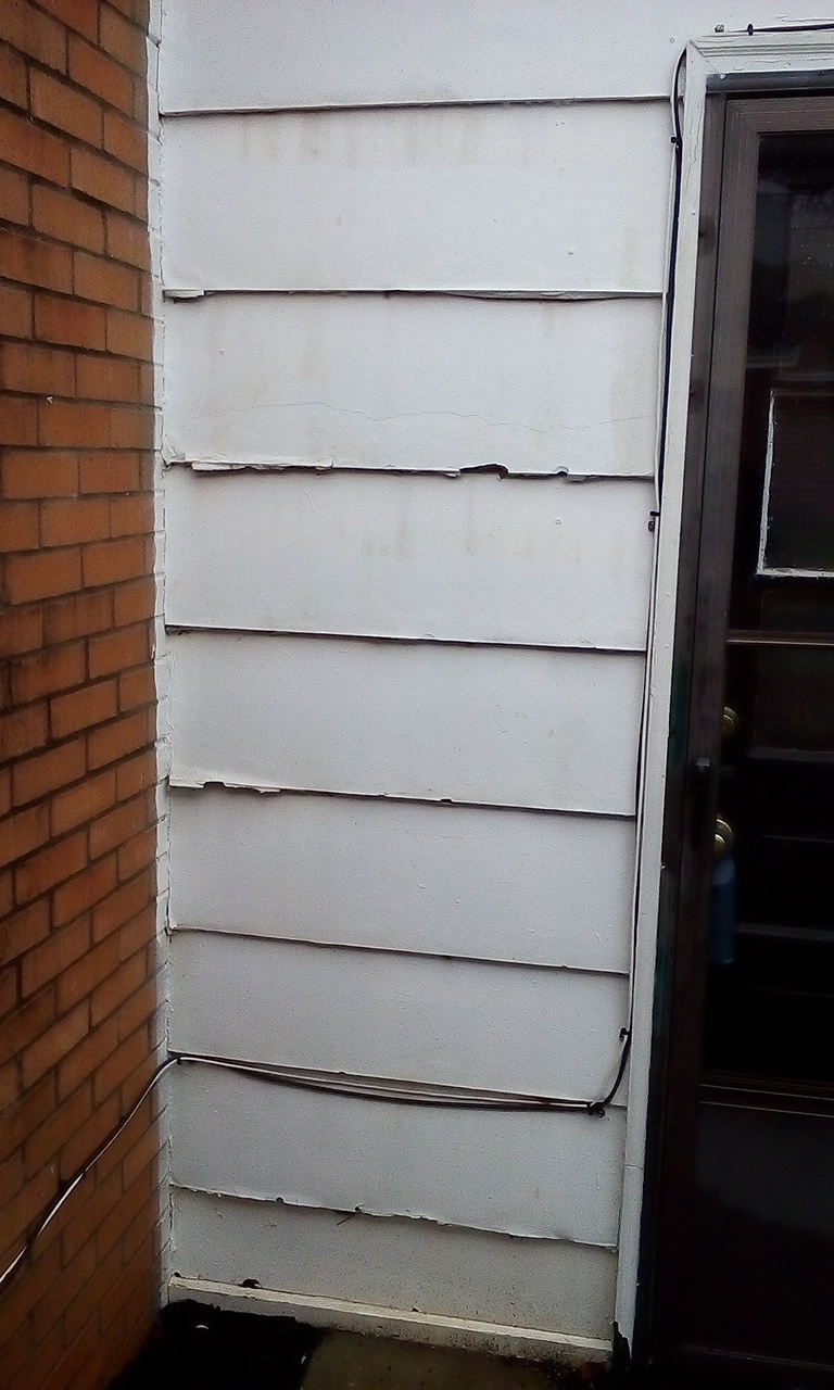

In this picture you can see that several of the composite siding boards are beginning to rot because of moisture. By the time they reach this condition =, painting will not stop the process. They should be replaced.

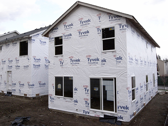

There are many components that factor into the prevention of moisture intrusion into a home. The picture above shows the installation of “house wrap” on a home. These components must be properly installed and in the correct order as a home is built in order to ensure proper moisture control.

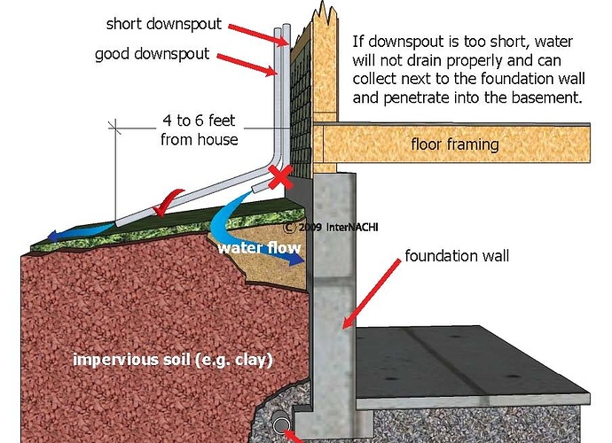

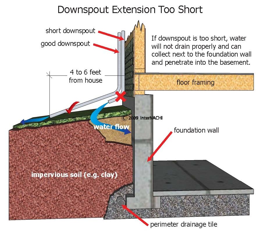

Another important component of handling water and moisture control/intrusion into a home is the gutter and downspout system. The picture above shows a downspout that is not long enough and allows water to empty next to the basement wall. It is important in this situation for an inspector to recommend that the extension be extended even further. The further water is taken from the home and the basement walls, the less likely it is that water will find its way through the basement walls.

The gallery illustration i found demonstrated how downspout extensions may not always be long enough. In the illustration, it shows water coming from and downspout and making its way back against the foundation wall. The picture then showed how a longer extension can keep the water away from the foundation wall and prevent moisture intrusion. I found it to be very helpful.

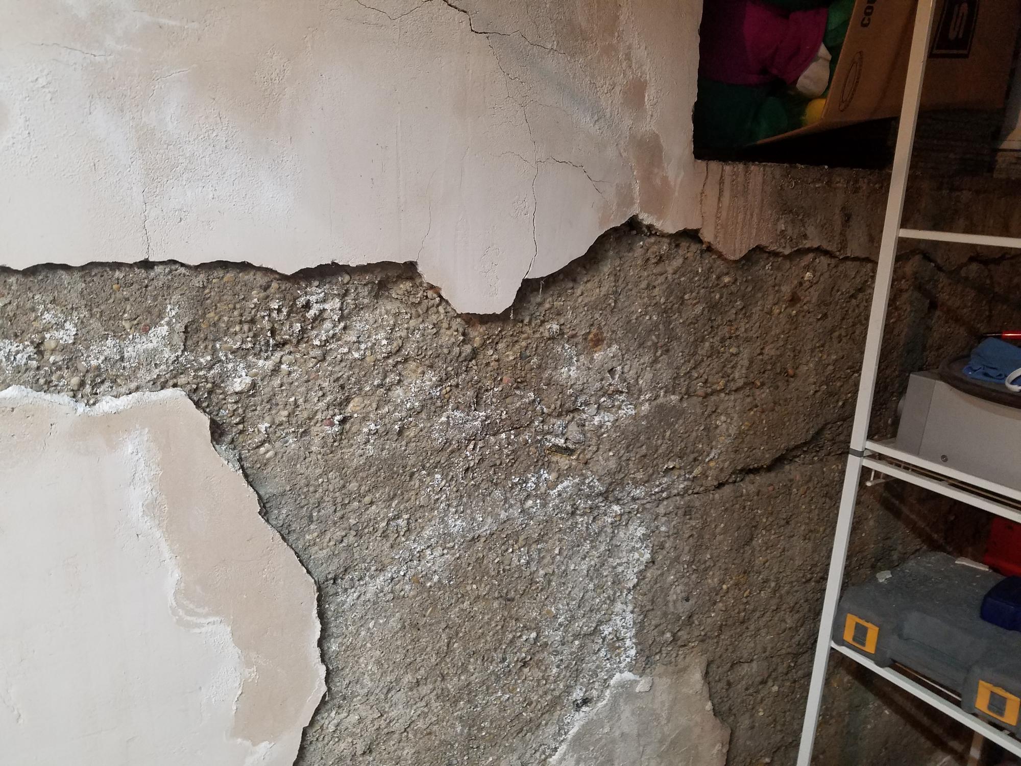

the following picture is of a hip wall in a very old home. this home was built in 1902 with a brick foundation. The hip wall was added sometime later. As you can see there is a significant erosion of the wall covering, which is a plaster. Under this plaster it is revealed that there is accumulation of effervescence. further inspection will indicate that there is a water leak coming from an old filled in coal chute. The coal chute should be sealed up, and the remaining damage cleaned up and inspected for other potential water leaks.
