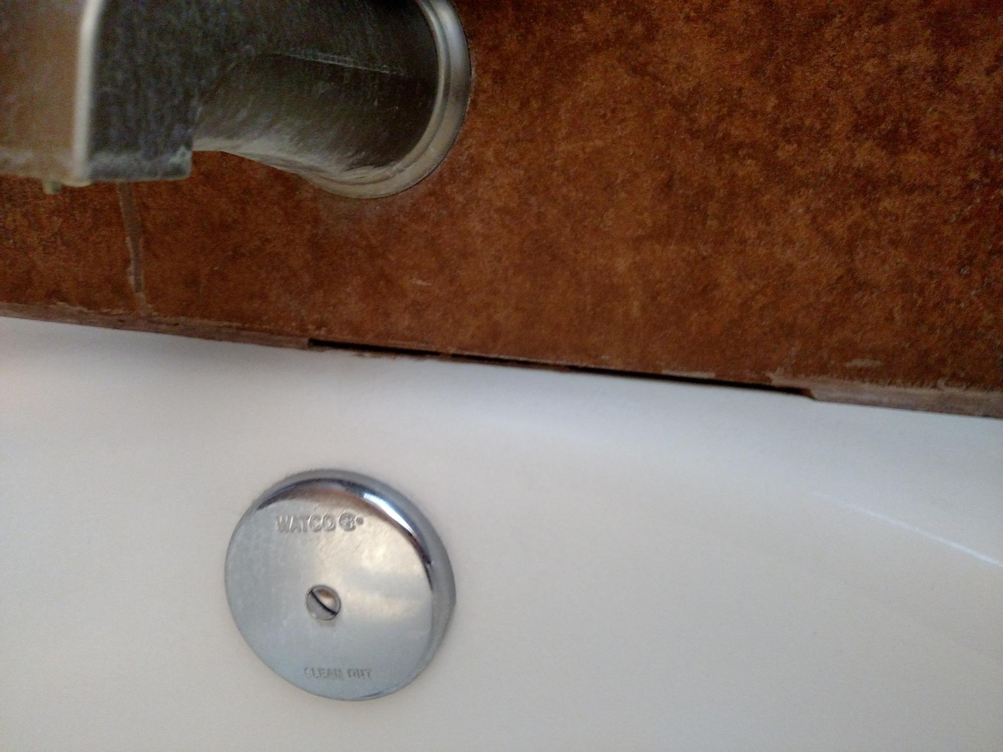

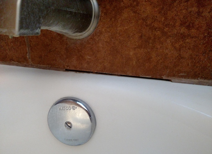

The tub in the upstairs bathroom has an area where the grout is missing between the connection of the tub and tile. Inspection of the wall behind the tub and the floor below with a moisture meter does not show any elevated levels, and there are not any stains indicating previous leaks.
Although there are no current signs of damage, this condition creates a potential for water intrusion into the wall cavity which can cause significant damage. I recommend having this repaired by a licensed professional immediately.

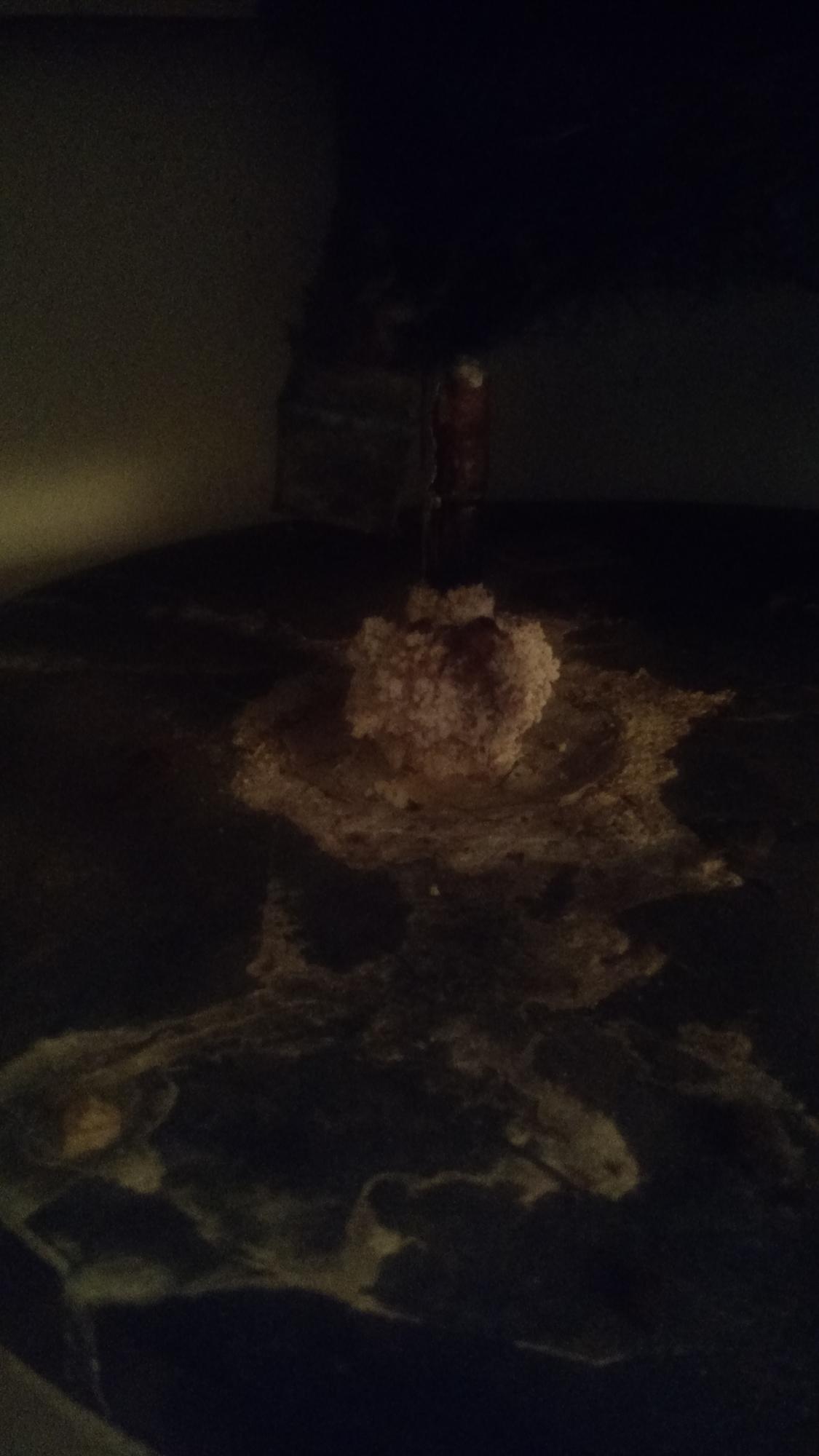

I inspected my hot water tank for any signs of wear, leaks, or moisture intrusion. I found a moderate amount of standing water around the base, as well as a substantial amount of corrosion around the intake/outlet pipes. I will be suggesting to the landlord to hire a plumber to get a closer look.

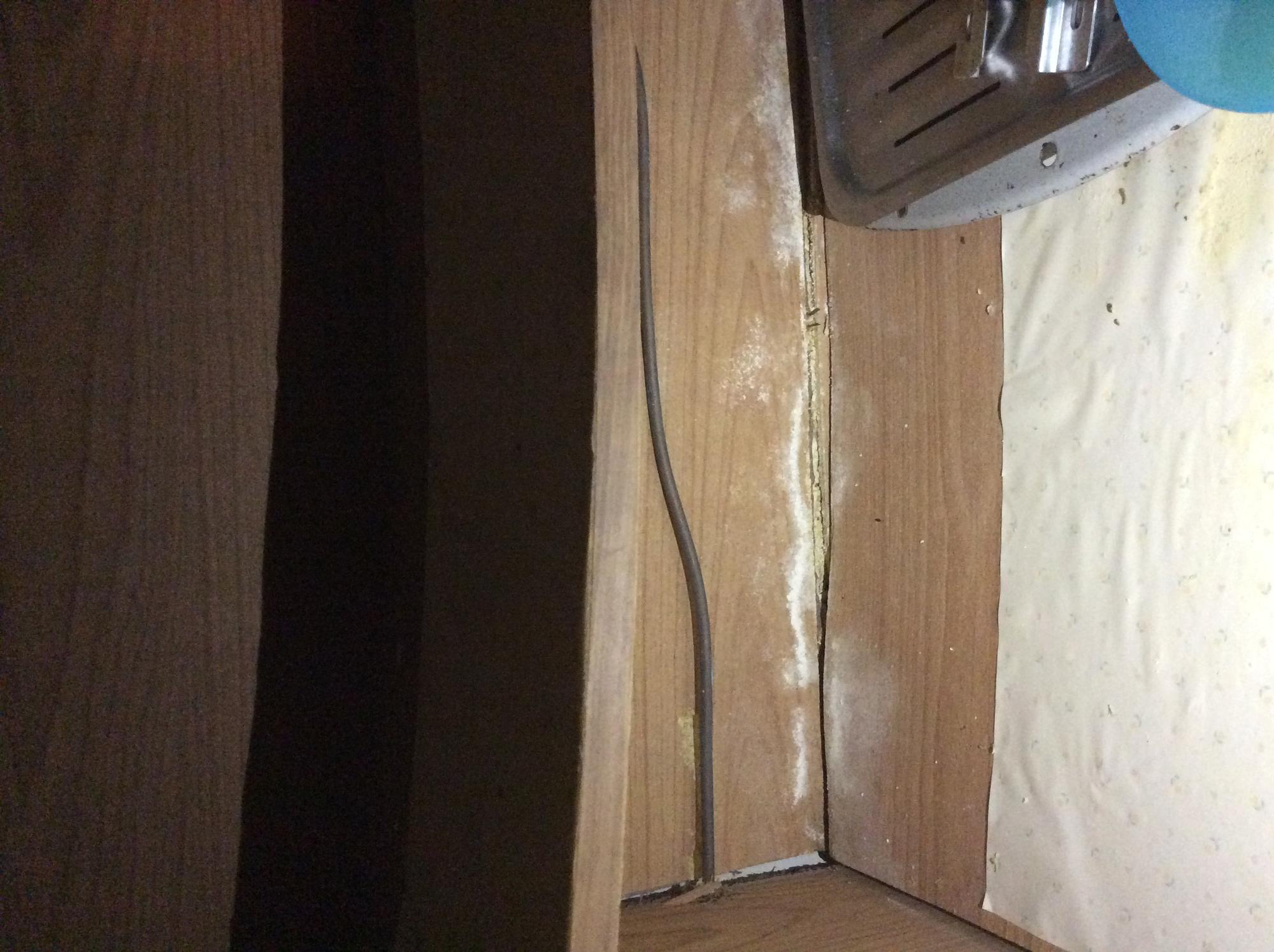

In this inspection, I noted this moisture stain under a kitchen cabinet. Also the cabinet floor is warping and the finish is pealing off. Kitchens are a common site of moisture intrusion.
