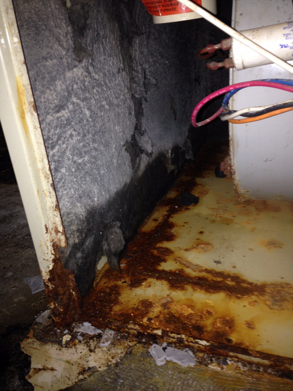

The water damage shown below is from a defective condensate drain on a high efficiency furnace. The extent of the rust would indicate the leakage has been on going for some time. Potential mold issues and reduced efficiency of the furnace may be expected. Further evaluation of the furnace by a qualified technician is recommended. Quite likely, the technician will advise furnace replacement. This condition qualifies as a material defect.
