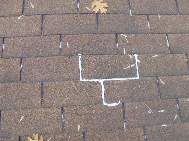

In this picture, an improper attempt at repairing a roof leak by using what appeared to be a latex based caulking was evident. There were several areas of attempted repair similar to this one at other sections of the roof. The shingles were old and needed replacement at the time of the inspection.

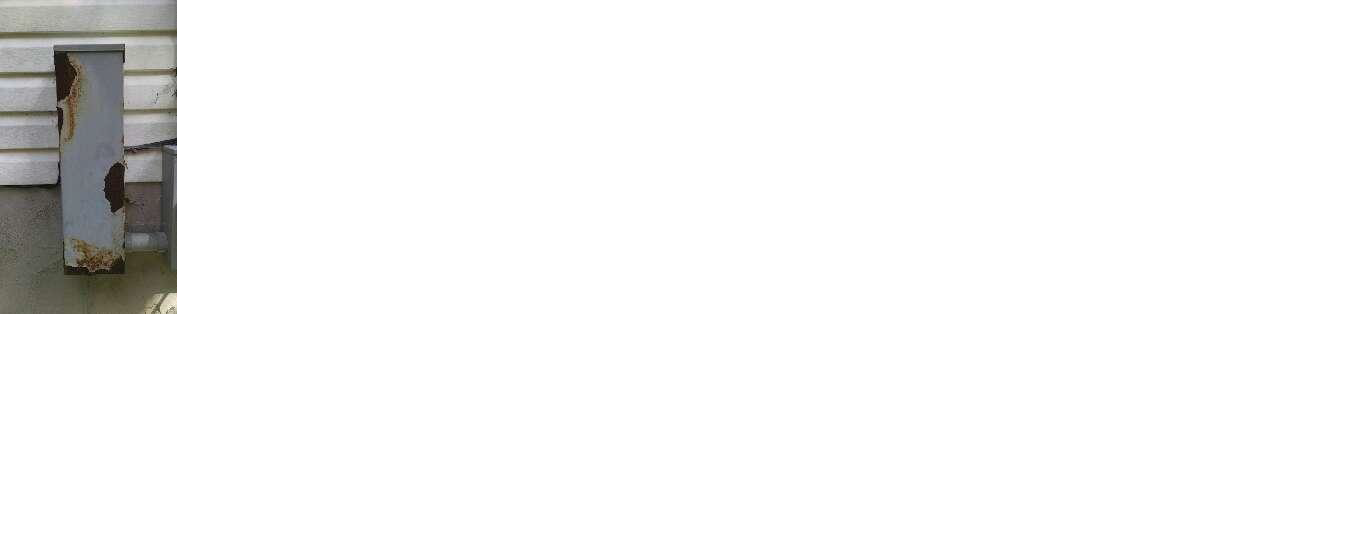

The Main Service Panel acts as the entry point of the electrical service from the power company to the residence, and serves as central distribution point to subpanels inside the residence. Also it acts as a central disconnect in the event of malfunctions, and to prevent serious injury to occupants, and damage to residence systems. The Main Service panel shows excessive moisture related damage (rust), which is an indication of prolonged exposure to either direct moisture, or a compromised outer covering. At the main service panel, high voltage is present, and presents a danger to anybody touching the box either on purpose, or inadvertently. The compromised (rusted) cover, and outer shell, of the main service panel, presents an electric shock hazard from the main (high voltage) service panel, has the ability to cause serious personal injury, or death. Have a licensed electrical contractor evaluate and determine repairs, or replacements immediately.

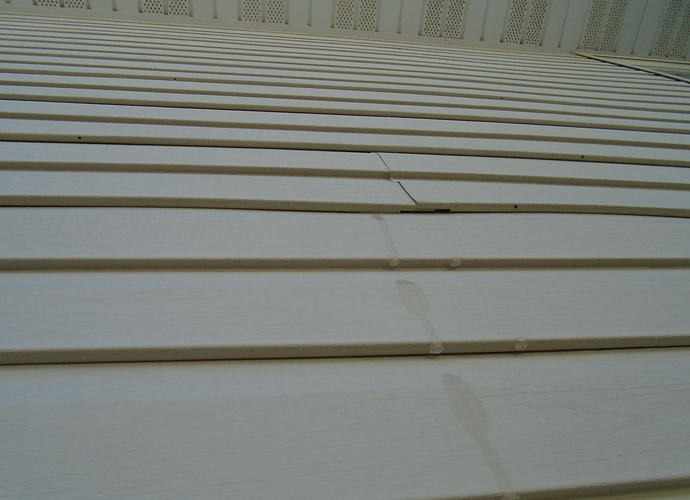

This home was missing its moisture retarder wrap under the vinyl siding. Since vinyl siding isn’t waterproof and lets some moisture behind it from weather, the wall sheathing holding the siding on the house may fail prematurely. This may become evident over time by wavy walls caused from the swelling of the wall sheathing, and sagging siding. If the siding loosing its solid nailing surface from sheathing delamination, the siding could detach from the wall. The internal wall structure, and insulation could become damp from moisture transfer and cause structural damage and mold.

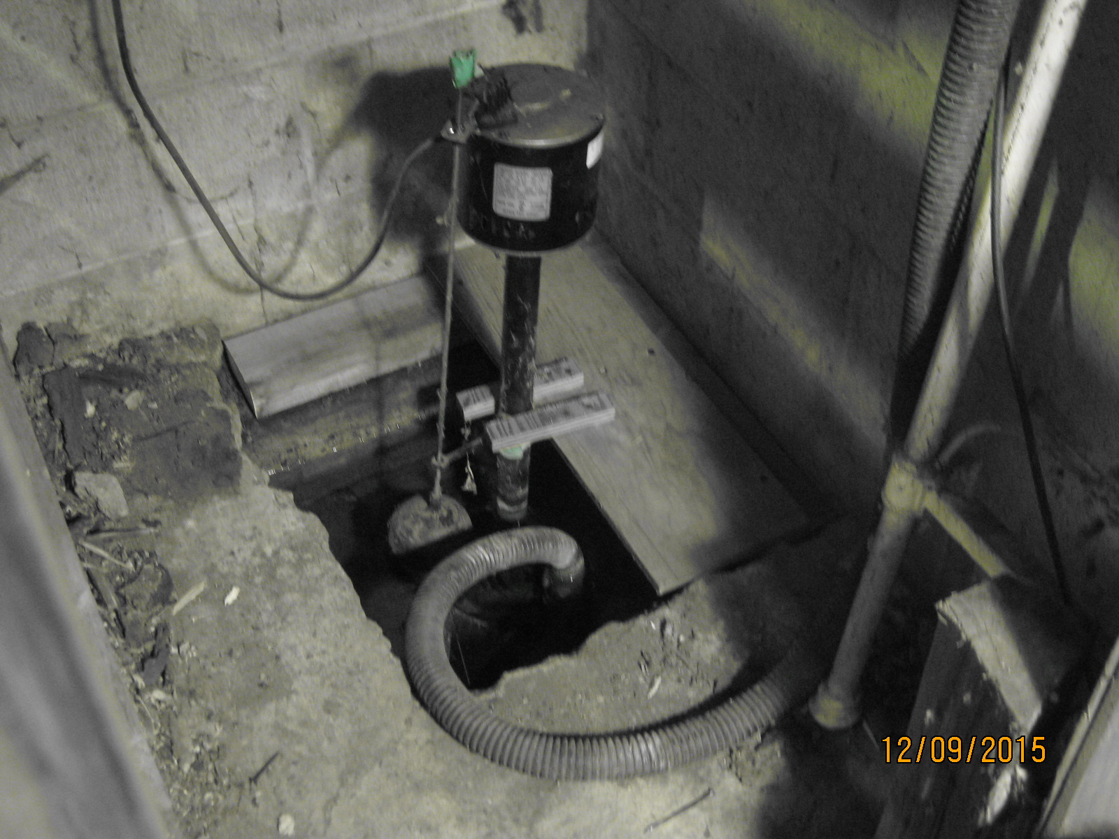

The following is a picture of a sump pump installed in the basement.
Background: The inspection was conducted in an older home. The home owner stated that the French drain no longer was operational, and once the basement had flooded. With about one foot of water. Instead of replacing the entire drainage system, which would had cost about 30K, he instead installed a sump pump. The excess water is drained to the outside via a pipe.
At time of inspection, the basement floor was dry however, the humidity level seemed high.
Recommendations:
1)Install at battery pack which would provide power to the pump in case of a power outage.
2) have an extra stand-by pump just in case the existing pump fails.
3) Install an alarm which would sound in situations where water begins to floor the basement floor.
4) monitor that the pump is operational.

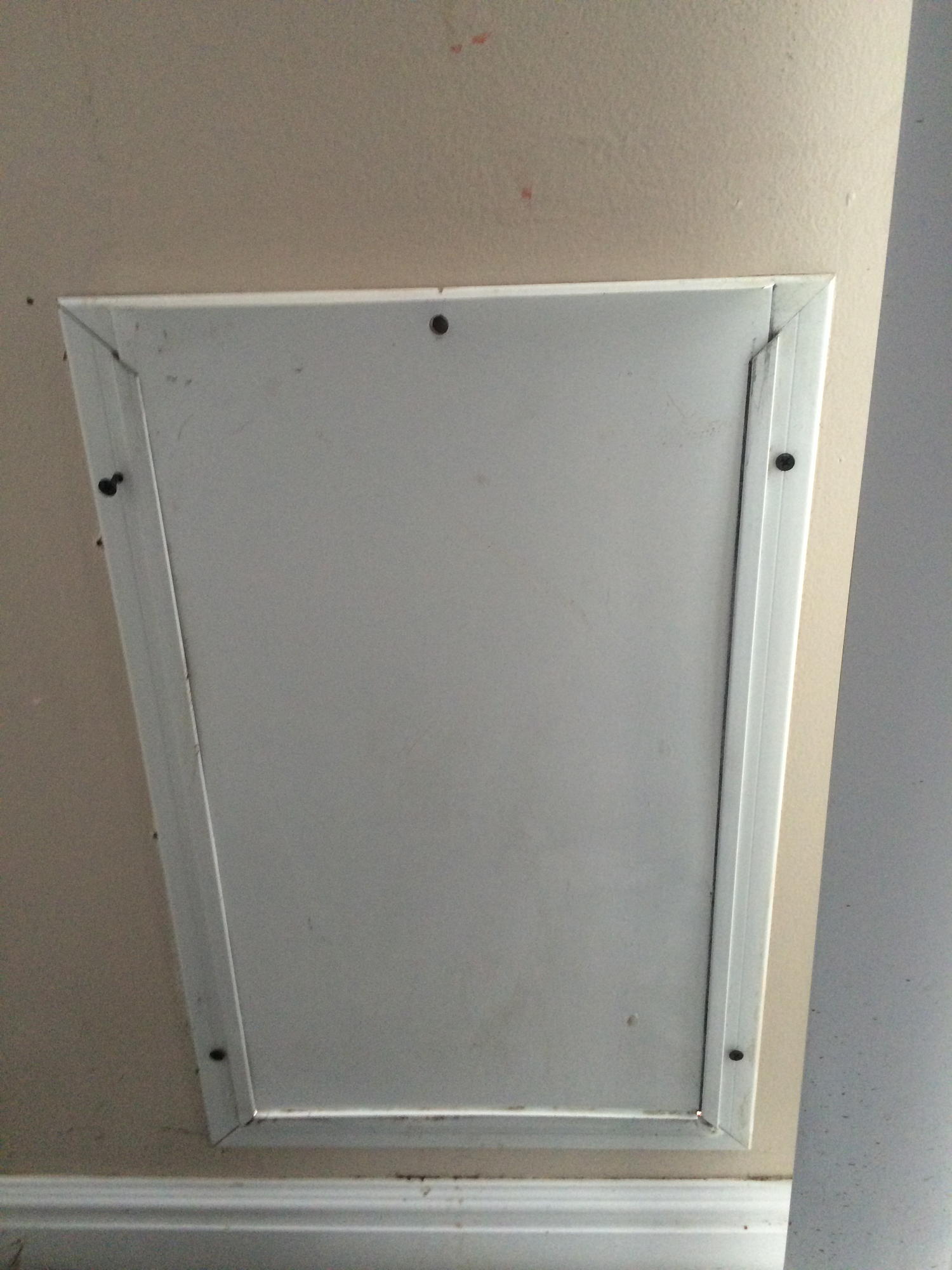

The factory made dog door is in need of repair or replacement or removed and wall properly repaired. The unit is missing both insulating flaps designed to seal the opening when not in use. Unit has a rigid manufacturer supplied door in place. The door is not insulated and is not designed to retard airflow. Gaps are evident and a strong flow of exterior air into the home was detected.

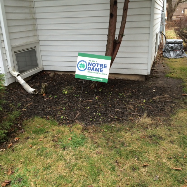

The attached image contains a number of issues that could cause moisture / water intrusion to the basement of this house.
The first is the disconnected downspout extension allowing water to pool at the base of the foundation.
The second issue relates to landscaping affecting the foundation. A negative grade area slopes towards the foundation which can cause water to pool.

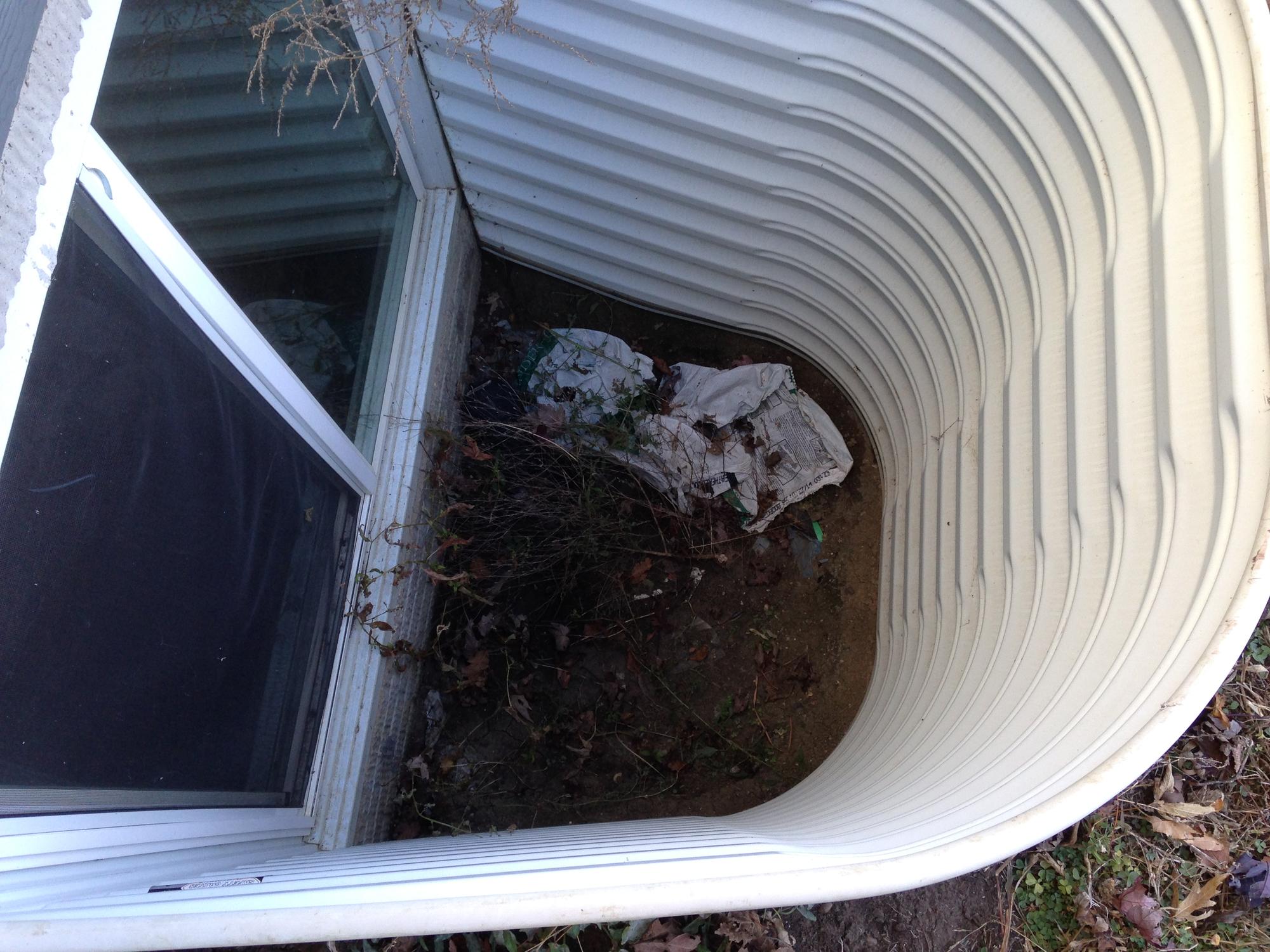

While inspecting the foundation of this home, I noticed this window well contained no rock or gravel, only fill dirt with no drain tile visible. It was also clearly washed out from a rain that came through the night before, creating negative drainage towards the foundation. The carpet directly under this window in the basement was quite damp-about 50% on my meter.
My most recent post showed the effects of an improperly-drained window well, which eventually leaked through the foundation and onto the basement floor. Other issues were present in this house as well. I identified nearly every downspout extension was missing, and drainage paths were easy to spot in the yard. Another strange issue was the fact that the sump pump discharge lacked a hose. It had created a 6" hole in the ground within 24" of the house. All of these issues are 100% preventable.

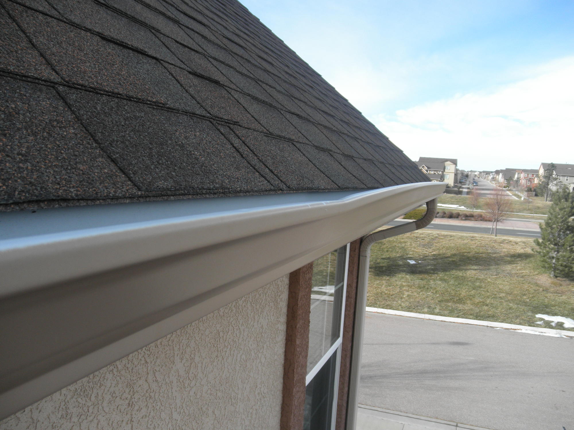

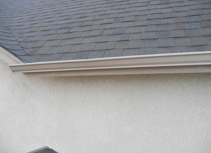

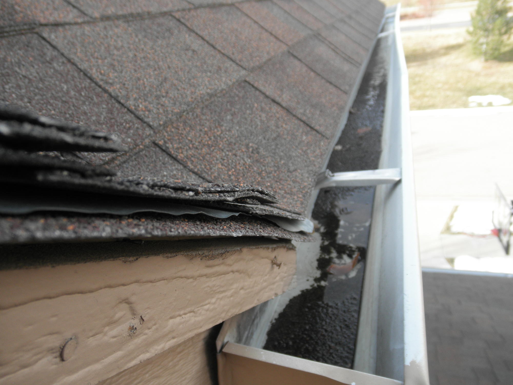

This inspection focuses on an improperly pitched rain gutter installation. This gutter is thirteen feet in length and requires a 1/2" to 1" downward slope toward the downspout for proper drainage. There is average sediment accumulation for an 8 year old roof in the trapped section of the gutter.
There is a well defined watermark line on the inside of the gutter indicating a
2.50" water depth before drainage occurs. This valley on the roof faces the N.E. and snow accumulation is likely to exist for this area posing a potential water intrusion location. Also the flashing on the pitched roof should be on the outside of the wood trim, not behind it. This section of the gutter will require re-positioning for effective drainage. A 1/2" to 1"pitch per 10’ slope is recommended.
