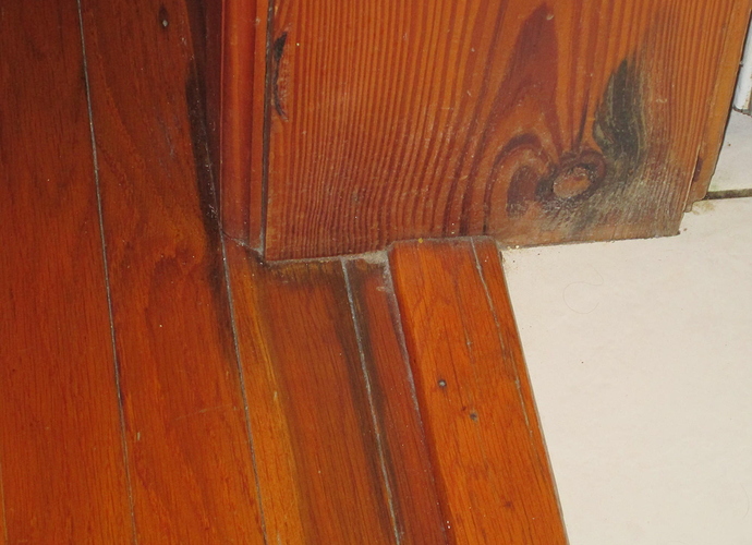

here is a area I noticed that has had some moisture damage. It is a area
located next to a refrigerator ,so I pulled the refrigerator out to see if there was a leak which there wasn’t so it was a older problem
Here is a area I noticed on a wood floor where there seems to be a moisture problem next to a refrigerator it didn’t seem wet so I pulled the refrigerator out and all seemed dry so it must have been a older problem

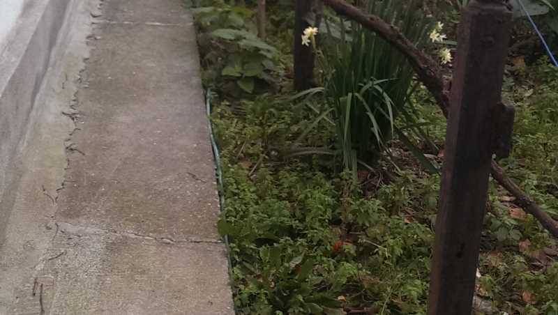

Inspection: Water displacement around building.
The building uses a concrete cap for water diversion away from foundation. This cap is in good condition, although the seal between wall and cap is separated and should be sealed with appropriately rated sealant. There is a slight negative grade towards the building. Grade should be away from building at least 6" over 10’, and swales should be integrated to direct water towards downhill slops away from the building.

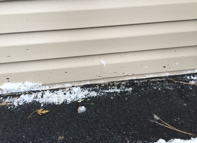

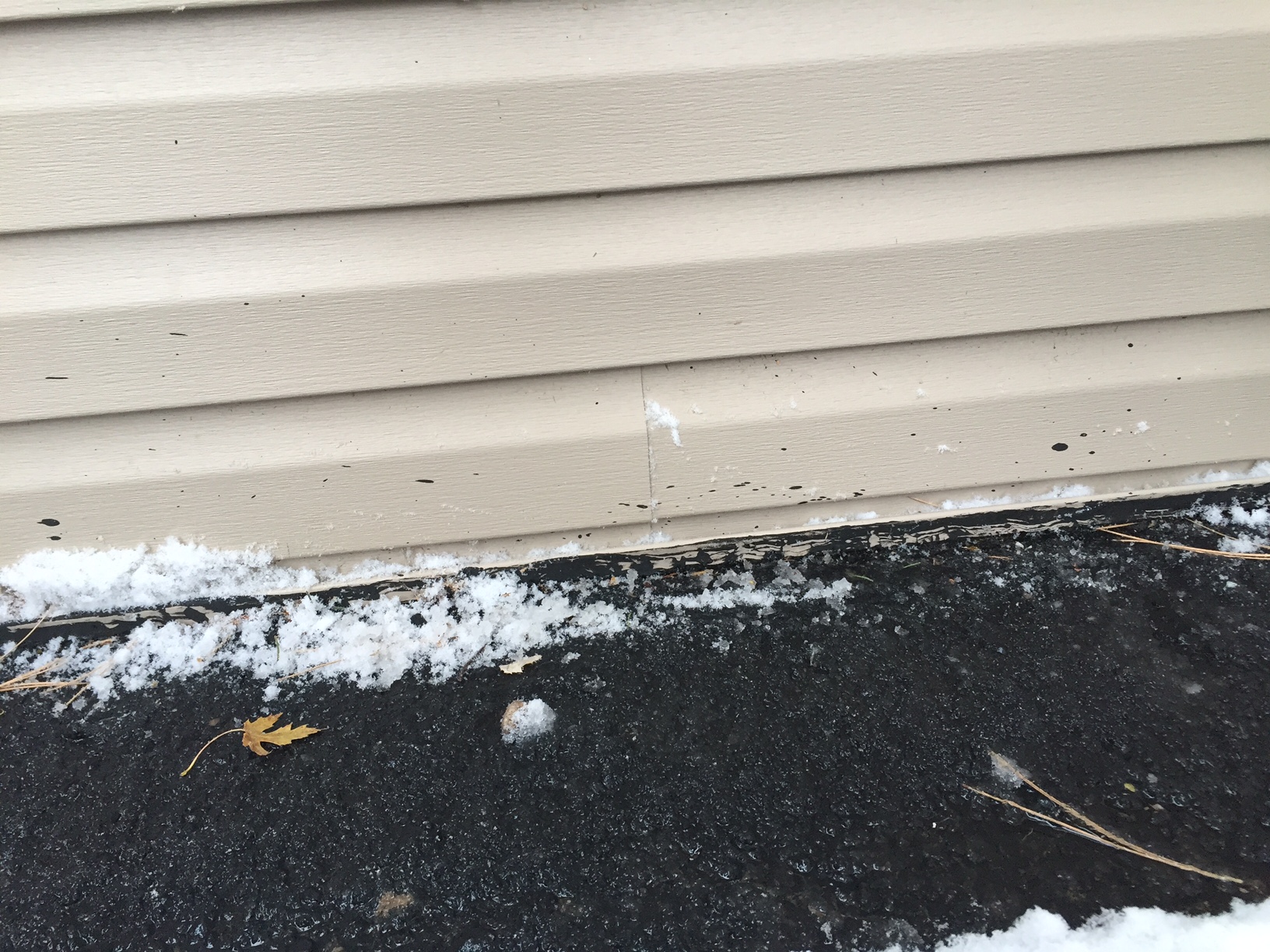

This is one side of a house where to vinyl siding is sitting on the asphalt. The asphalt also has negative drainage towards the house.

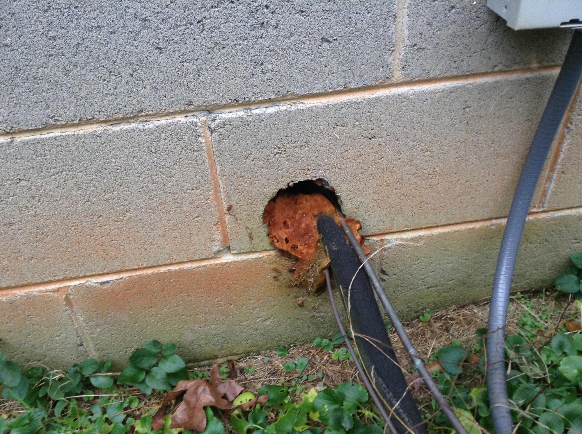

Moisture intrusion. As you can see where the lins set enters the crawl space, the foam is not sufficant. It dose not seal allowing water or even rodents could enter there. The line set insulation is ok though. Recommend repair by a qualified professional. I also not pictured noticed the dryer exhaust ended in the crawl space. This needs to be vented outside and sealed correctly.
