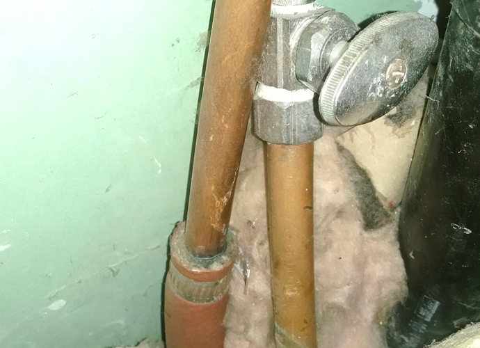

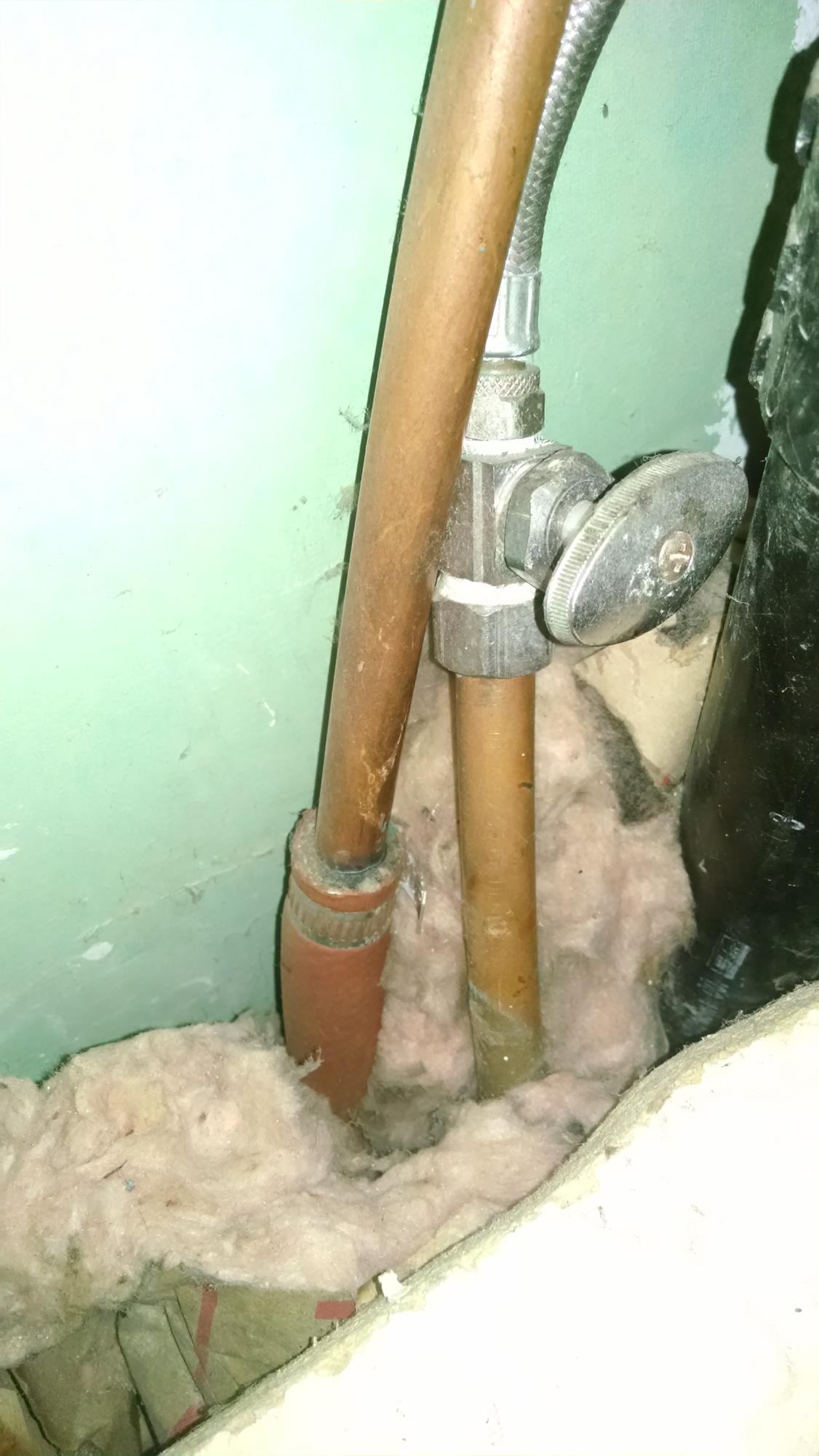

This picture shows a bathroom lavatory sink that has a cold water supply line made of car heater hose and screw hose clamp. It is a guaranteed leak waiting to happen.
There is also no cut off valve on the cold supply line.
The fact that the section of hose is coming up out of the raised platform that the bathroom is on (due to plumbing being above the slab), it is unknown how much of the line is hose and its condition.
Due to the inaccessibility if the hose when a leak occurs it will be difficult to repair and might leak for sometime before being discovered.
It is recommended that a qualified professional inspect and replace with the correct materials.

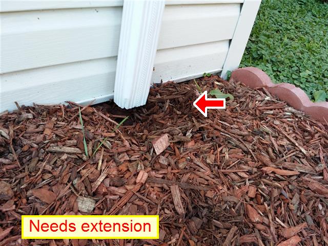

The gutters were bent or damaged in some areas at the time of the inspection. Downspout extensions were missing in several areas as well. This condition can result in excessively high moisture levels in soil at the foundation and can cause damage related to soil/foundation movement. Excessive moisture levels in soil near the foundation can effect the ability of the soil to support the weight of the structure above and can cause damage related to soil/foundation movement. The Inspector recommends repair to help protect the home structure. All work should be performed by a qualified contractor.
One or more gutter sections needed to be re-connected in order to properly control roof run-off. Debris visible in the gutters at the time of the inspection should be removed to encourage proper drainage.

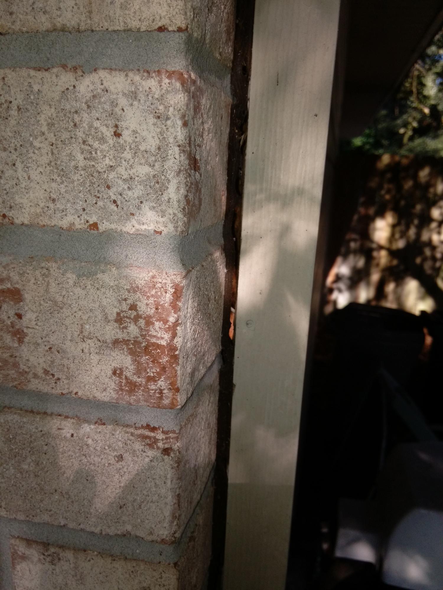

Missing caulking with no signs of moisture intrusion. I would list this as a defect due to the potential for moisture intrusion and pest intrusion. I would recommend further evaluation by a licenced contractor and resealing with new caulking.

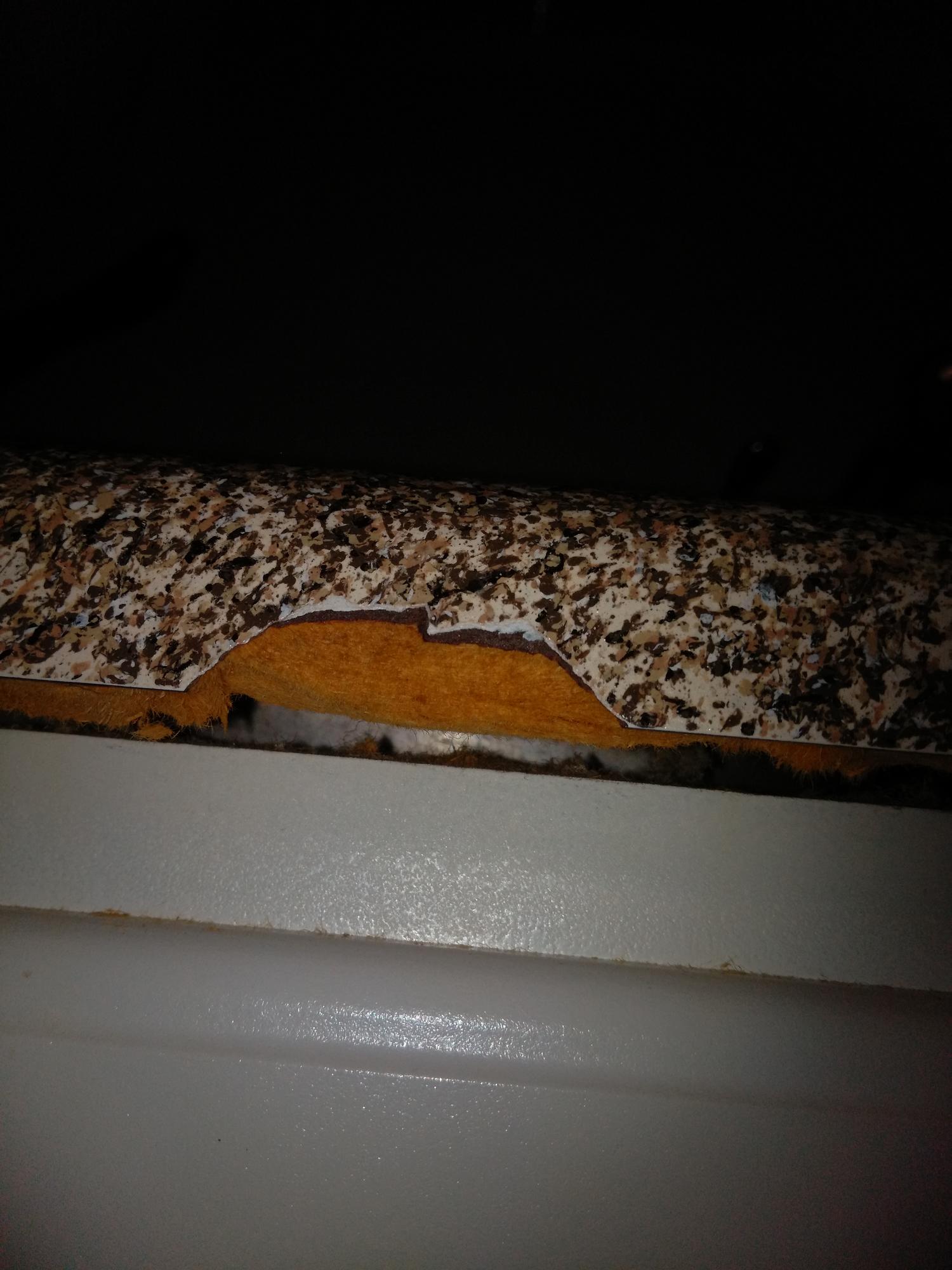

This is an edge of a counter top where it meets the cabinet base. There are signs of old moisture intrusion. It looks as if the old sink was replaced and not the counter. no signs of water damage elsewhere.
