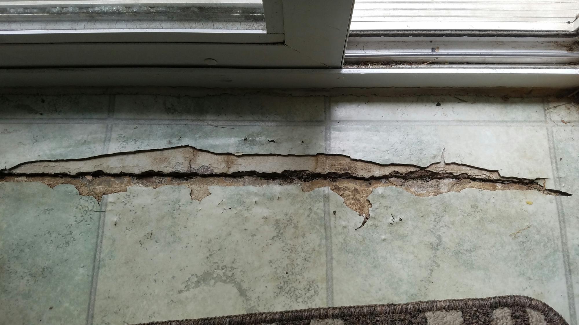

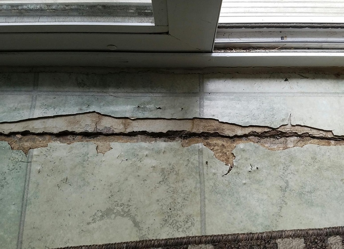

Failed Flooring and Failed Vapor Diffusion for slab on grade:
During a recent inspection of a slab on grade home I found the majority of the vinyl floor covering was lifting. The slab was also damaged, concrete was cracked and chipping. It became apparent that there was inadequate/no insulation and no moisture vapor diffusion. This has resulted in significant damage to the slab and lifting, cracking and tearing of the vinyl floor covering. In light of the damage done to the flooring there is an obvious trip hazard, subsequently a health hazard. I also observed blistered flooring and dark spots indicating moisture intrusion, a potential health hazard in that mold can develop.
The best remedy for this situation is the existing flooring should be removed, repair and seal the concrete with a coat of mastic and cover with vapor barrier of 6 mil poly ethylene. The next step would be to install rigid semi-permeable insulating sheathing between furring and cover with plywood. New flooring can then be installed.

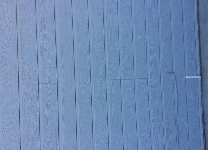

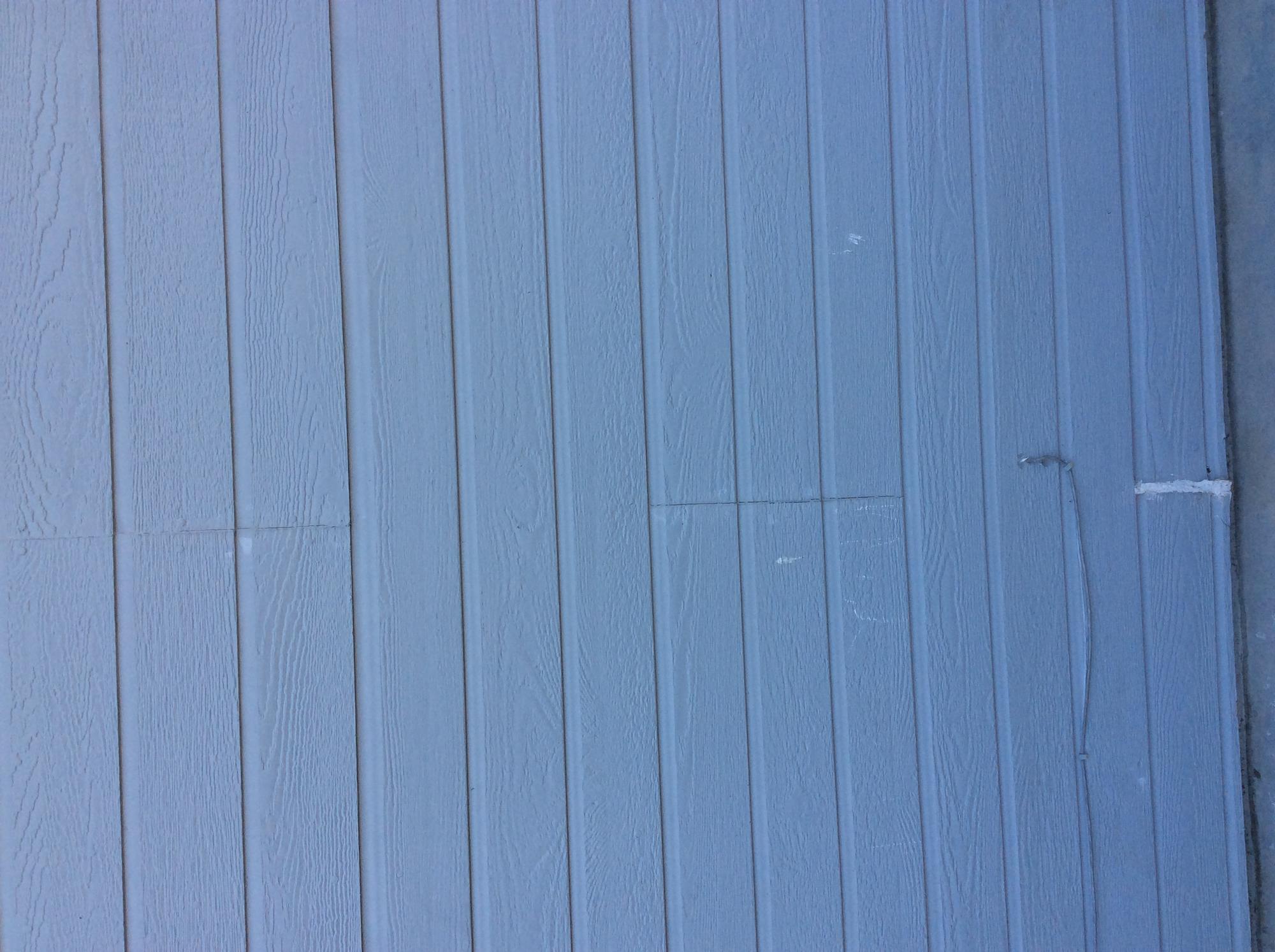

This is a picture of wood siding on a home. As you can see where some of siding meets there are gaps. One gap has been sealed but there are two others that need to be sealed before moisture can affect the siding and possibly the inside structure.

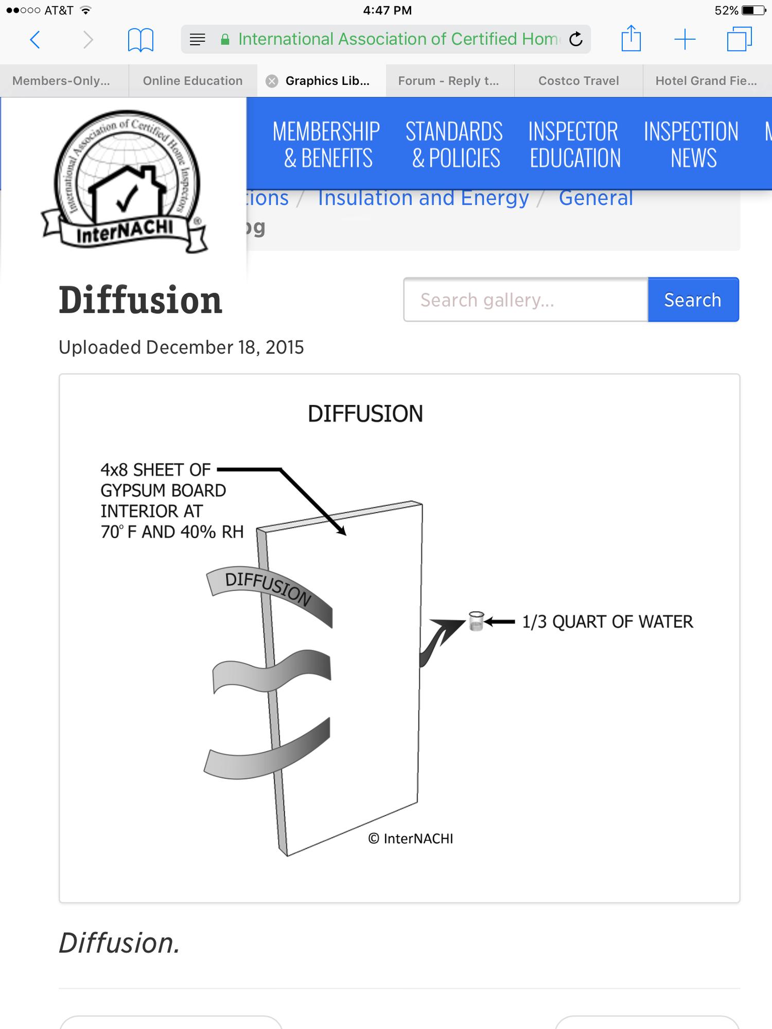

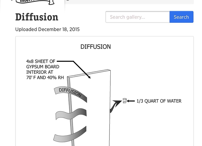

I researched and viewed the illustration of diffusion. Through a 4x8 sheet of gypsum board, with the interior at 70% and 40% RH can produce 1/3 quart of water. With studying this section I can tell how important it is to have some type of vapor barrier depending on where your home is located. Keeping moisture from coming in as well as getting moisture out is important to the overall structure of the home as well as health of people who live there.

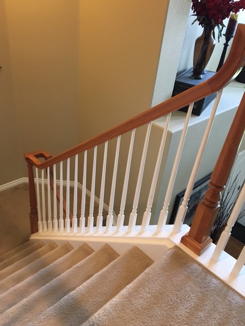

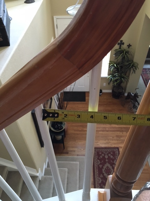

This stair in photo 1 has a bottom run of eight risers to a landing and a top run of eight risers to the upper floor landing. Photo 2 is of the lower floor, wall mounted handrail termination. The top of the handrail is 34 ½” above the nose of the steps. Photo 3 is of the inside handrail at the upper run of the stairs. This handrail is 36” above the stair nosing and it is continuous to the lower handrail with an up easing transition at the landing. Photo 4 is of the 42” tall guardrail at the upper floor hall/landing. The maximum clearance between any two balusters in the stair handrail was 3 ½” and in the upper floor guardrail was 3 ¼”. All hand rails and guard rails are continuous and terminate appropriately into the wall.

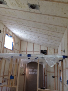

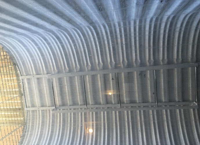

In this course I decided to write on insulation. In this particular case I have used spray foam insulation to insulate my tiny house on wheels. This is a picture of open cell foam sprayed the depth of the stud and rafter bays. I chose open cell foam because I live in the south and moisture needs to dry to the inside of the home since the majority of the year consists of hot humid outdoor weather. I have ¾ inch pine tongue and groove siding on the outside of the home, a vapor diffusion retarder (tyvek), and ½ inch OSB sheathing in respective order. The vapor retarder is recommended on the outside of the structure because of the southern weather conditions. No construction in this climate has a vapor retarder on the inside of the structure. There are also a few requirements for thermal barriers for the spray foam. The walls will not be covered by gypsum. I have to spray the foam with DC315 (or other approved thermal barrier) for the structure to follow code and be safe for inhabitants.
I have one question. If anyone has the knowledge of the permeability of the DC315, I would like to know if this would cause conflicts with moisture drying to the inside of the home.

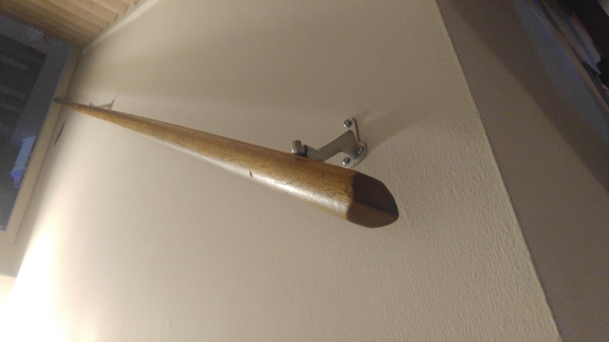

The staircase in the subject property features a handrail that does terminates freely. This is a code violation and a safety hazard. Code dictates that handrail ends shall be returned or shall terminate in newel posts or safety terminals. Recommendation is to have a qualified carpenter construct return handrail to the wall in a manner that is in accordance with local codes.

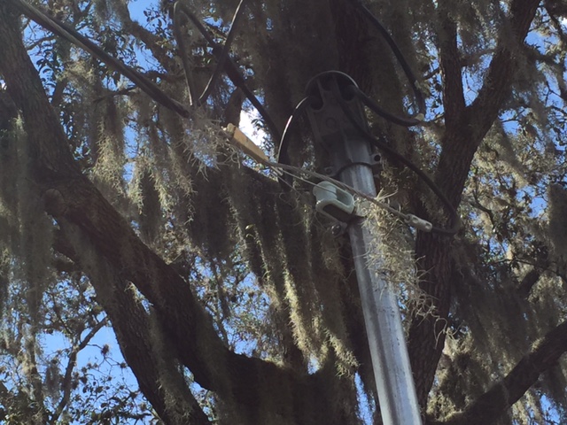

The Service connection from the must be properly supported and be rigged with a drip-loop as shown.

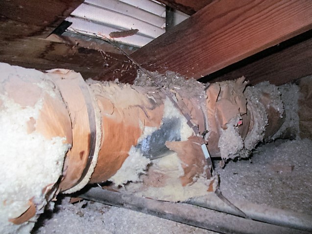

Missing and damaged insulation was observed at the HVAC ducting in the attic space. This condition could allow hot attic air to condense moisture at the cold ducting, causing moisture damage at this area. Moisture staining was observed at the interior ceiling below this area. Improvements and repair should be completed for optimal energy efficiency and to prevent moisture damage.

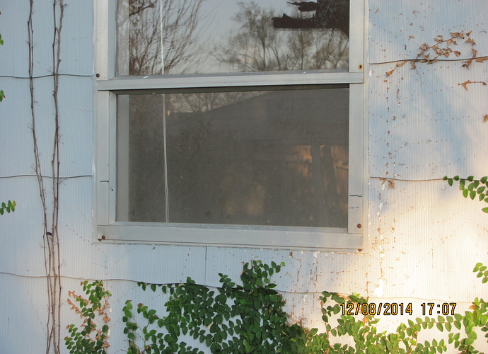

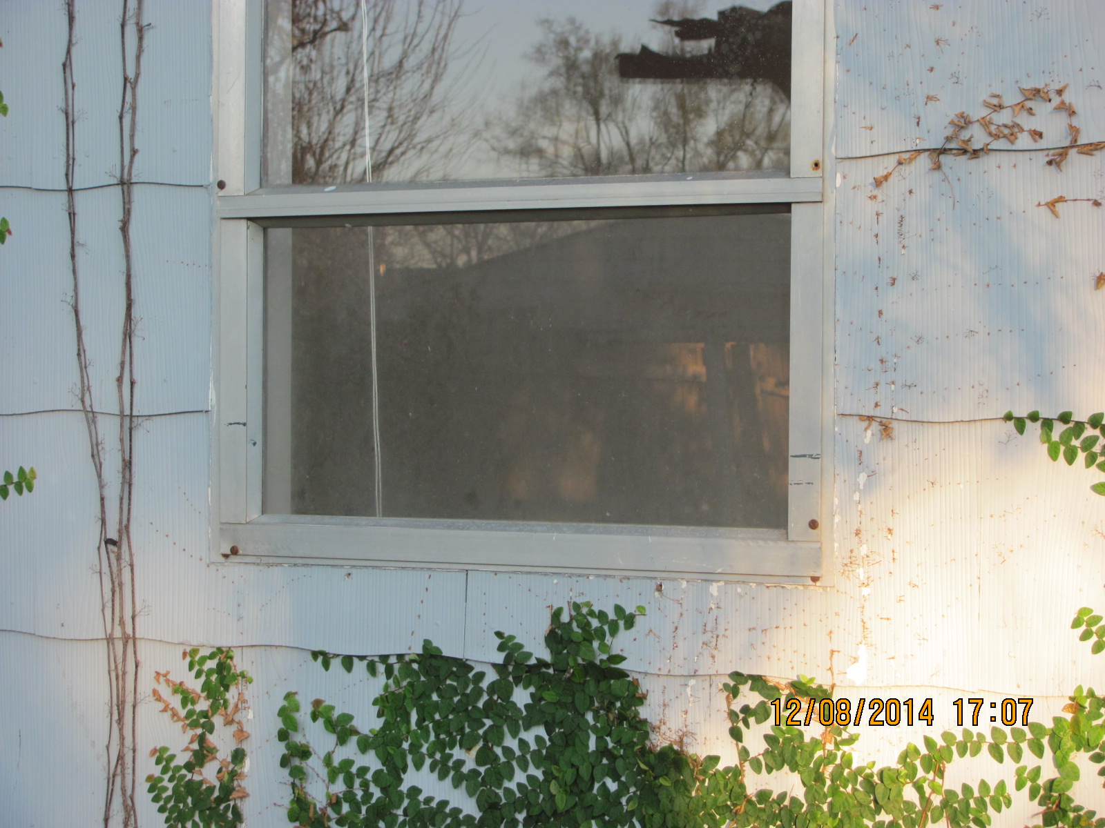

Here’s an old single pane awning window. These are common in my area, and they are usually non-functional in that the hand cranks are worn out, and typically, they are fastened shut with screws or nails. These windows should definitely be replaced for security and energy efficiency.
