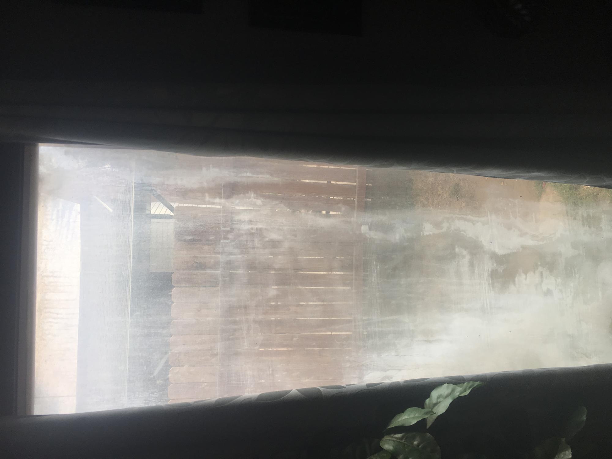

In the office area of this home I found two large windows looking out into the back yard. This window had obvious leakage in the seals resulting in condensation between the glass panes. I recommend replacement.

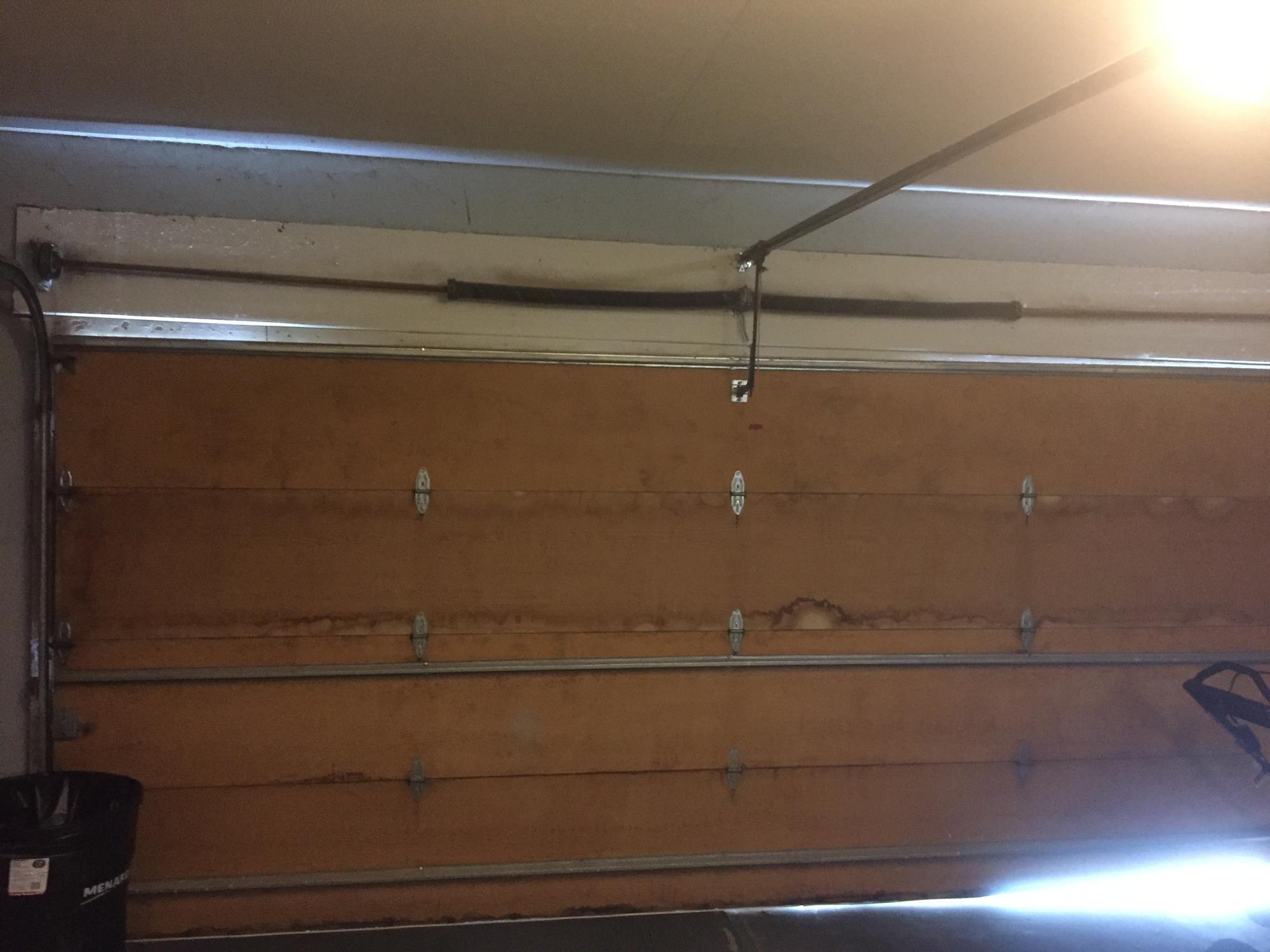

There are a few problems found with this garage door. First, no warning labels were found on or around the door. These warning labels are a good safety feature and should be added. Second, the door panels on the inside show signs of water damage. Third, the garage door on the left side does not close tightly against the garage floor. This could allow precipitation to enter without a proper seal. I would suggest this component to be further inspected by a qualified technician.

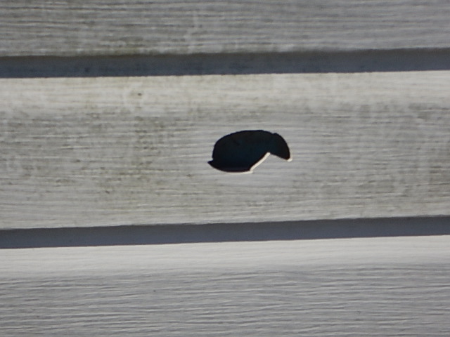

Upon inspecting exterior cladding of a home, cracks and holes were noted in more than one location of the exterior vinyl siding. These holes in siding and around service entry should be sealed with caulk or silicon to make the home more airtight and prevent moisture/pest intrusion into the home. Recommend having qualified contractor evaluate and repair as needed.

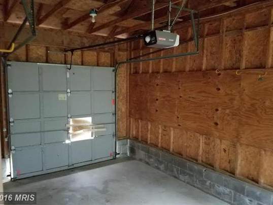

The above garage is fairly typical for this area; a two climate zone area with
long hot summers and short crisp winters. Having a unconditioned garage space
enables for minimal care and concern and little attention to systems and their maintenance. However, this garage has a foundation floor probably a regular slab on grade with a four inch pour and sand and gravel underlay. The garage door appears to be in good condition, ie no visible disconnections, with regular springs on the side. What is not visible but important is whether it has a safety wire inside of the springs. Wiring is the minimal 15amp lamp circuit with one only outlet for small electric tools. Being detached it has no other electrical systems.
Its probably as rustic as a suburban garage gets around here, showing how simplicity can be bare necessity yet as functional and ascestic as any whole house equiped outdoor garage.

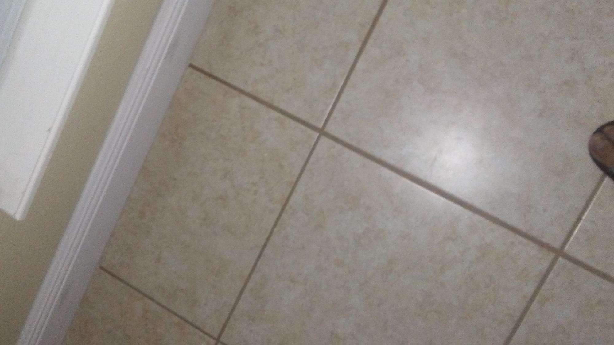

After inspecting the home I noticed that the tile was in great condition, they appear to be brand new. I spoke to the owners of the home and they said that they were only three months old. I also noticed that the baseboards were in great condition, the owners also told me that they were just installed with the tile. Apparently they had carpet throughout the entire home before, nice job I replied

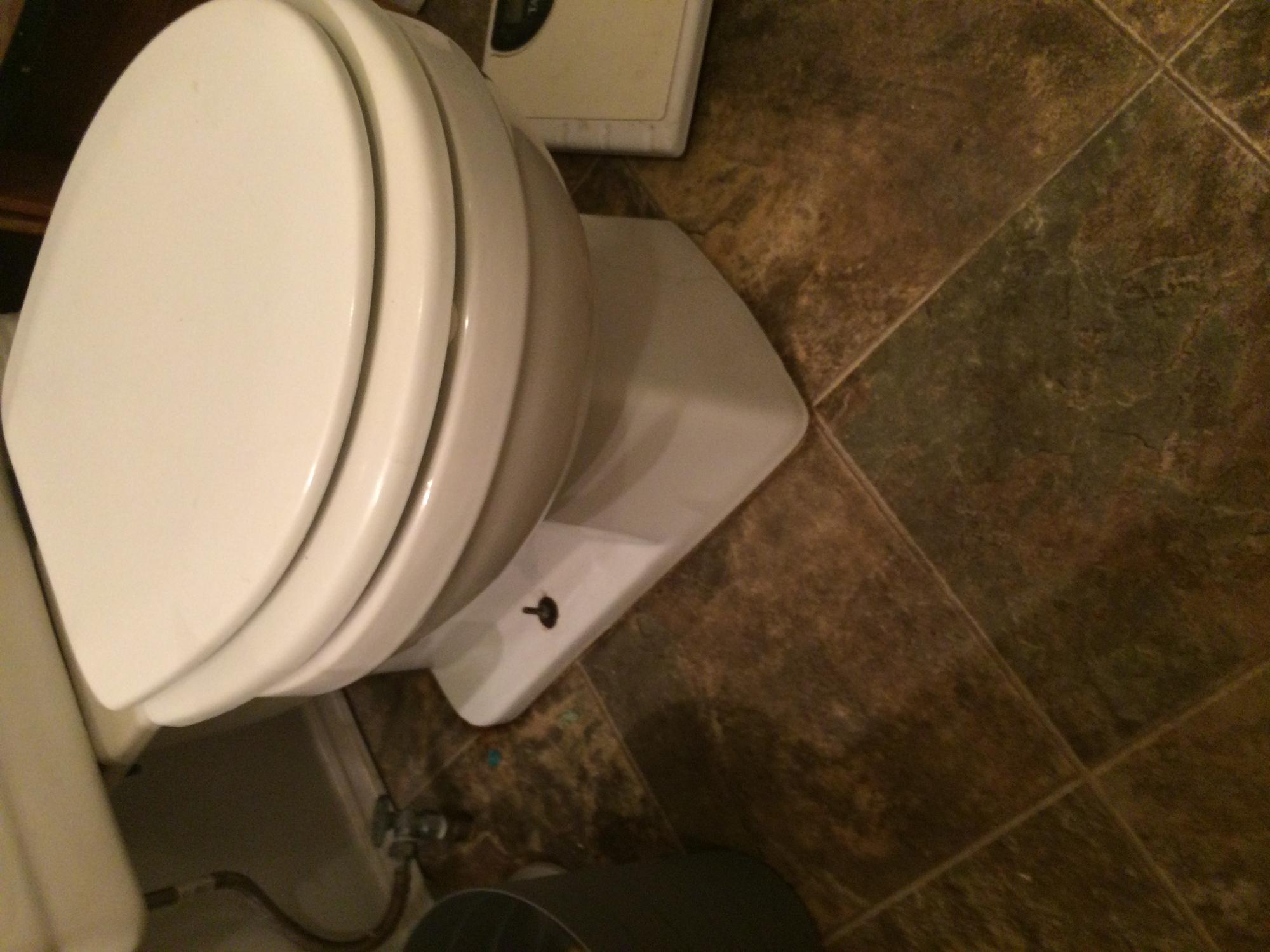

The master bathroom toilet was loose at the base of toilet connected to the floor. This can cause damage to the wax seal. Recommended to wax ring seal and proper fighting of toilet and sealed with some chalking after installed.
