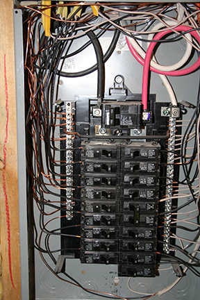

Upon removal of the dead panel there were two double taps and some oversize breakers. One breaker was not seated properly. Recommend electrician inspect and correct as needed.
The main breaker and the panel were labeled 200 amps. There were no markings on any wiring inside the panel box. The main service amperage could not be verified because there were no identifying marks or access to inspect the underground cable insulation.
There was a 40 amp breaker serving #10 awg cu wire and a 20 amp breaker serving a #14 cu wire
This is a 200 amp residential panel. It is a two-phase 240 system, which means that each phase has its own 120 amp bus. The image shows the main shut-off at the top of the panel. The neutral conductor bus is on the right of the breakers; the grounding bus is on the left. No neutrals or grounds share the same bus. There are no double taps. However, there is a neutral conductor going into one side of a 30-amp dual-pole breaker. This needs further investigation.
In this inspection the house had just been upgraded, although the panel appeared to be professionally installed, the romex wires running in the attic ( at scuttle hole and pathway for servicing hvac) and into unfinished utility room (at wall between wall studs and corners) were not properly attached or secured.

The first image shows a main electrical panel. The defect here is that the legend is not clearly provided on an acceptable panel legend form. Breaker identification is written on the panel itself. Also somewhat visible here on the left side is the grounding wires that exit the main panel and terminate outside to a connection on a grounding bar driven into the ground near the meter.
