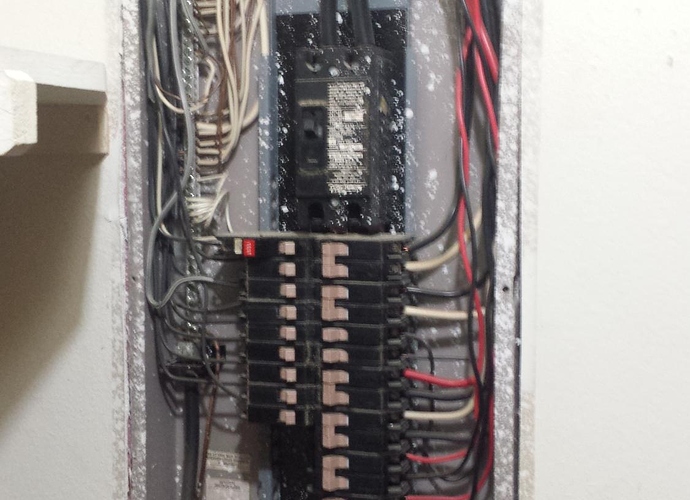

After removing the dead panel I found two double taps and some oversizebreakers as shown. One breaker was not seated properly. Recommend electricianinspect and correct as needed. The main breaker and the panel were labeled 200amps. There were no markings on any wiring inside the panel box. Themain service amperage could not be verified because there were no identifyingmarks or access to the underground cable insulation.

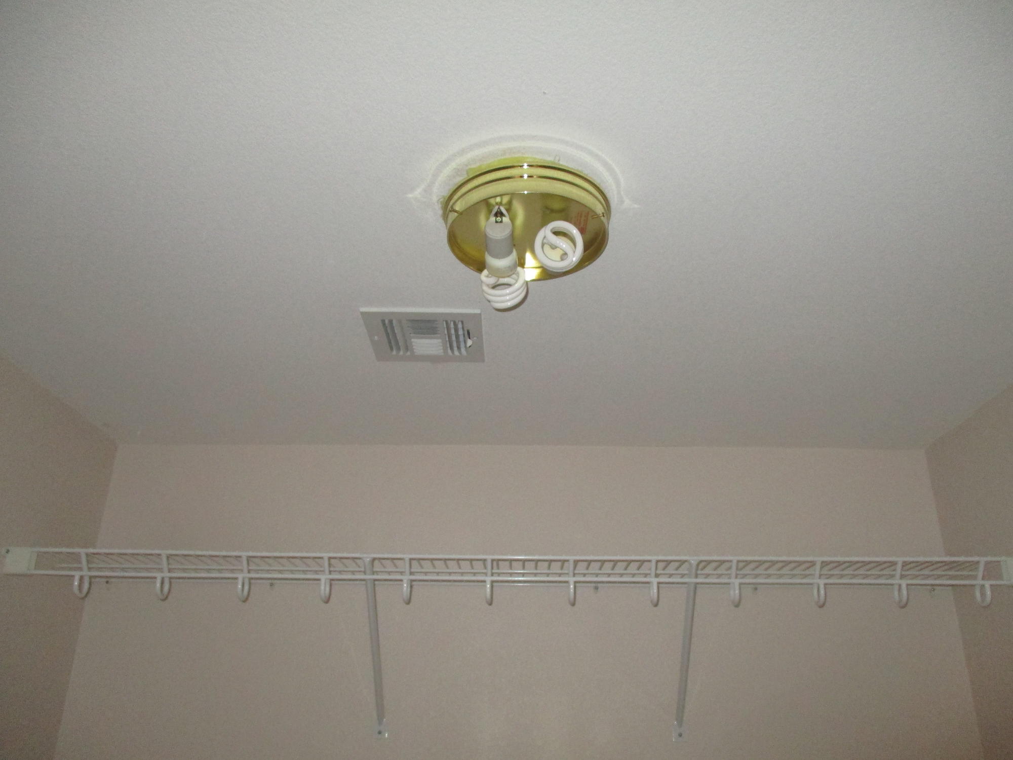

This light fixture was in a closet and did not have its protective globe. This is a safety hazard as the heat from the bulbs could potentially ignite combustible items in the closet. The light fixture did not have a 12" clearance to shelving in the closet either.

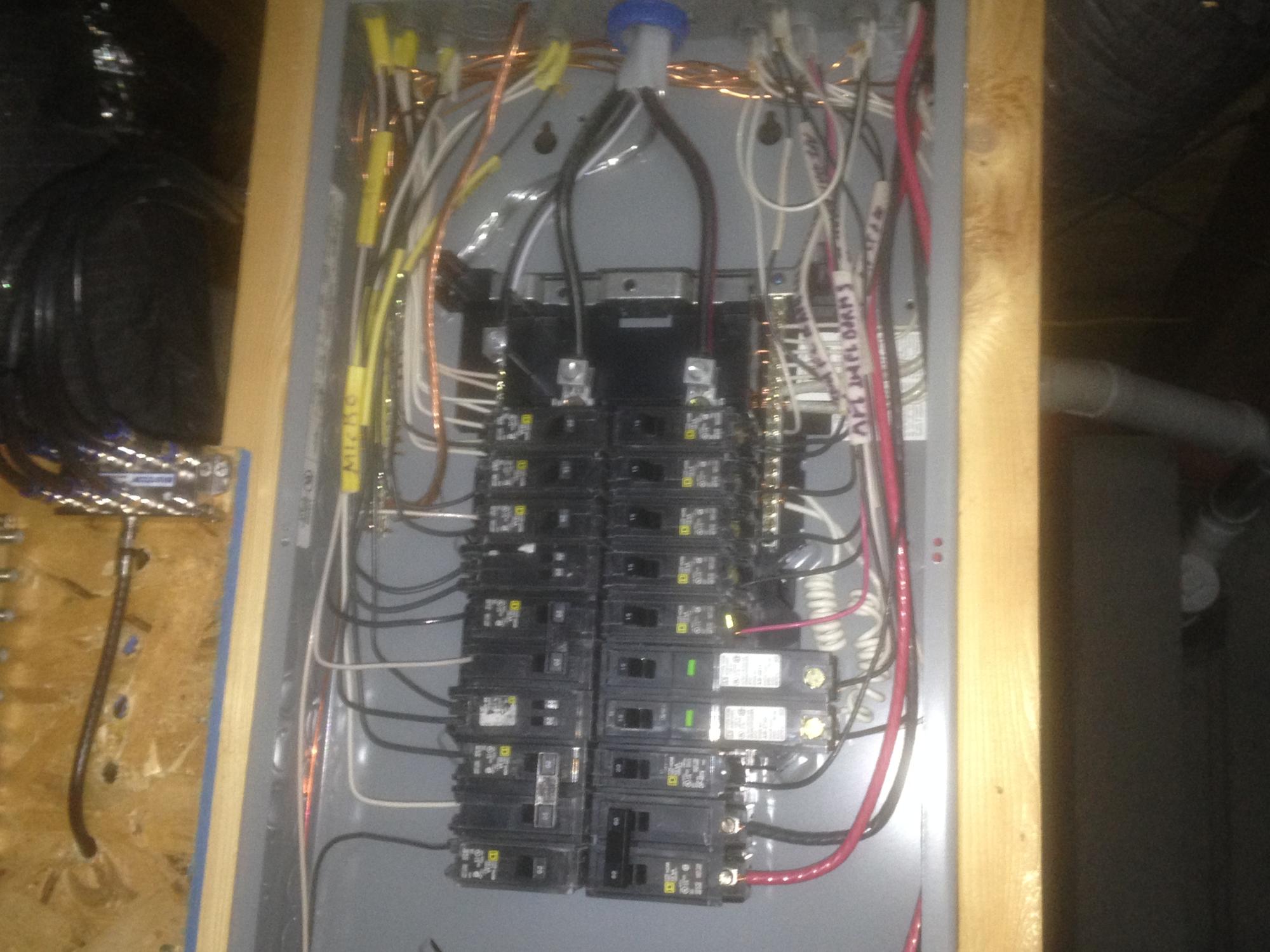

In this photo, you are looking at a 125 amp Square-D type sub panel, which is providing the power requirements to an addition of this structure. There are the appropriate plastic insulation rings on all of the conduit chases entering the panel box. There is no evidence of the protective fluid on the aluminum load lines where they attach to the buss. Being a newer renovation , there are Afci breakers for the two bedrooms indicated. Being a sub panel , the ground buss and the neutral bus are not bonded together. There does appear to be two white conductors being used as the 2nd phase of 220v out to the a/c unit and the air handler that do not have black tape on them to designate them as “Hot” leads.

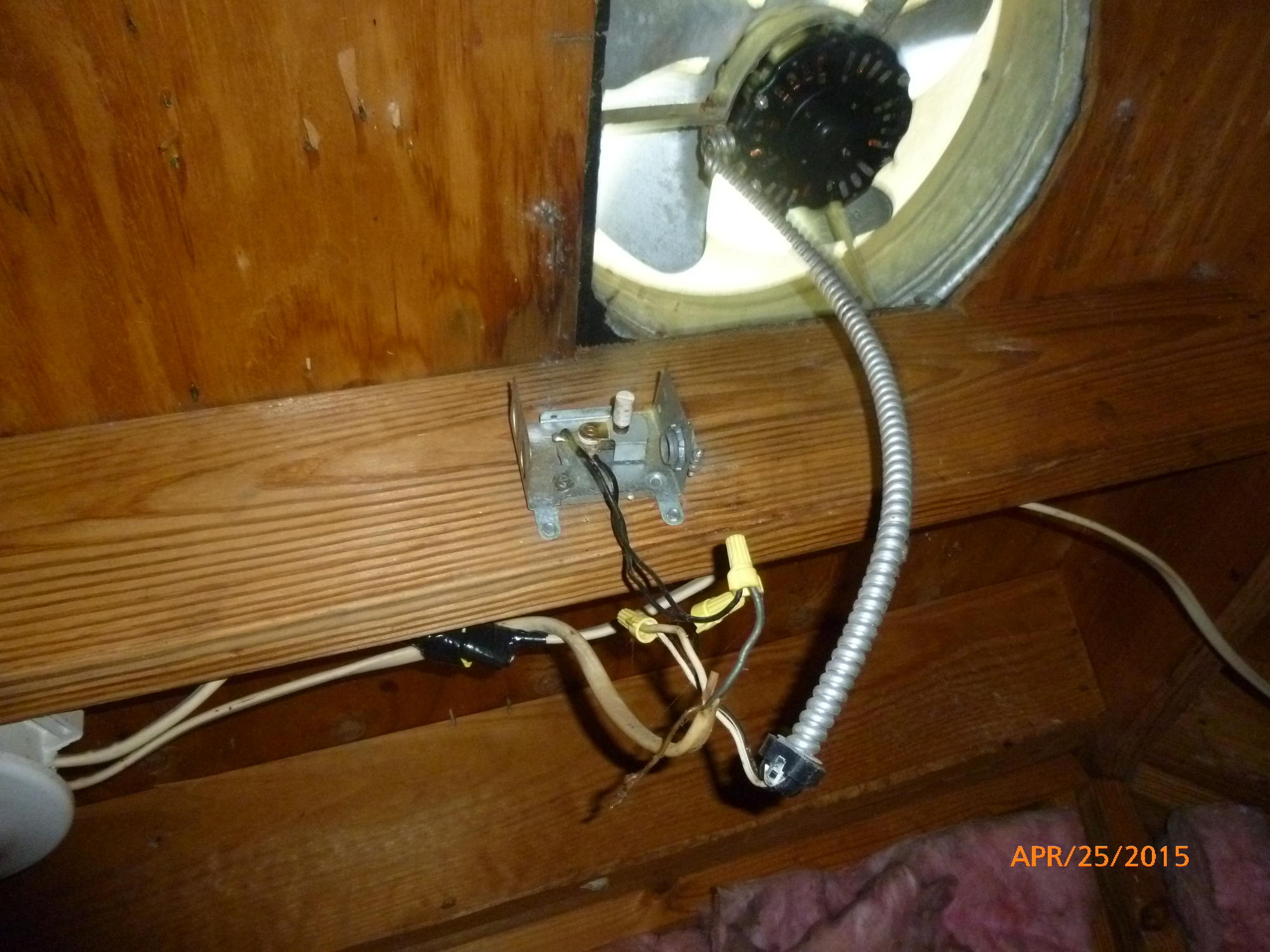

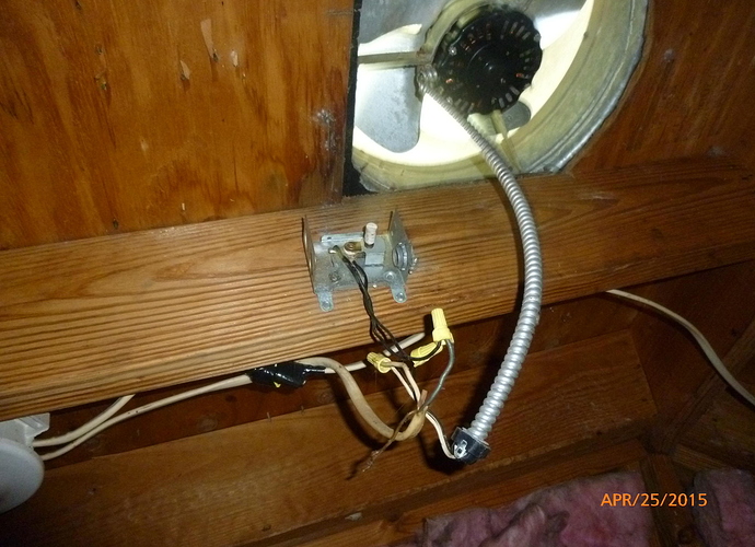

During a recent inspection of an older home, i took this picture of an attic exhaust fan that was missing the control cover, no junction box, tapped into the light fixture adjacent. This particular home had serious electrical issues and a i performed my inspection it became obvious that the home was in serious need of a licensed electrician to perform a more through inspection. In almost every room there was a defect with the electrical from missing cover plates, scorched receptacles, open junction boxes and the list goes on. I also noted that this home had a Zinsco panel and advised my client as to the history of this type system.
The home also included additions to the main structure that included subpanels that were not installed by a licensed electrician.
