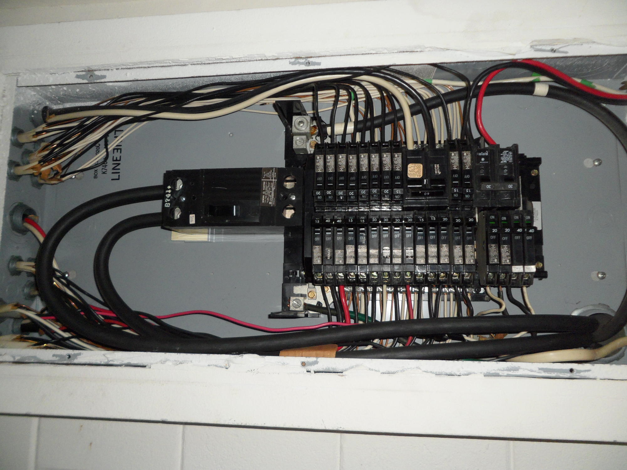

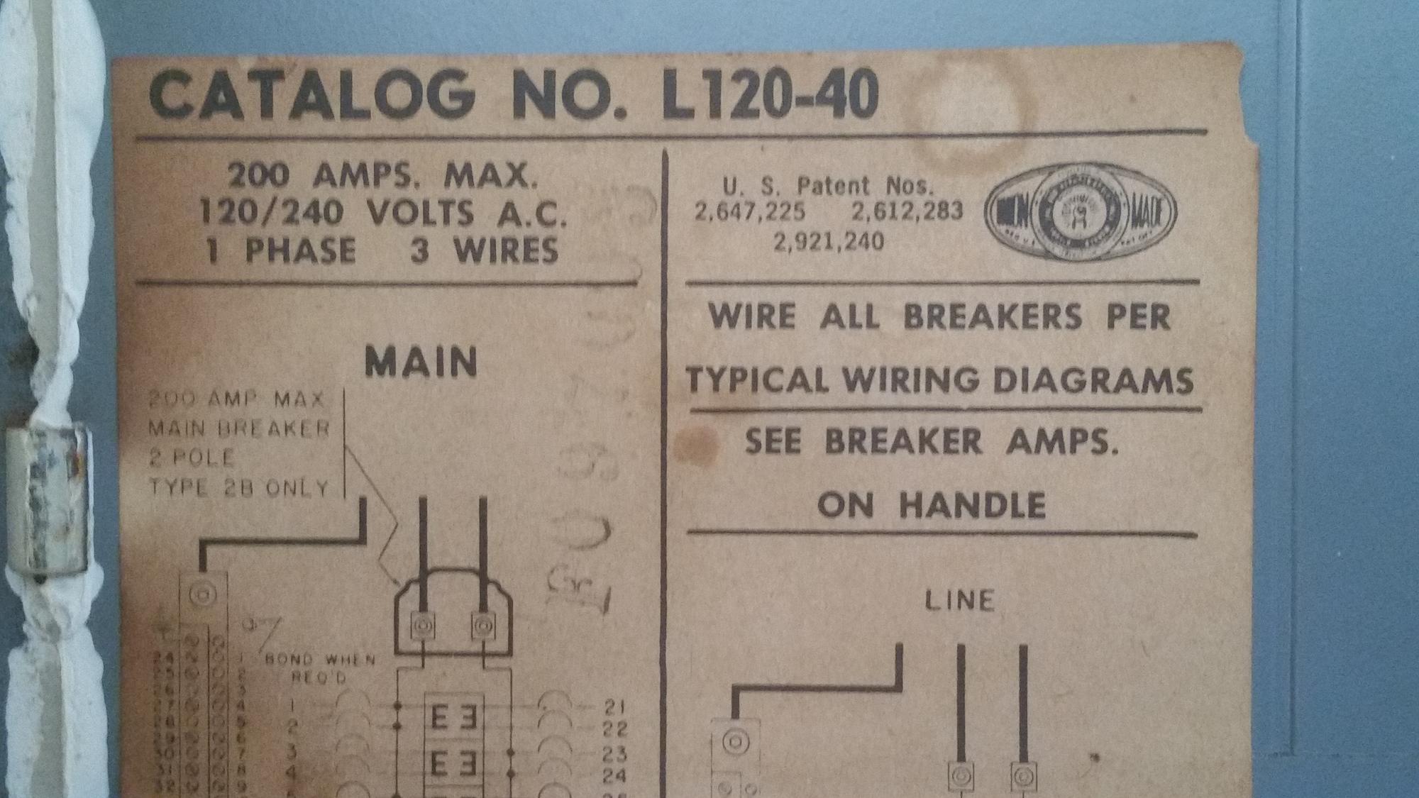

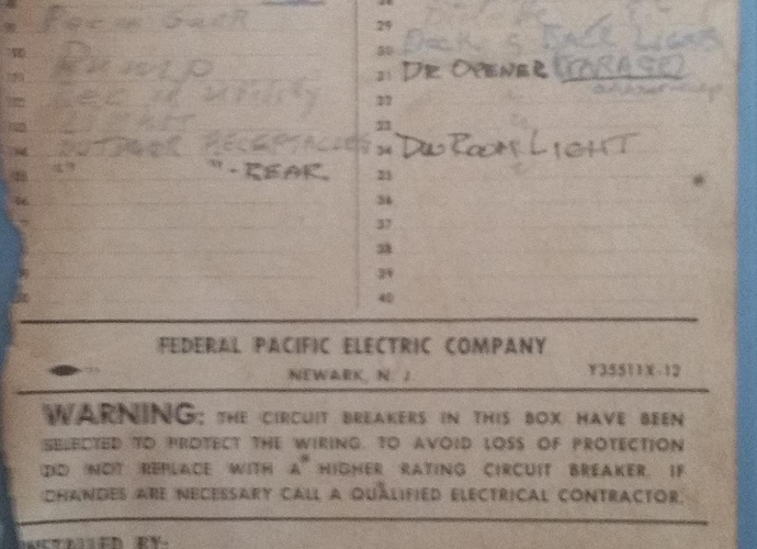

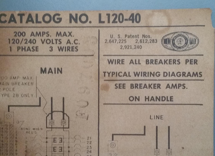

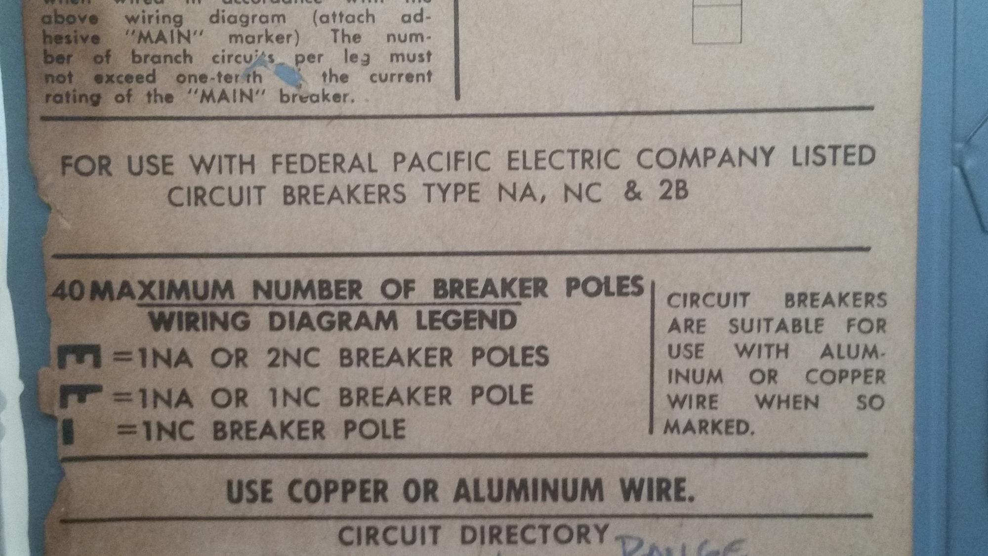

This is a picture of the main service disconnect panel of my house. From reading of the course material and my limited knowledge of electrical systems, everything looks to have the criteria specified. The legend has all breakers accounted for. It is 40 poles max., branch breakers are 150 amp max. for copper and 125 amp max. for aluminum wires. The available amperage, which is the lowest amps listed is 100 amps. Main ratings says it is a standard 120/240 V.A.C., 3 wire, 1 phase, 200 amp max. The panelboard and breakers are made by General Electric and has the U.L. stamp.

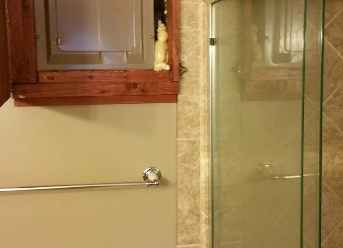

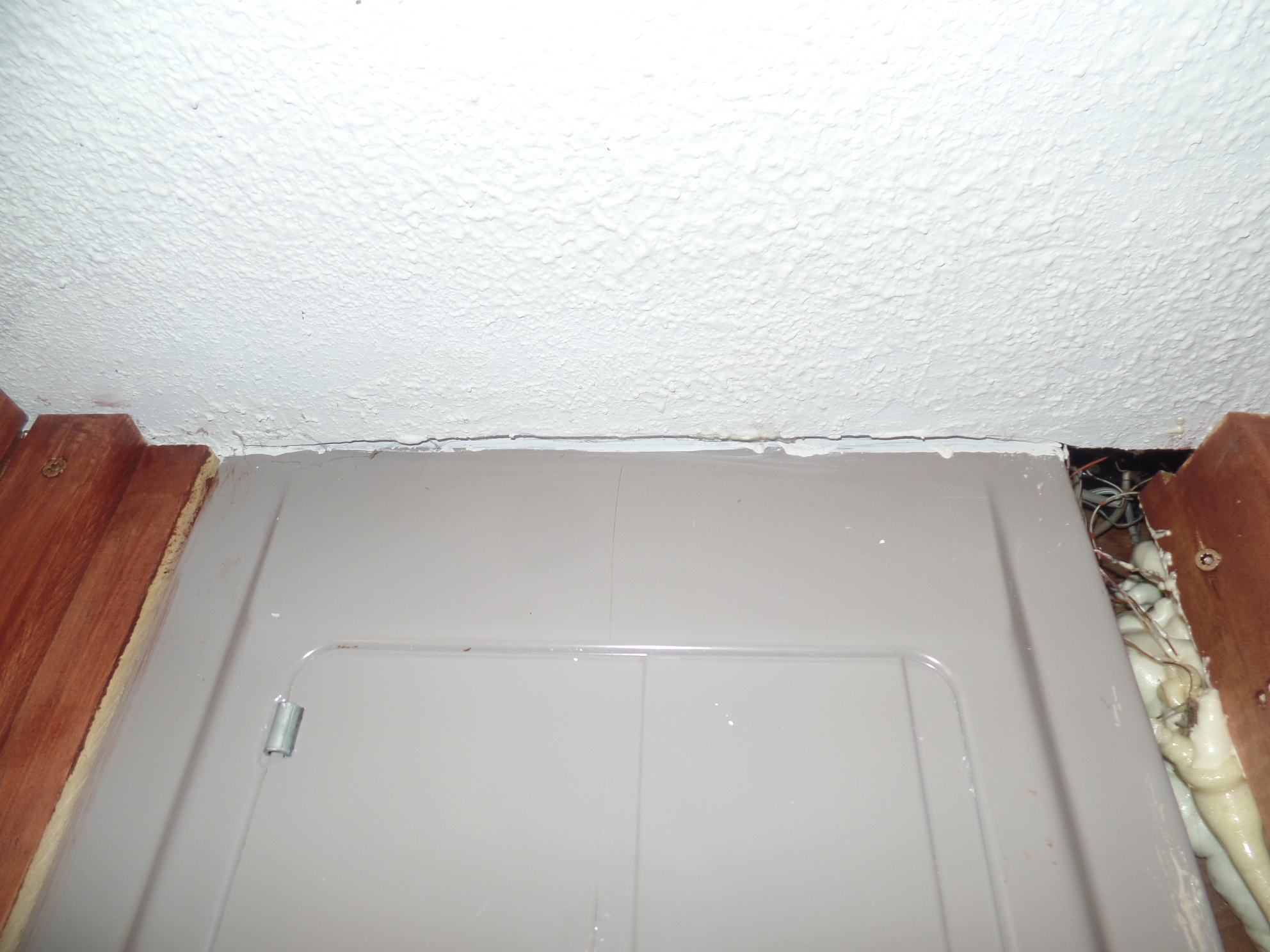

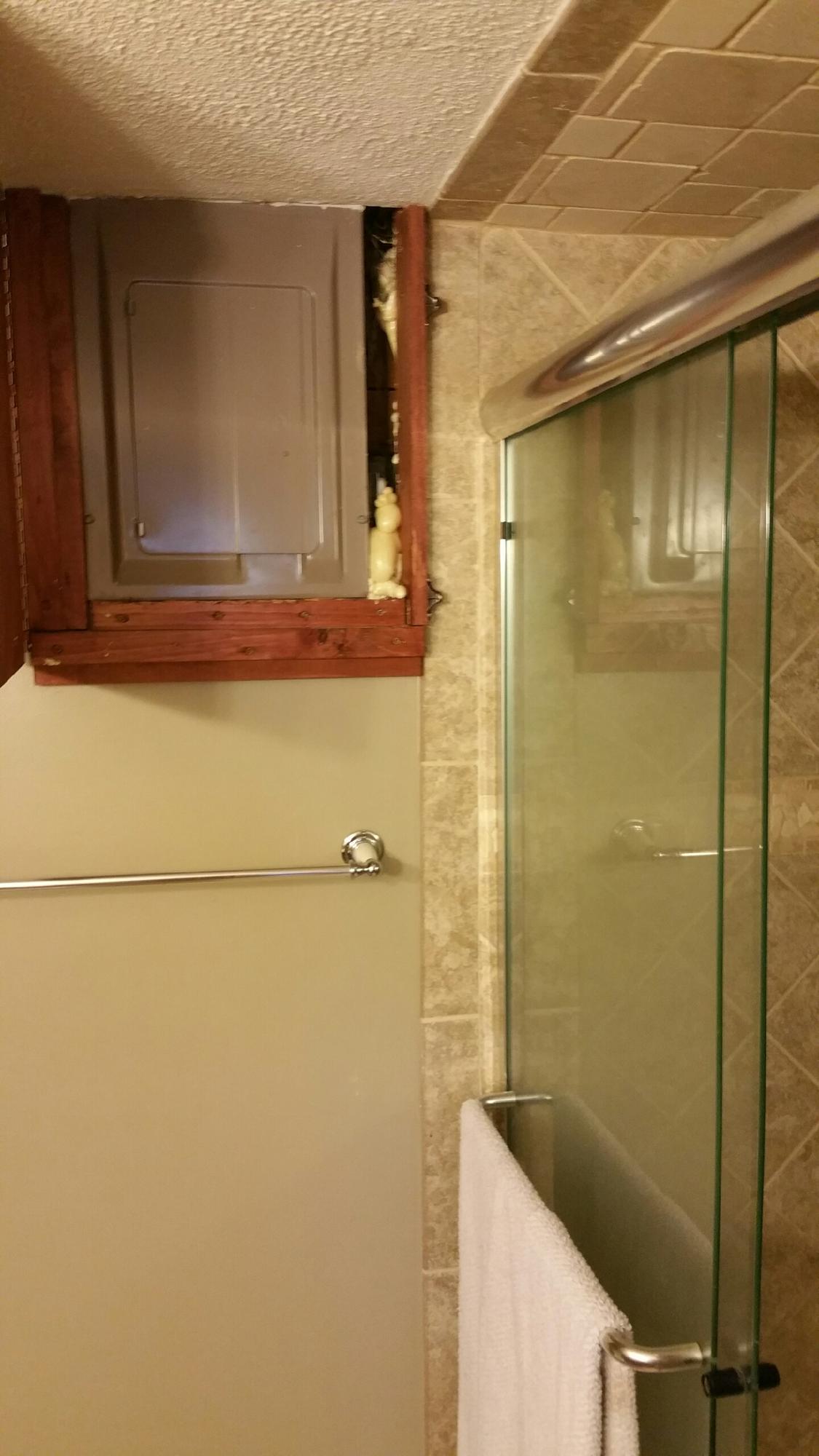

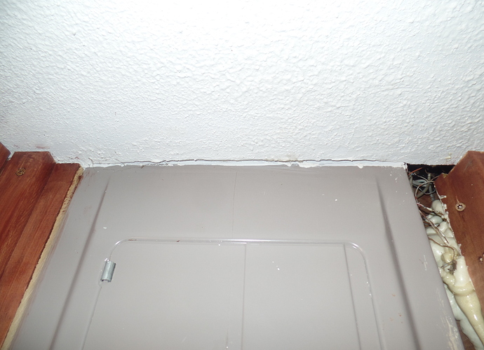

This service panel was in a bathroom next to the shower which was a safety issue. The panel had a breaker missing so there was an opening. The panel did not have sufficient amount of clearance as well. Recommended a licensed electrician for repair.

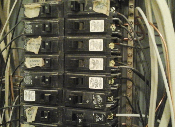

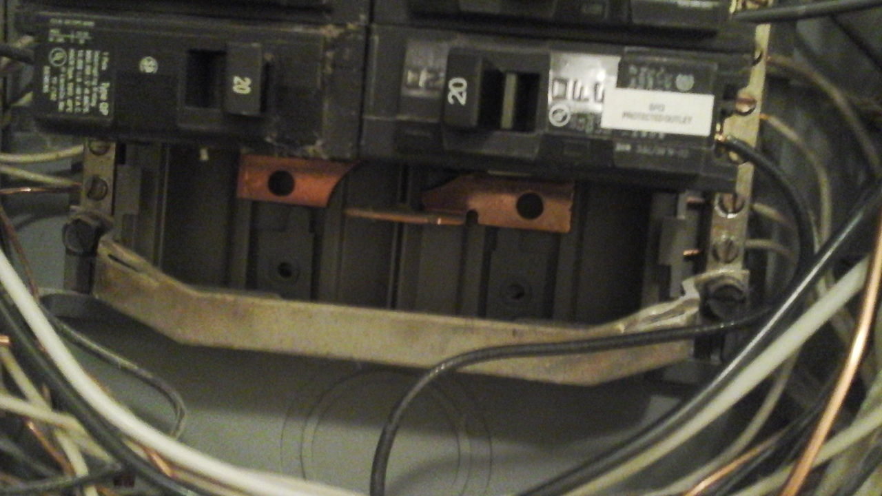

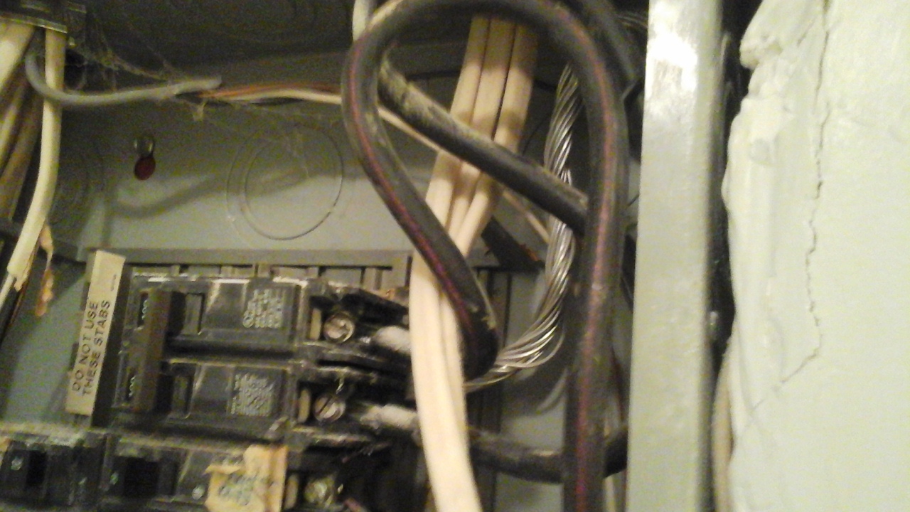

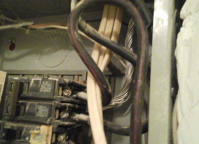

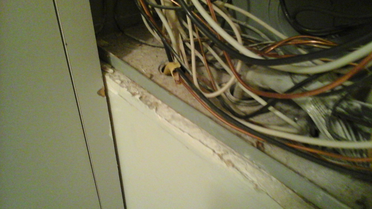

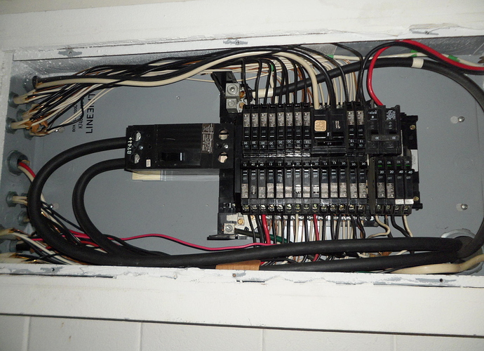

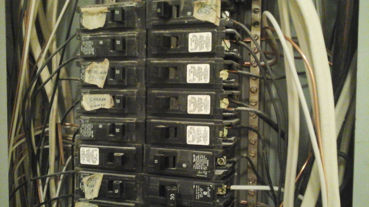

This is a iemens 100 amp panel, I cannot ID the weakest link because I cannot ID the service entrance wire size. This panel has many violation issues, The panel is not flush with the wall and the panel deadfront does not fit proper. There are two double taps on the circuit breaker as well as double taps on the neutral bar. Sleeving has been left on the romex and many of the circuit breakers or over size for the wire feeding the branch circuits. The panel is not bonded. There is no bonding bushing on the connector were the service entrance enters the panel and many of the circuit leaving the panel lack the proper connector were the romex leaves the panel through the knock out. Neutral and grounds share the same lug.

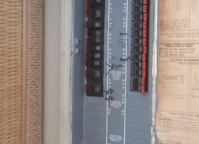

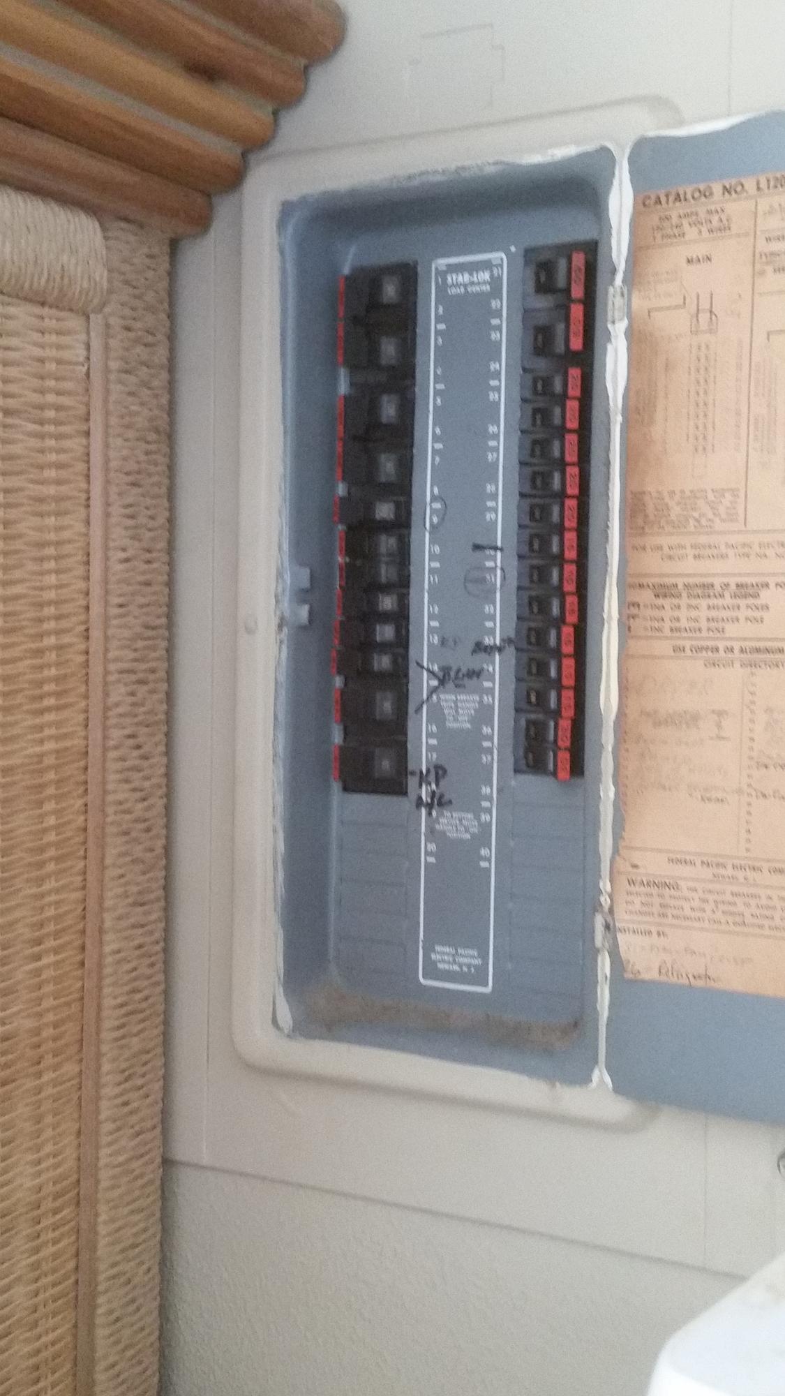

Attached is a 200 amp panel. It appears that each circuit breaker is properly labeled. This will make it safe for when any circuit needs to be worked on.

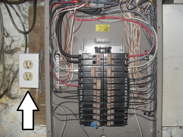

electrical plug next to panel was not gfci

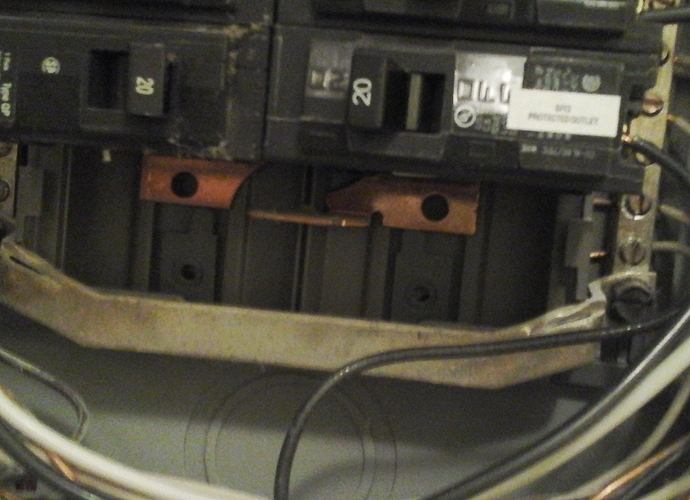

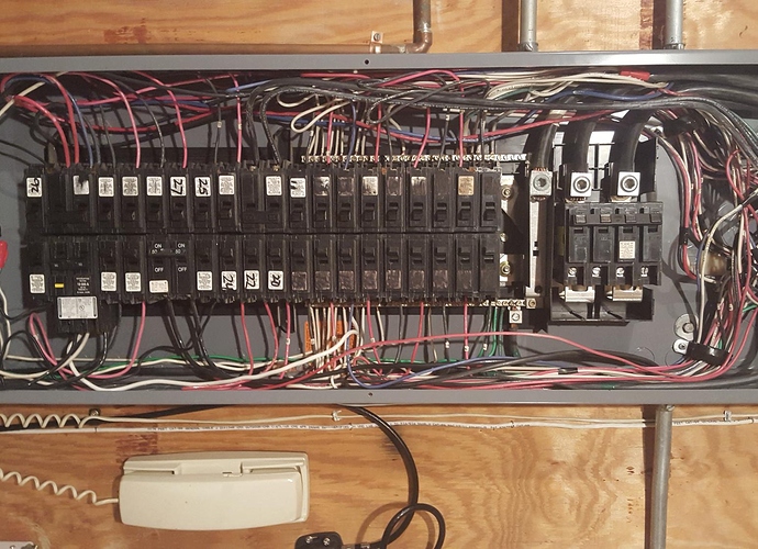

6 dbl tapped breakers in service panel
no jumper for the water meter

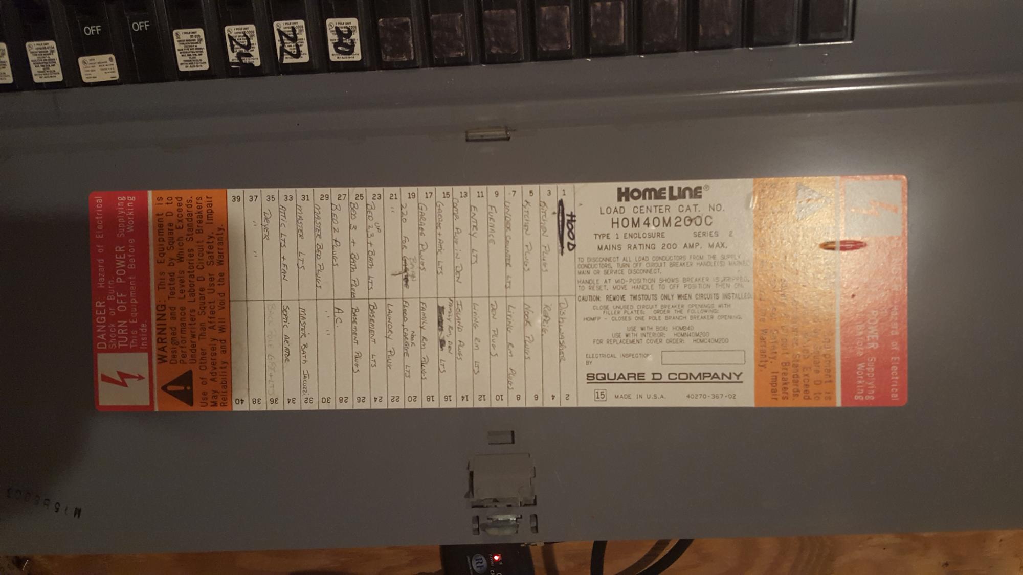

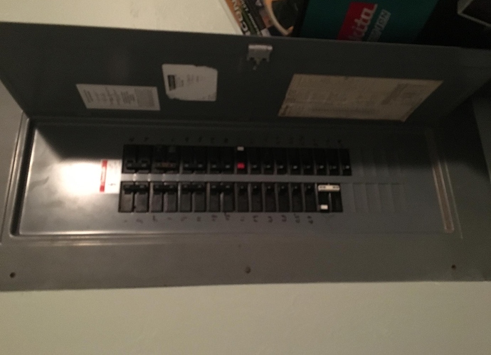

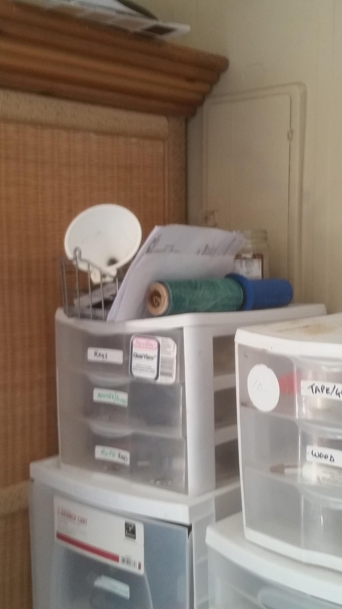

I inspected a 200 amp electrical panel, and found it to be semi-blocked from view, and completely unable to open due to heavy furniture in front of it. What I did inspect, was that the panel had no areas uncovered, and that panel was affixed to the wall correctly. Inside, the panel was clearly marked 200 amps, and most of the breakers were marked. Some were very light, as markings must have faded. Also said it was approved for aluminum and copper wires.

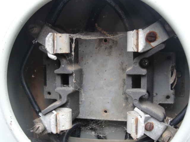

The photo was taken of a meter box located on a house in foreclosure. As you can see, the meter has been removed and there have been jumper wires connected across the meter lugs so that power is restored to the house. There is no protective cover over the opening so anyone could reach into the box and possibly receive a fatal shock.

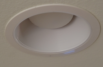

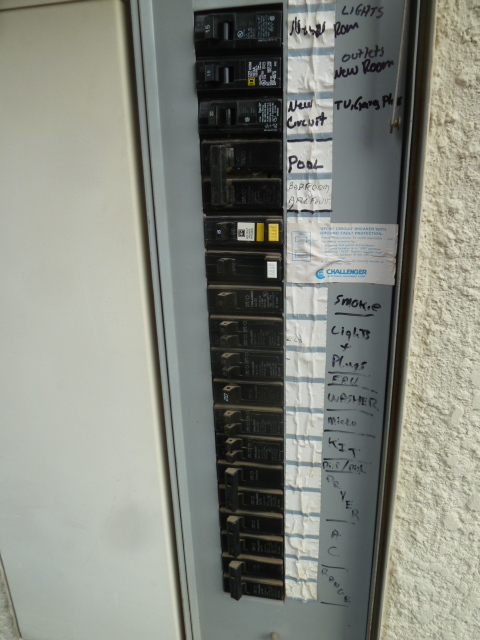

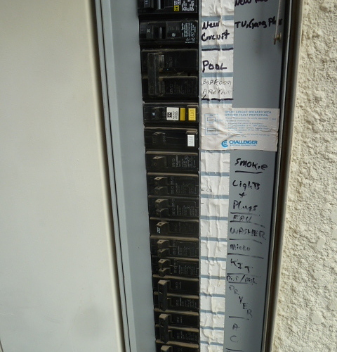

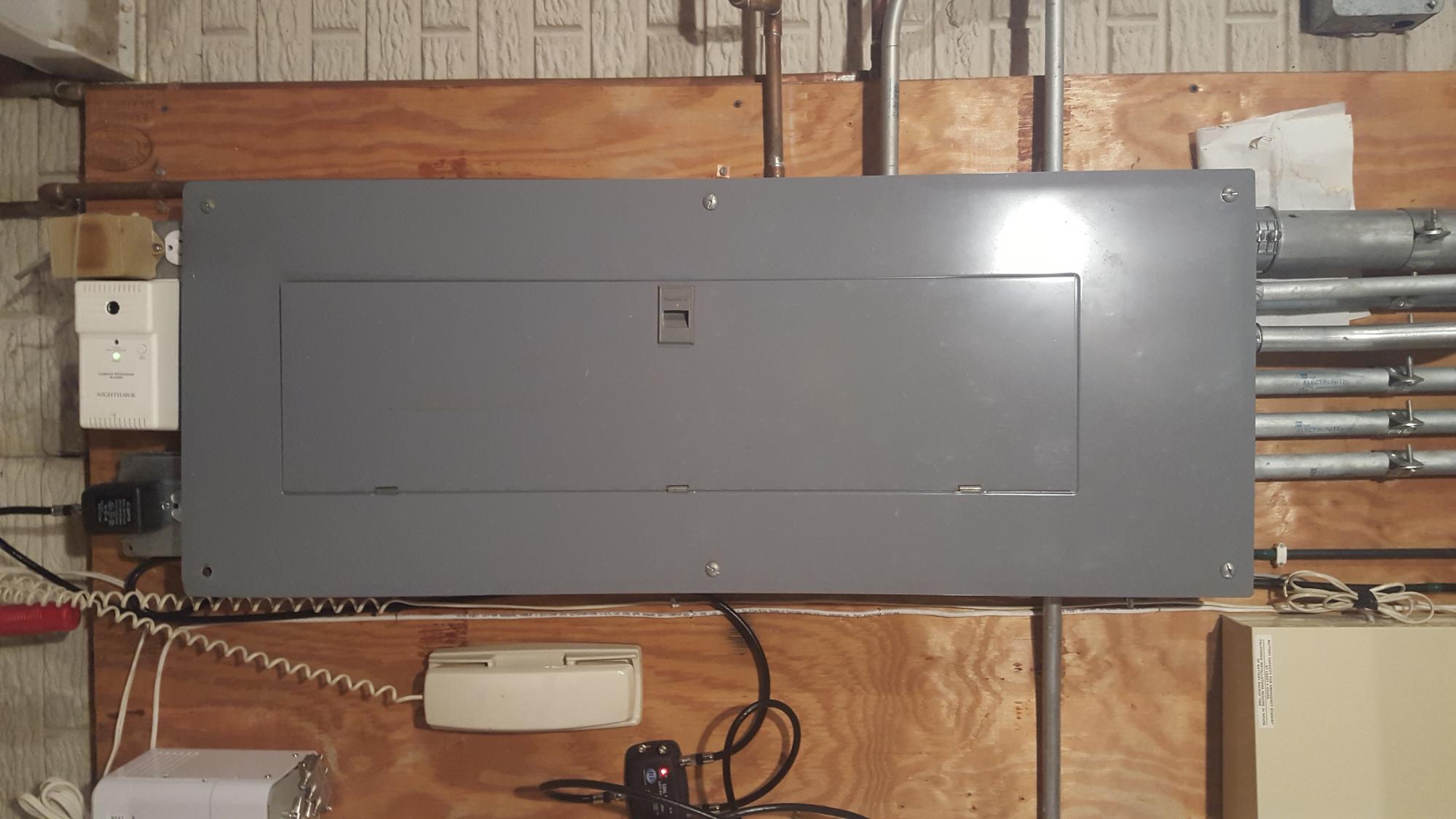

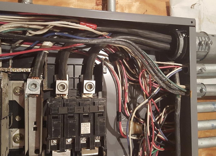

In my 5 photos you will see my own personal main panel. You will notice 1 screw from the dead front missing. You will also see that the neutral on the SEC is properly labeled with white tape.Also the ground is labeled with green tape. You only see 1 G.F.C.I. breaker in this box, that is dedicated to my swimming pool. I have G.F.C.I. devices located throughout my home. You do not see any A.F.C.I. breakers due to the fack this panel was installed when the house was built in 1993. Also you see that the panel is labeled throughout. This panel was installed by my buddy who is a Local #38 electrician, that is why you see the beautiful conduit work. That is not typically done in new construction homes due to cost. Thank you, Brian Such.

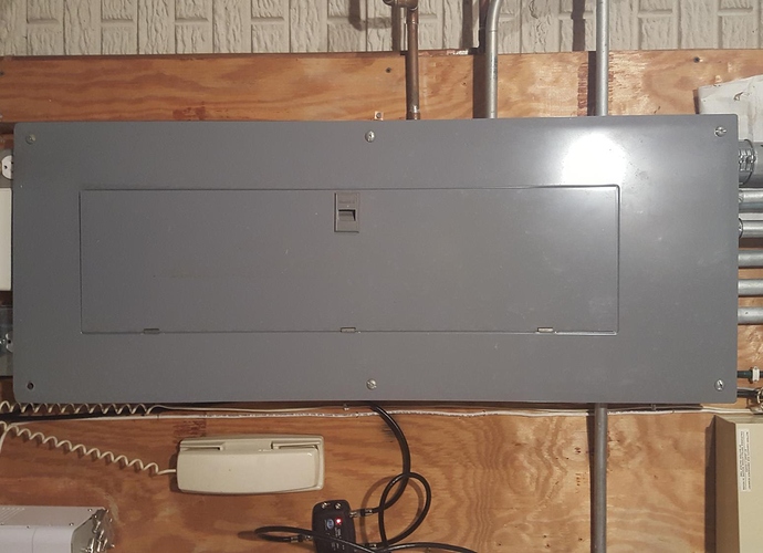

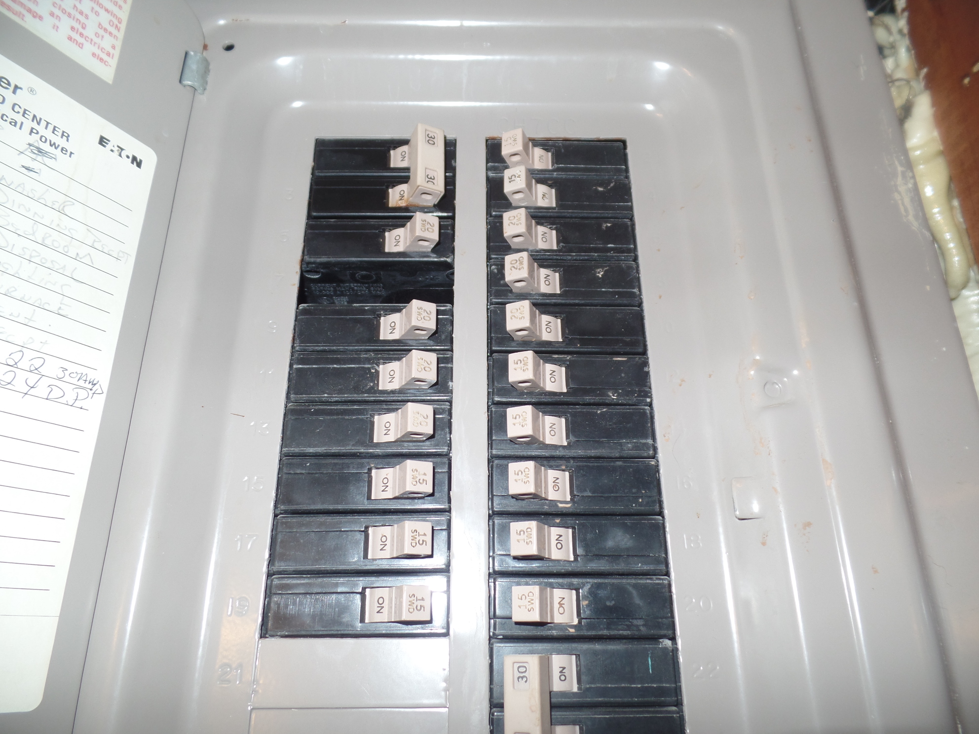

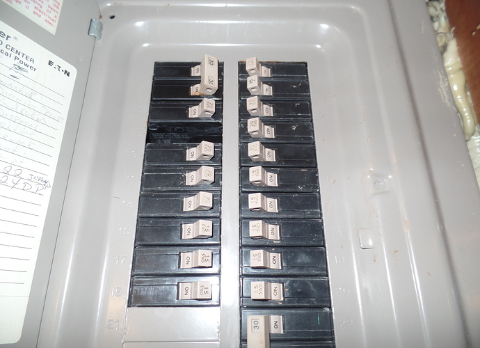

I Inspected the main service panel. It has a 200amp service, all breakers are labeled. The panel is missing 3 of the 6 hold down screws. It contains tied double pole brakes for 240 volt appliances. It also has a gfci breaker for the garage outlets. I would recommend installing the proper hold down screws in my report.

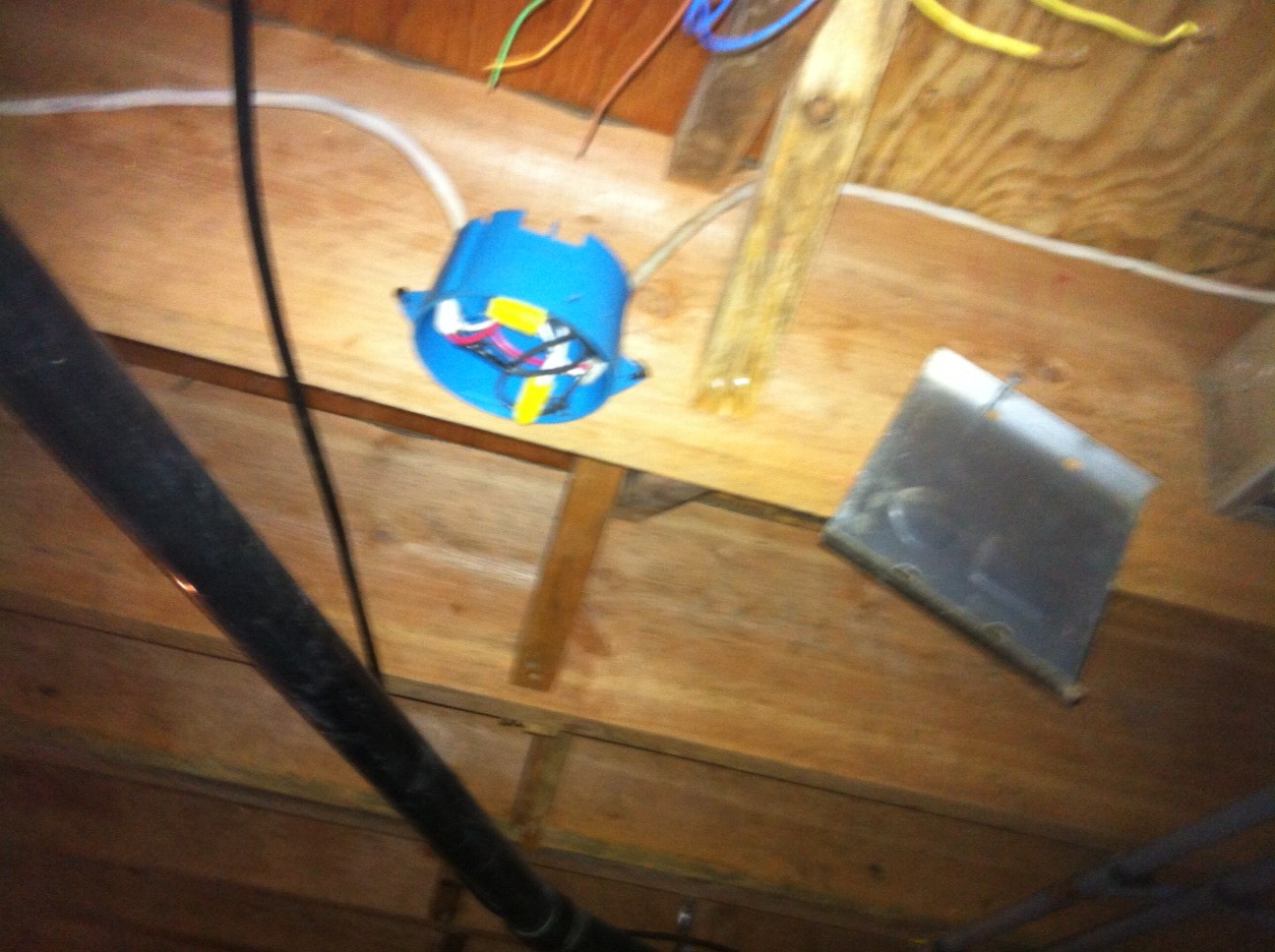

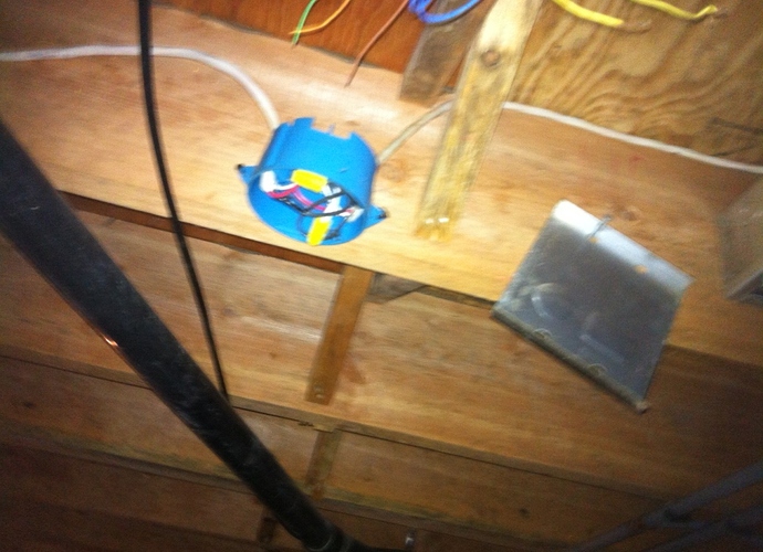

Here is a missing cover plate on a junction box that i found when inspecting a home recently , enjoyed th evideo in the course !!
