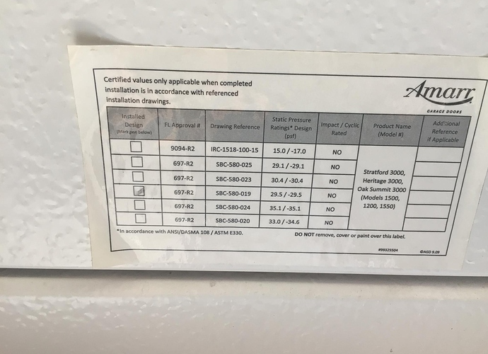

The following 2 photos (in order) are showing a garage door info sticker and attachment schedule to the dwelling. As you can see the rating marked on the sticker would indicate a “X” to be ticked on the D row of the 1802 report. (Non-Glazed) Finally, the door rails are bracket bolted into 2”x 6”s seven times on either side of the door. (Anchor bolts used to secure the 2” x 6”s to the block wall of the dwelling.

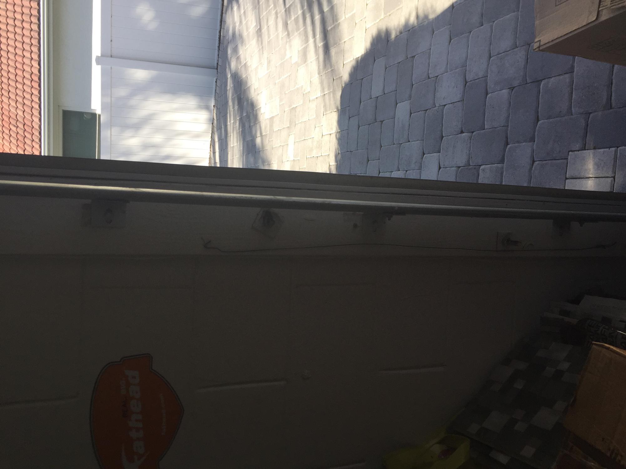

On a recent wind mitigation inspection I observed this overhead garage door and installation methods. This is not a compliant door with regards to wind mitigation. On the OIR-B1-1802 Uniform Mitigation Verification Inspection Form regarding the protection of openings, this door is an “X” which calls out no windborne debris protection.

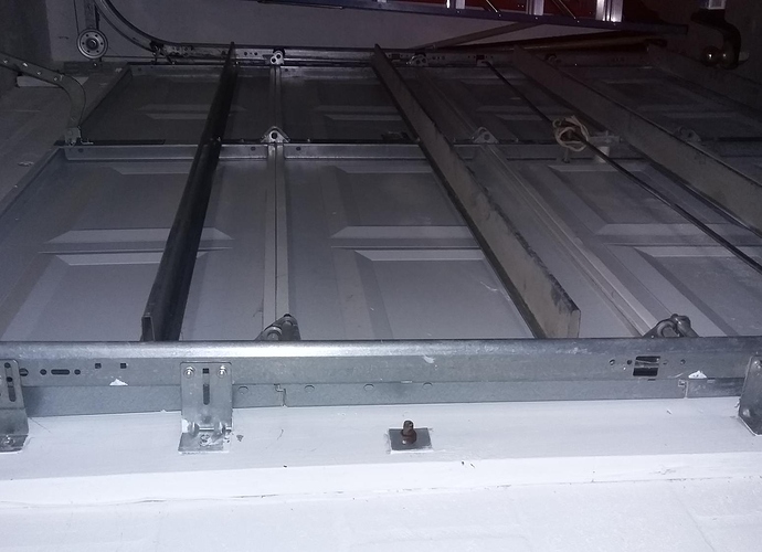

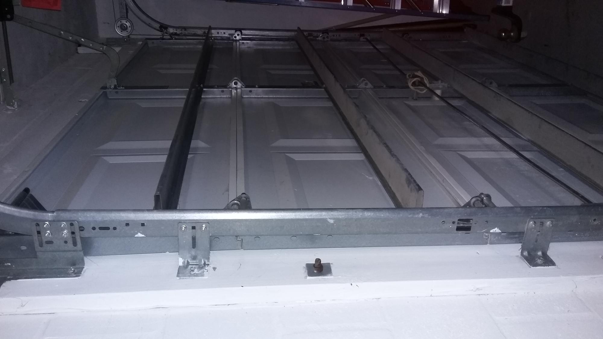

I have attached 2 pictures, a garage door and the garage door mounting brackets.
After inspecting the door I determined the door is steel with no windows. The door has Heavy duty cross members and meets wind resistance requirements. The Garage door does not have any proof of meeting large missile requirements and further inspection shows there are only 4 mounting brackets on each side of the door therefore confirming NO large missile rating.

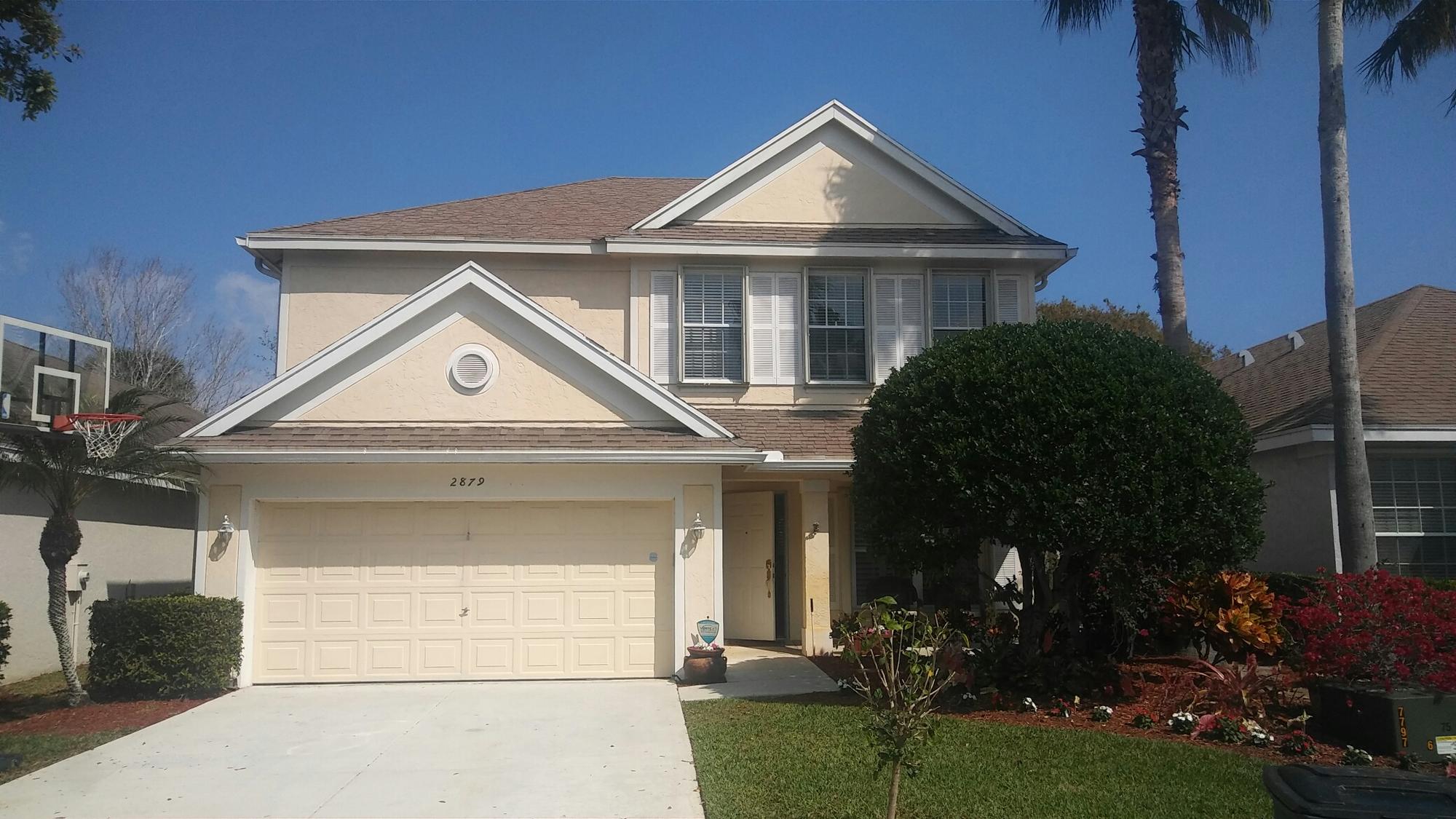

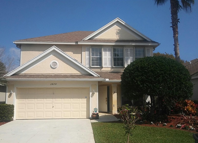

This is a picture of the front elevation of my house. The geometry of this roof would put it into the category of “other” for the roof type on the Florida wind mitigation report. The reason for this is because the gables add up to more than ten percent of the total roof line.

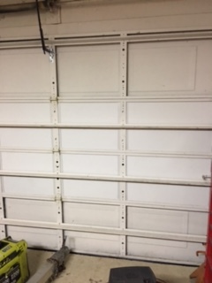

I have attached a picture of ny Rental Home’s Garage door… As you can see there is no heavy duty bracing on the door, therefore does not meet approved wind resistance requirements. Nor does it meet HVHZ requirements…

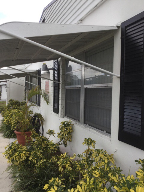

The attached photo shows the rear corner of a home with a built in screened porch and a gable roof. The storm panels on the bay window are partially installed and show the wind debris protection method used for this home. If properly documented, they’ll provide A.1 impact protection for the openings on the house. While the gable won’t help their insurance premiums or wind resistance, the opening protection will offset some of that issue.

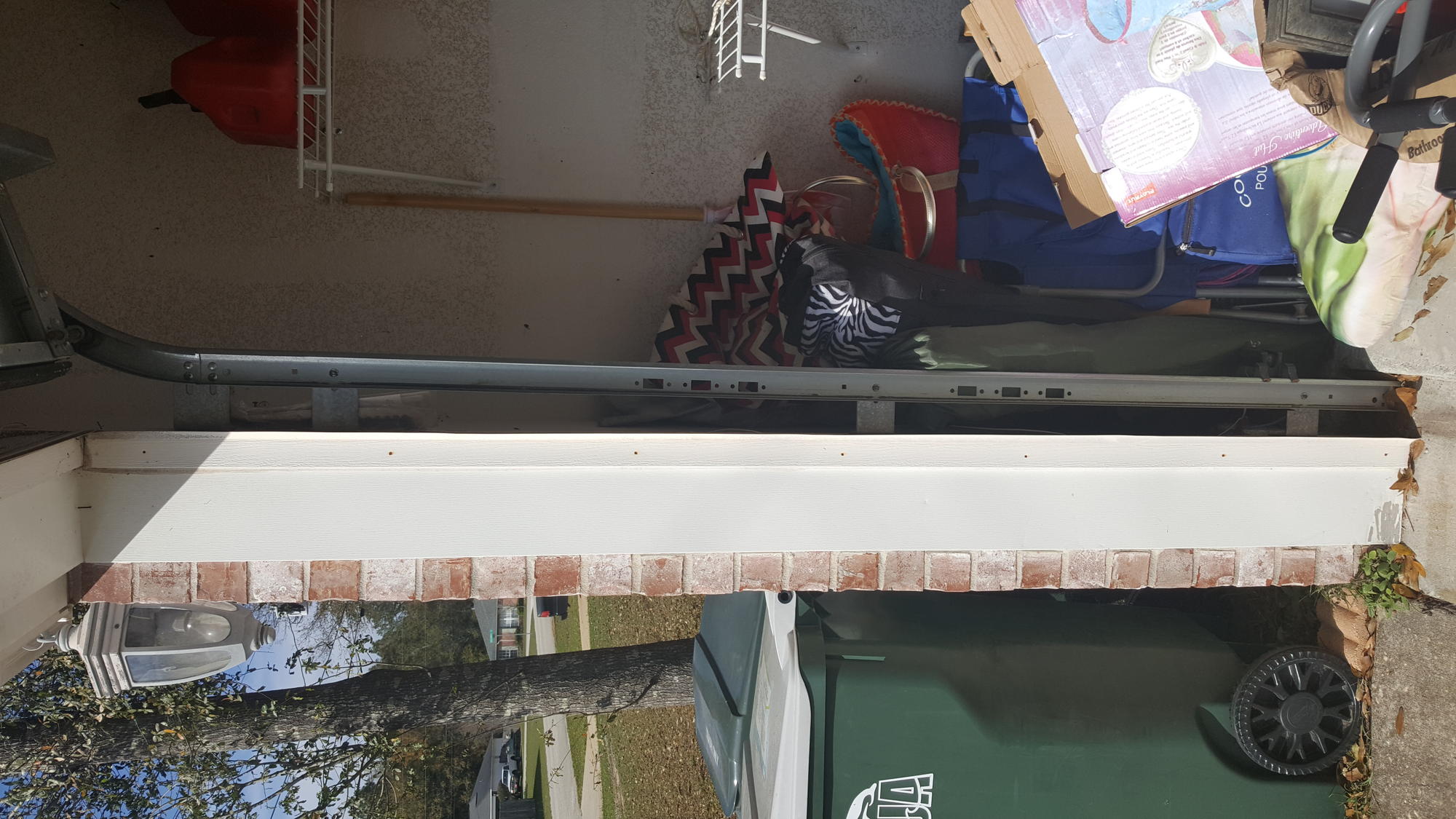

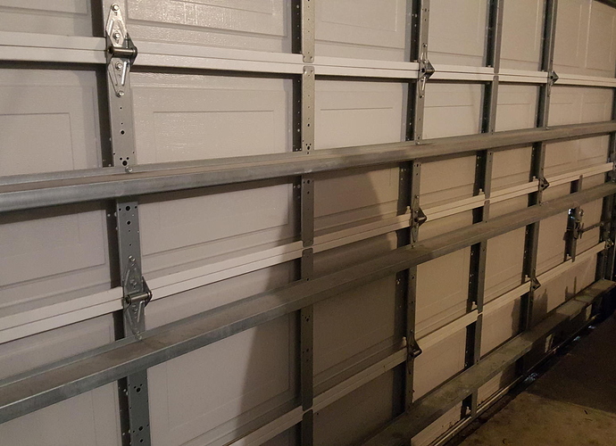

While Inspecting the home. I found the garage door to have extra bracing but lacked the number of jamb bracket allowable to make this garage door a hurricane rated door and does not meet the requirements for wind mitigation,
