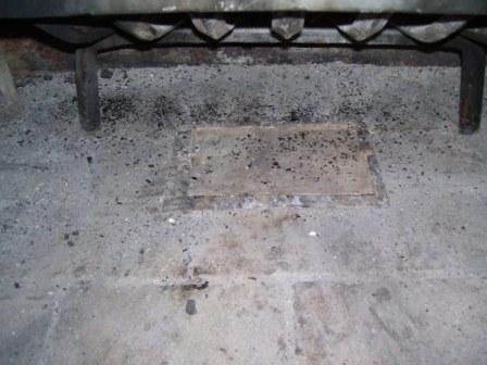

Inspecting the chimney access door
Wanted to ask if other inspectors inspect the access door for chimneys.
For example; You cant look down the stack at the roof do to pitch/cap.
I try to open the doors if accesable. I usually find dead birds and I like to use a mirror to see if the flue is clear and if there are any visual defects.
Some times the doors are in poor condition & are rarely if ever opened.
Thanks
Dave
If I can get to it and open it I look in it. I found one full of water which was strange since it had a rain cap.

I’ve never heard of a chimney access door and, obviously, never seen one. Can someone post a few pictures; I can’t tell what that posted picture is.

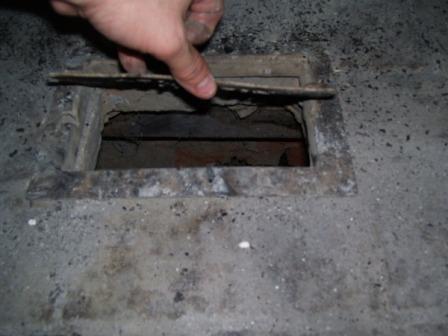

RR - it is a cleanout under the “floor” of the chimney for models with ash bins.
If, on the floor of the fireplace, there is a grate or other opening to sweep ashes into, there will be a cleanout somewhere (basement or exterior of home) to allow you to go in and clean out the ashes by the shovel full periodically (or if you are like most homeowners, never!)
These are my pics from my home…
That’s not a “chimney access door.” That’s an “ash door.” And it is not in the chimney; it is in the firebox, usually the firebox floor, but sometimes the rear firebox wall. On the outside of the chimney should be an “ash cleanout door.”
However, if that what is being called a “chimney access door,” then, when possible, I do open them. Rarely do I find one accessible because all of our fireboxes here either are full of logs and ashes (and I don’t clean out fireboxes; that’s the chimney sweeps’ job) or they have installed a gas logset of some type.
If I were to call anything the “chimney access door,” I would consider the damper to be such.
Perhaps I have the wrong terminology. I have always called the opening on the floor of the firebox and ash door or ash catcher. The other opening I refer to as the chimney cleanout, although I suppose it is more correctly referred to as the ash box cleanout.
Maybe I have been using the wrong terms, but I thought the firebox was the area where the fire exists in the fireplace. The area below that should have another name (but again, not a chimney or fireplace expert - I refer all that stuff).
I still knew where he was going with the question…The part he was referring to as the chimney access door is the opening I show on teh exterior of the home below the fireplace level where the ashes collect.
So the ash cleanout door.
But since the ash is below the firebox, there would be no access to the chimney through the ash cleanout door (hopefully) other than through the firebox and then through the damper.
But I think I’m with everyone now, I hope. So if we’re talking about the ash cleanout door on the exterior, yes, I open them (when possible, they usually are rusted shut or been covered up with soil). If we’re talking about the ash door in the bottom or side of the firebox, yes, I open them when possible. If we’re talking about the chimney damper, yes, I open them.

I guess I was referring (and will refer in the future) to the “ash pit” and it’s clean out door (what I believe we had been calling the “Chimney Access Door”) .
