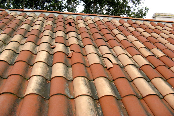

Inspection & Writing Assignment:
This roof is made up of clay tile. The tiles are in poor condition and some of them are not attached properly to the roof. Some of the tiles are broken and/or cracked. I recommend the roof to be repaired or replaced.
The image is of a damaged tile roof. You can clearly see visible cracking in the roof tiles. Parts of several tiles have broken and fallen off. The tile on this roofing system looks to have been installed properly with the correct overlap. Damage may have been caused by impact; possibly hail/weather related, or tree limb. This roof is clearly in need of repair.
