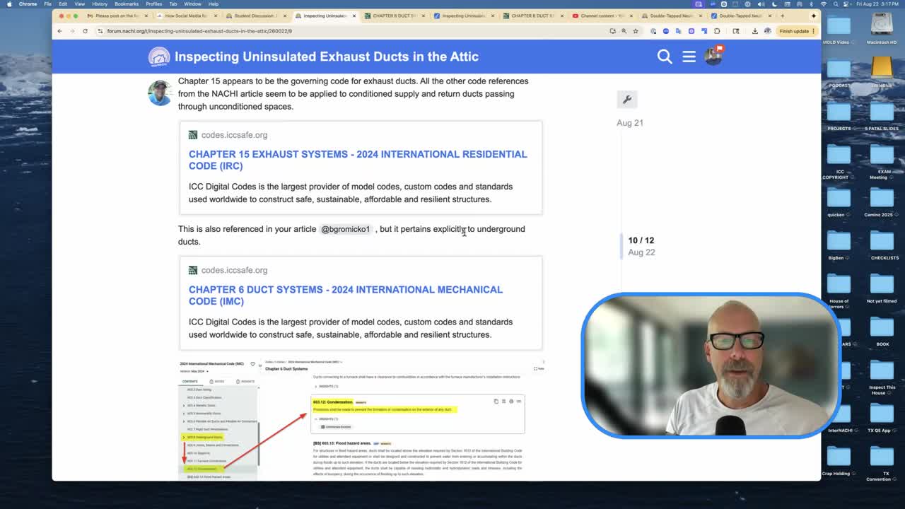

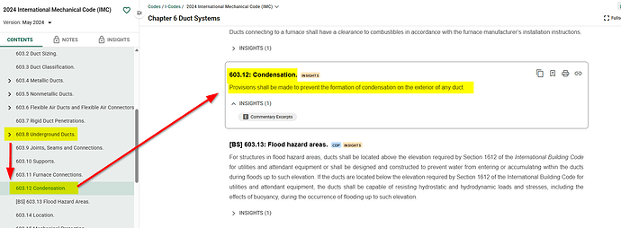

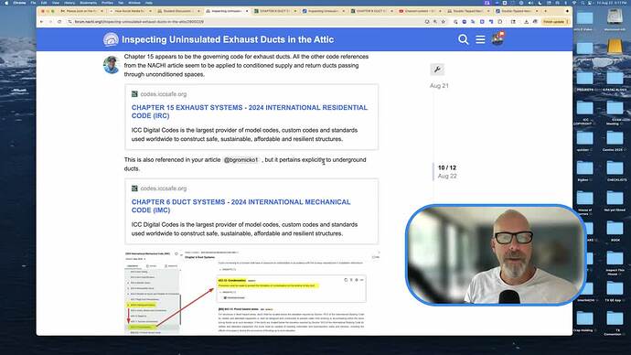

Chapter 15 appears to be the governing code for exhaust ducts. All the other code references from the NACHI article seem to be applied to conditioned supply and return ducts passing through unconditioned spaces.
This is also referenced in your article @bgromicko1 , but it pertains explicitly to underground ducts.
Correct, but lacks info on sealing and insulating ducts passing through unconditioned attic spaces.
As the article states, there are building codes and standards that focus on heating, ventilation, and air conditioning (HVAC) supply and return ducts located outside the conditioned space. The underlying principle of those codes preventing heat loss and condensation applies equally to mechanical exhaust ducts.
That’s a stretch. How did you come to that conclusion? Each one of your reference codes speak of supply and return ducts in unconditioned spaces.
I’m not here to argue or change your mind. One primary purpose of InterNACHI’s published articles is to function as the definitive, citable standard for the inspection profession. By linking to these official references in a report, an inspector substantiates their findings with the credibility of an authoritative, third-party reference. This practice elevates an inspector’s observation into an established finding for both clients and contractors.
