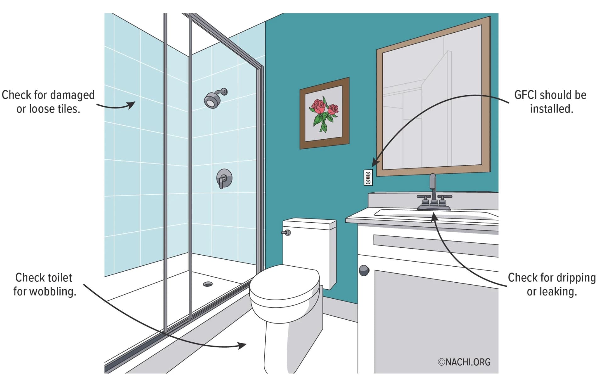

Here’s a new checklist for inspecting bathrooms during a home inspection.
Don’t forget ventilation, check for cracks in the porcelain and look for discoloration in vinyl flooring due to a leaking wax seal. I also report water damage to mirrors.

Each one as been added to the updated Inspection Checklist for the Bathroom - InterNACHI®. Thanks, @rmayo.
According to 2024 IRC R202, a bathroom is not a habitable space. It’s not used for living, sleeping, dining, or cooking. Therefore, it does not require a heat source, such as a supply register from a furnace (2024 IRC R325.8).
Are we limiting to SOP here? I frequently find and report on sealant separation in the countertop to wall/backsplash or cabinet to wall. In some cases it’s minor and essentially cosmetic, but I have found some pretty beefy gaps before.

The ventilation illustration shows that it is prohibited to vent the bath through and out the soffit through a duct. Where is the prohibition on doing this?
There is none! On the contrary, a ducted exhaust is required. iRC2021, Section 1507.4 states that - “The exhaust air shall not be discharged into attic, soffit, ridge vent or crawl space. The duct shall terminate outdoors either through a roof jack or wall cap.”
That is something I always note in the report. We don’t inspect to code. No heat source in the bathroom is an undesirable situation.
Many of the electrical items on that checklist do not exist in older homes and are not REQUIRED (code is not retroactive). They are noted in the report as being inconvenient.
The 20 amp bathroom circuit often works the lights as well and is allowed by code (not dedicated to outlets only). GFCIs that also extinguish the lights when tripped is always noted (code does not prohibit it, but it is undesirable, inconvenient.)
WORDING is important. Don’t say things are required - you don’t inspect to code and rarely know what code cycle is pertinent.
