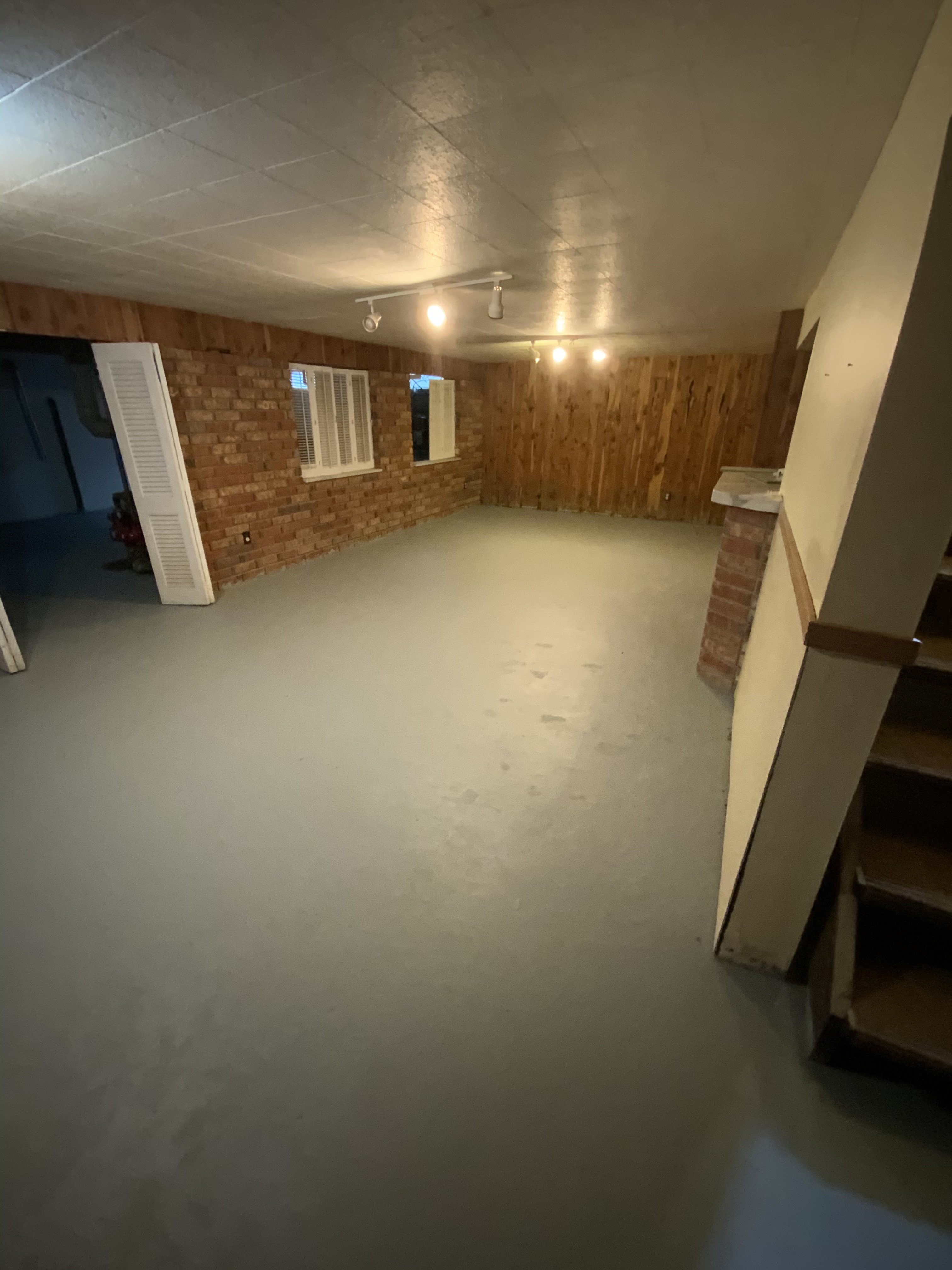

I inspected a home with a below grade unfinished basement with two partial crawlspaces that were open to the basement. There was gas HVAC equipment, plumbing, etc in this area but no heat source or return vent. I feel the area should be insulated but do the walls get it or the floor? Also, no vent opening for the crawlspace incase your wondering.

There ya go !
The area with the ceiling tiles and wood wall panels is all part of the unfinished area as well
If the space is not conditioned, why insulate? It is not part of the conditioned building envelope. The overhead floor structure should be insulated.
Unventilated crawlspaces should be conditioned (dehumidifier).
So are you saying if there was a HVAC vent, the walls would need to be insulated but since there is not only the floor joist need to have it?
If the crawlspace is open to the basement, it is in my opinion a conditioned space and the walls should be insulated.
You could insulate the basement walls and the floor structure over the crawl area.
Or you could insulate just the floor structure everywhere.
Or you could insulate the crawlspace walls.
One of the three above would complete your insulating of the building envelope.

If the crawl space is connected to the living space with no door the exterior walls should be insulated whether it’s conditioned or not. If the crawl space were not connected to the living space the floor could be insulated.

@pmccoy3 That is an interesting basement for sure. It looks like the crawl areas have louvred doors in the opening, is this correct? That IMO would make the crawl areas part of the conditioned space. And windows into the unfinished utility area? :thinking:
In the last picture, looks like efflorescence on the CMUs. Moisture issue. Insulation on damp walls = bad juju.
