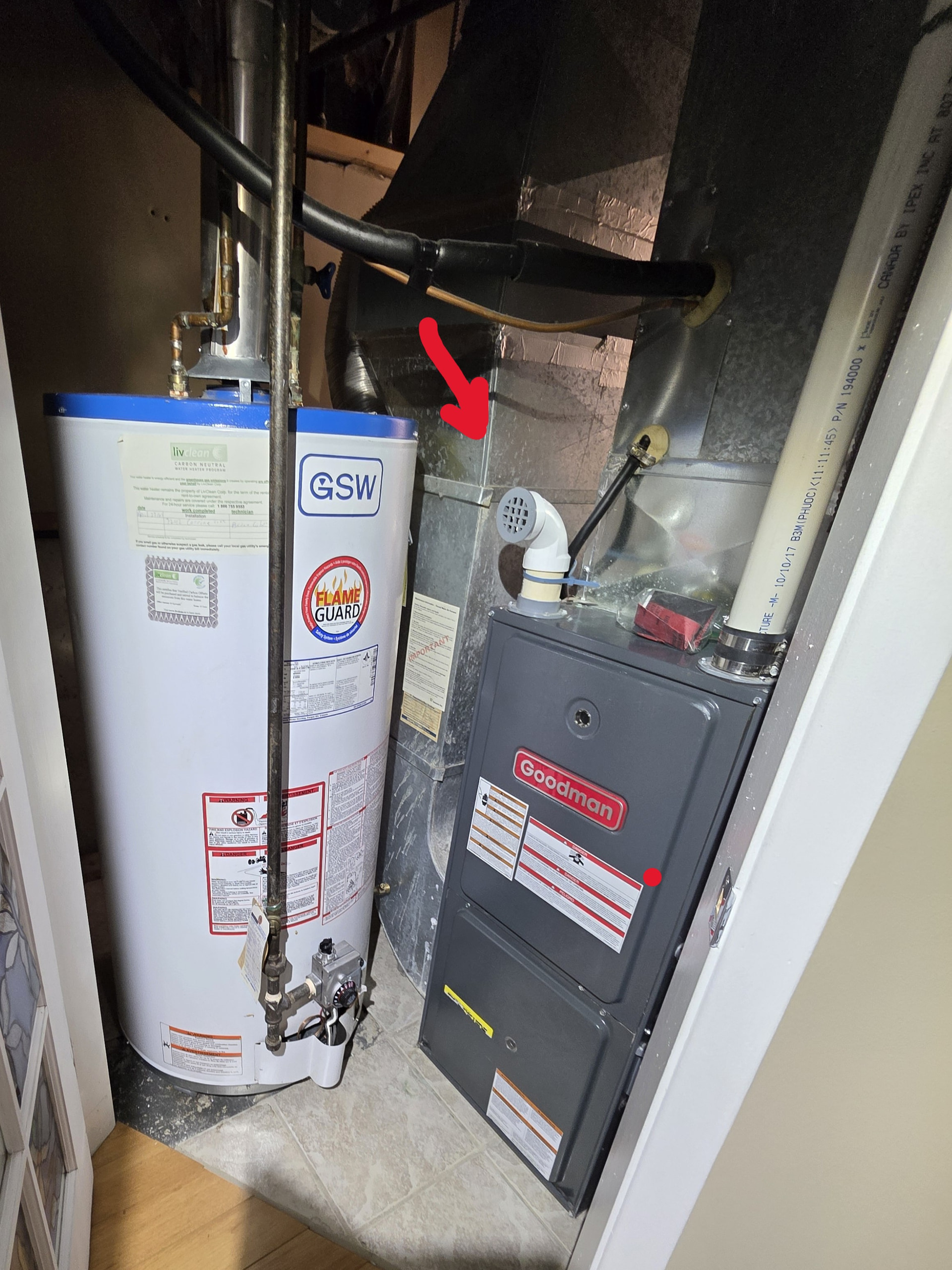

I observed this in one of the inspection today. The furnace is a high efficiency. It is drawing intake air from inside the room. Should the intake air vent not be extended all the way to the exterior? is this a defect? Thanks for you response.

That depends on the amount of make up air needed?
Did you check the BTU rating and do the multiplication at 50 cubic feet per 1,000 btu aggregate input? And, then, verify with the room area.
EDIT: Don’t forget to include the water heater in the make up air calculations.

That installation needs follow up. That water heater has an atmosphere vented flue using a draft hood. If that water heater once shared a chimney with an abandoned furnace, it might be considered an “orphaned water heater”. If that’s the case, it might take only -2 Pascals of depressurization for it to backdraft. If not an orphaned water heater, then -5 Pascals is the limit. The furnace can easily create either of those conditions, but so can other exhausting components including bath fans, dryer, range hood, and so forth. You should alert your buyer to the potential of a serious (but repairable) safety issue being present. Issues include back drafting and CO. Recommend follow up prior to occupancy, recommend a Combustion Appliance Zone test be performed, recommend further testing of the flue and draft, and recommend installing a CO alarm in the utility room and other locations per safety standards. You need to go beyond simply calculating utility room CuFt.
My mind works in crazy ways and I always found it hard to calculate the 50 cubic feet/1K BTU thing….. I just do 5% of BTUs (of all appliances drawing air from the space as @lkage points out). Easier math for me to do on the fly that results in the same number.
Thanks Michael and Matt.

The furnace is located in a mechanical room.
Mechanical rooms act as fire barriers.
a: How does fresh air enter the mechanical room?
From what I remember, high-efficiency furnaces require #1: 'sealed PVC intake and exhaust pipes, #2: drawing fresh air from outside and venting exhaust gases out. Not drawing fresh air from a mechanical room. This is done to prevent backdrafts in tight homes.
That naturally vented gas fired water heater may contribute back drafting.
That’s my wag.

The possibility of back drafting is real. So, I am marking it as “Further evaluation required through a licensed and qualified HVAC technician.”

The quick answer is that configuration is fine if the room has adequate volume. Matt and Larry demonstrated the math. Add the BTUs of both the furnace and water heater. Or does the room have combustion air accessed from the exterior.
Thanks Lon. The unit is located in a small mechanical + laundry room at basement. There is no window and additional ventilation. This is why I was little concerned. Thanks.

Observations: The furnace that @achand pictured takes combustion air from the utility room. He later mentioned that the utility room is small, there is no outside combustion air source, and there is a dryer in there. The water heater has a draft hood. We don’t know if a CAZ test was performed.
Known facts: That water heater venting exceeds depressurization limits at -2 to -5 Pascals. That level of depressurization is very easy to establish. My speculation and a significant $$$ bet is that a CAZ test would fail in that utility room. On my report, the conditions the OP reported would be a Safety issue to be resolved prior to occupancy.
Different conditions: If makeup air was present, or if that installation was in an open basement, I’d probably be happy. If it passed a properly performed CAZ test, I’d be happy. Edit: If the water heater was power vented, I might be happy, or not.
