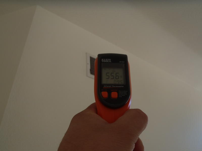

I want one
Its still just a thermometer…just a more expensive one.
Go for it!!! Don’t forget to take Johnnies class and get certified.
Flir says no classes needed though anybody that spent tens of thousands may talk us out of it for good reason.
Heck may not even be good for horse feet.
If it doesn’t need to list resolution or sensitivity… it’s just that good.
To confirm moisture anomalies, don’t forget the $50 moisture meters at the Big Box stores, they are that good as well.
Nothing wrong with the 50 dollar Home Depot model but if spending more gives perceived value then spend away.
The one referred to is used by quite a few guys here. Top Notch and well known men to boot so bad analogy.
Are you referring to this gem Bob? :mrgreen:
The one I was referring to was $50 and started with the letter R and was kinda greenish.

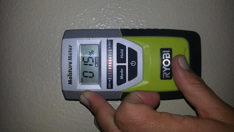

The moisture meter you seem to have a lack of recall for is made by Ryobi and recommended to me by the President of my local who has been in this business for 20 years.
I use that pinless for initial results and confirm with a fine pinned model.
It is possibly the most popular meter used by inspectors as I see it in many pictures on posts.

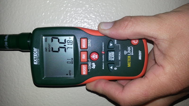

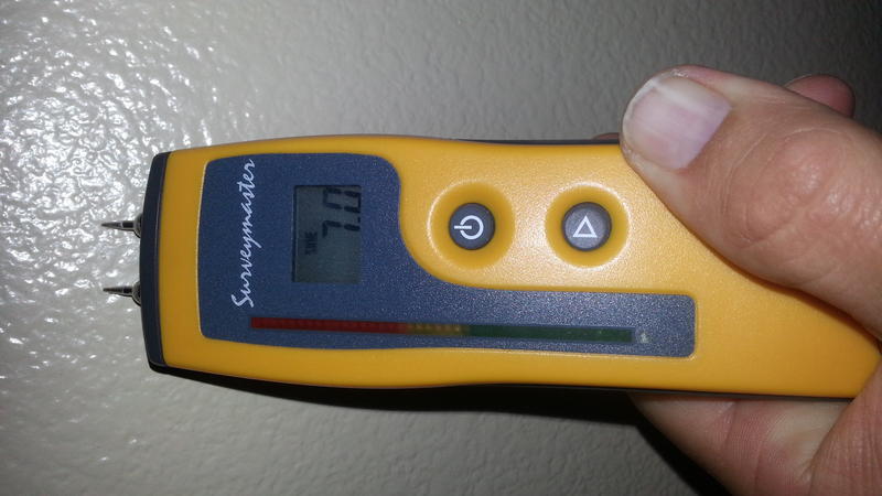

Having used a couple different types, I didn’t think it was accurate. Scanning around a toilet base left black marks and the readings didn’t seem right, right from the get go then and now… I posted some pics from my phone as a comparison.
I measured the same spot on the wall, within a half inch or so. I don’t think the results from the Ryobi one make much sense, IMO. I also think the distance between those pads leave too large an area needing measurement.
You obviously were getting a metal reading at that location.(nails,stud locations,lathing)
Learn to use it properly and you can move it around to see the whole picture.
A pin-less acts as a metal detector as well as a moisture meter.
None of those models showed the same reading which is why when doing this test I use comparison samples rather than worry about exact numbers.
Thanks allot Bob, might be a great addition for home inspections to add a level of added service and information “bling” to my reports. Good way to start using imaging (understanding that this is basic). Thanks for sharing this info, just went on my short list .
You seem to have changed the setting on the ryobi one from one photo to the next, i’m thinking it would alter the reading a bit, no?
Bob,
Nope, drywall, wood framed, in middle of bay. And yes… the survey master were 5 & 7%… not exactly the same, but aslo note… the Surveymaster was in pin mode and the M0297 was in scan/surface mode. On the other hand the Ryobi was 100% on Wall and 15% on one of the wood settings. Iffy
Changed the “Mode” on the Ryobi… Has Wall/Masonry/Soft and Hardwood, used 2… didn’t move the ryobi one iota when when was changed.
