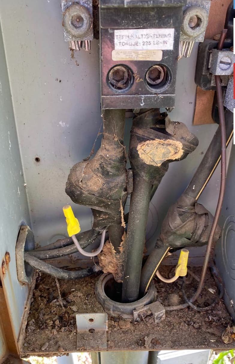

Yes you can splice feeders.
Can they be spliced like this?
Probably not. Split bolt connectors are not listed for three conductors.
I didn’t think so. Thank you.
