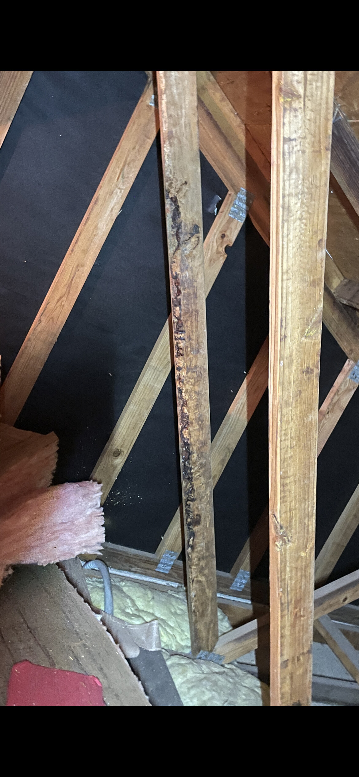

Not a certified mold inspector, but I have indications that this seems to be mold. The wood has deteriorated losing its shape slowly. Was not able to confirm moistness with moisture meter.

It looks like wood wane to me, if that is what you are referring to.
Why not? It looks like you entered the attic well enough and taking a moisture measurement is an important part of deciding “How bad it is”.
You can’t confirm mold without proper testing from a laboratory.
Lol you right I was inspecting someone in my family’s house and they didn’t want me walking deep into the attic I convinced to let me do the wind mitigation this is a mock inspection for practice they are only in that house renting for 4 more months. Ima ask them to go back today so I can walk up and confirm with one.
I will look into what wood wane is thank you
Yes I know that’s true I was just wondering if it may have looked like it and was showing signs of it
I’ll get up closer and show you a better pic so you can see more how bad it is

Alijah, welcome.
Be sure to focus on terminology as you move along your training. I do not see a wood beam in your photo. What you have there is an engineered roof truss system.
I agree.
That’s the bark that somehow remains.
It’s just an ugly 2x4 Lol ![]()

I agree. Terminology is very important. My apologies for the mistake I thought it was a wood beam since it was supporting the roof sheathing. I thought that was a part of a the component of a Engineered roof truss system. I will rennet that though cause I see what your talking about thanks
