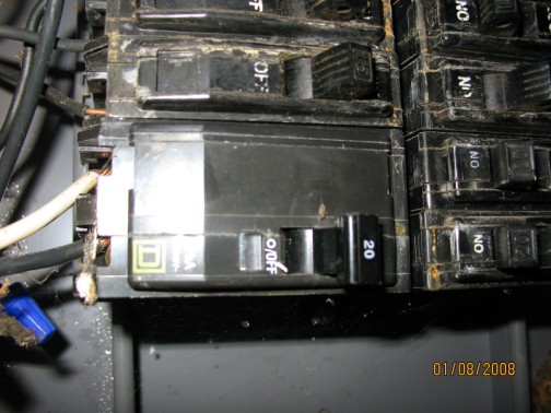

Joe...You will love this one
Found this yesterday within ten minutes of starting and just knew it was going to be fun.
These are the service lines to the ac unit.

Could those two wires, that are tapped to the AC disconnect lugs, be for something in the basement? It looks like there is an EMT “Thinwall” tubing and LFMC “Sealtight” below the disconnect.
I too would be interested in who did this, maybe it was the homeowner or the guy living in the cardboard box house under the tree on the next block!
At first glance I thought the same thing. They were indeed the service wires to the disconnect. The basement was finished so I think what happened was the ac unit was changed out, and since the walls were finished they just did it this way. The breaker size was a 20 amp with 10 AWG wires. The EMT that you see under the disconnect was empty.
The other picture is a j-box with live wires oh just about 6’ off of the garage floor.:shock:
