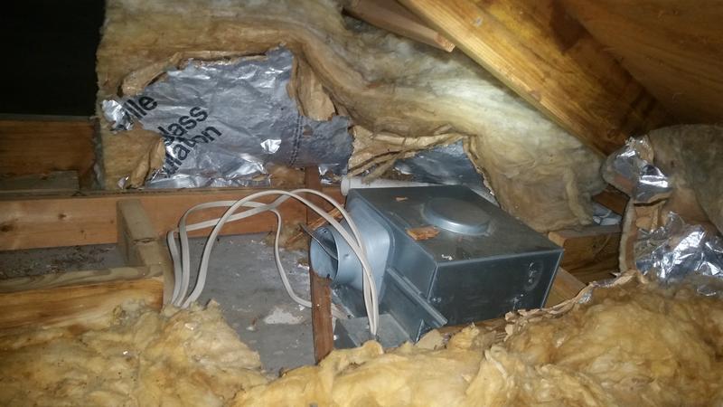

Ok – Here is one from today. I navigated the entire attic while performing a Roof to Wall retrofit and came across this ----
Truss bottom chord was cut with no attempt to redistribute the load. There was also no duct connected to the exhaust.
I know I’ve already stated this before, but if you were the one covering the structure for wind damage and had to write the check?
