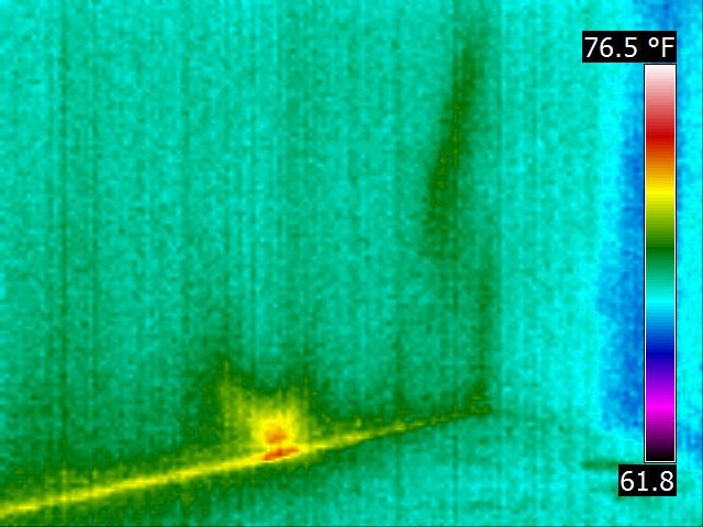

Been using IR on all my inspection and not providing any information to the buyers or agents unless they pay for the service. I shot this in a condo. A common wall 2x4 second story interior. The adjacent unit is the same set up open living room. No adjacent sun light. No plumbing in the areas adjacent to this scan. No plumbing/vent pipes from the lower units. The wall had 2 outlets and 1 cable outlet.
Q. has anyone had any hot wires in walls that looks like this ?
or around the base boards?
room temp 68F.
lower center area on the wall 72F.
streak up the wall 71F.
Best
Ron
Yes, but this does not look like that to me.
If a wire touches or almost touches the sheetrock you will get a definitive line. If it on the correct location of the stud, the stud bay will be warmer throughout.
The geometric pattern looks more like air movement to me.
I agree with David. Appears to be some sort of air infiltration. Was it warmer outside?
He posted that this is a second story so there is definitely a potential heat source below.
It appears that the image scale adjustment has been pushed to the limits so we are not talking about a whole lot of heat here.
I would change the palate to rainbow to see the direction of heat flow. Electrical wiring may show rather consistent across a wider source whereas air flow will graduate proportionately away from the source/point of entry.
David i reset the palette to rain for your rivew.
david i think you are correct. it look like a heat source from the lower unit. may have a small void or a nott in the wall plate…
have another look.
Thanks
Ron

Large difference! No?
Now you can see the deficient insulation in the stud bay behind the Scale!
Another Tip: If you adjust the scale (move hi/lo towards each other) you can get all of the colors of the palette in the scan.

Conductive heat flow travels from warm to cool (your room being the cooler).
The only way to accurately figure out your image is to see whats on the other side or try looking at the first floor unit if possible. If this is not possible, you may want to scan the area at different times during the day.
Three degrees isn’t a huge concern if your camera is set accurately (ie. correct emissivity value set in camera, and a calibration has been performed recently). If this hasn’t been done, you should be careful stating temperatures to clients. Here is an easy way to check your calibration of your camera in the field.

I just grabbed a scan from an open report I was working on and changed it to a rainbow hi res palette and tuned the span to make it look as colorful as I could, as an example.
I would post the digital, but it has personal property in it and I do not have permission to release this photo. Not much to see in an IR.
It is a wall/ceiling insulation deficiency.
