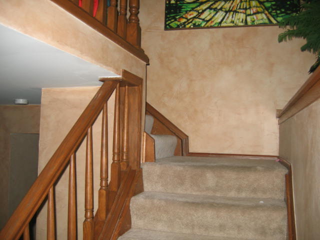

What’s wrong with this?
Handrail does not extend to the full length of the stairs.
No continuous handrail?
As others have said and rail height may also be an issue.
The wall coverings aren’t to my taste, but I’m funny about those things :mrgreen:
Baluster spacing looks old school.
Aside from non-continuous rail, we can’t tell if that is a short wall on the right, or a platform.
