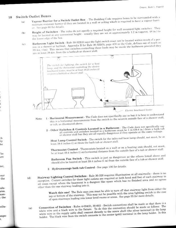

Light Switch Near Shower
http://www.nachi.org/gallery/electrical/fixtures/sunken-tub.jpg Light fixtures are not permitted to hang within 3 foot of the perimeter of the tub (in part) for fear that the metal housing of the fixture might be energized and in part because of these: http://doitbest.com/Cord+sockets-Leviton-model-875125W-doitbest-sku-520243.dib. But how is an energized metal switch plate cover any different?

Have you considered that the exclusion zone for LUMINAIRS may have has more to do with water contacting a hot bulb, breaking it and exposing the filament than the use of an antiquated adapter.:shock:
A metal switch plate cover in a properly installed switch plate is bonded to the grounding system and presents no hazard.
You remind me of the “code inspector” that has to find something to justify his time, so he makes it up to be a pain in someone’s backside.

I would if the metal cover plate was in compliance with 404.9(B). It is very rare that you will run into a metal switch coverplate in this situation. If you do as an HI you can test it with a ticker if you wish. Basically, you are inspecting for events of possibility versus a condition that is present.
I am done with this topic…mixing luminaries with non-metallic snap switches and non-metallic cover plates are insane but HI’s are free to call them out…just be ready for any backlash they may take.

Firstly, If someone DID use a metal cover plate in a location that was obviously near the tub area I would say it is a matter of weeding out the gene pool. We can’t save the world and you can’t fix stupid.
Secondly, I would read 404.9

[FONT=Verdana]So with that said…and what I suggested to you in Colorado is to recommend protection of the circuit on GFCI…rather than tell a person they have to change it, move it when clearly it is not a violation…but again and I will said it LOUD so frank can hear it…if you feel a GFCI is needed then suggest it by all means…but make seller move it and possibly lose a sale because of it then i am sur we might see you in court…THATS what a home seller will say in this kinda market.[/FONT][/size][/FONT][FONT=Courier][size=1]

So Paul,
How far away would you say that metal cover plate should be from the tub / shower area?
Would you not agree that it should be situated out of reach from anyone in the tub / shower for safety reasons ???:wink:

Nope…none of my posts maintain it should be outside of reach from anyone. No one will change my mind on it…suggest GFCI if you wish but no way in heck would I flag someone for a switch near the shower as long as it is not within it.
But please feel free to do what you wish…that goes for anyone here. Just dont look for me to support the choice…lol As for how far away with a metal cover…i did not give a distance…chances nothing as long as it complies with 404.9.
Remember…Canada is Canada…the NEC is used in more countries than just one unlike canada’s code. I understand it is within canadian requirements. Does no make them right or wrong but it does say they made a choice which is not the same choice made in the USA or other countries that use the NEC. BTW- the NEC is a minimum safety standard so AGAIN for about the 20th time…if someone wishes to suggest GFCI I support that with no question because I agree on a potential issue that is in the interest of HI’s safety concerns. However, I do not support telling a client they need to move it…the risk does not outway the cost and compliance is compliance.
I suggest members go with their own feelings, far be it for me to sway anyone. I can paint alot of what ever situations that could kill people but reality is…this is not something ANYONE can produce a real death concern anywhere.
