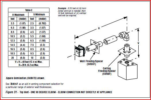

LP Gas Fireplace Direct Vent: Once the vent exits the exterior wall of the home, is ANY horizontal run allowed? If so, what are the limitations? (Manufacturer of fireplace and vent unknown).
Please supply the source of your information. If only an opinion, please state that it is so.
It would have been wrong to terminate where it left building. For direct vent appliances always check the unit manufacturer installation requirements. A lot of gas codes have not caught up to them yet. Looks like a good install to me.
The first chart I posted was for what Lennox refers to as a “vertical vent”. Here is another graphic for their “horizontal vent” and indicates as much as 10’ vertical is needed. This diagram is closer to your real world example.
Here’s a link to a Lennox Installation Manual and you can better understand their requirements (which vary by model and might very well be different than other manufacturers of course).

That is actually my primary concern, that none of the Manufactures seem to address in their manuals… the horizontal run on the EXTERIOR of the home. They all address INSIDE the home. There is basically 18ft of exposed venting to the elements. (Akin to uninsulated venting through a cold attic, only worse). The system looked new with no indications of any condensation or deterioration… YET. Connections, hangars, slope rise, vent cap termination height and distance to vinyl siding, everything looks professionally installed, but I just can’t get my head wrapped around it. It continues to bug me, and a few more calls on Monday may be in order. I want a definitive answer on this. I don’t like ‘gray area’ reporting!
