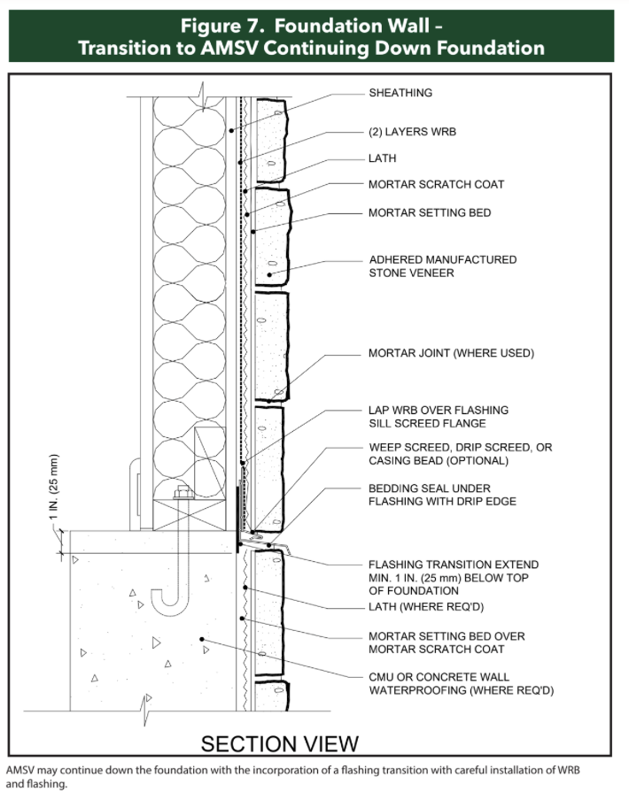

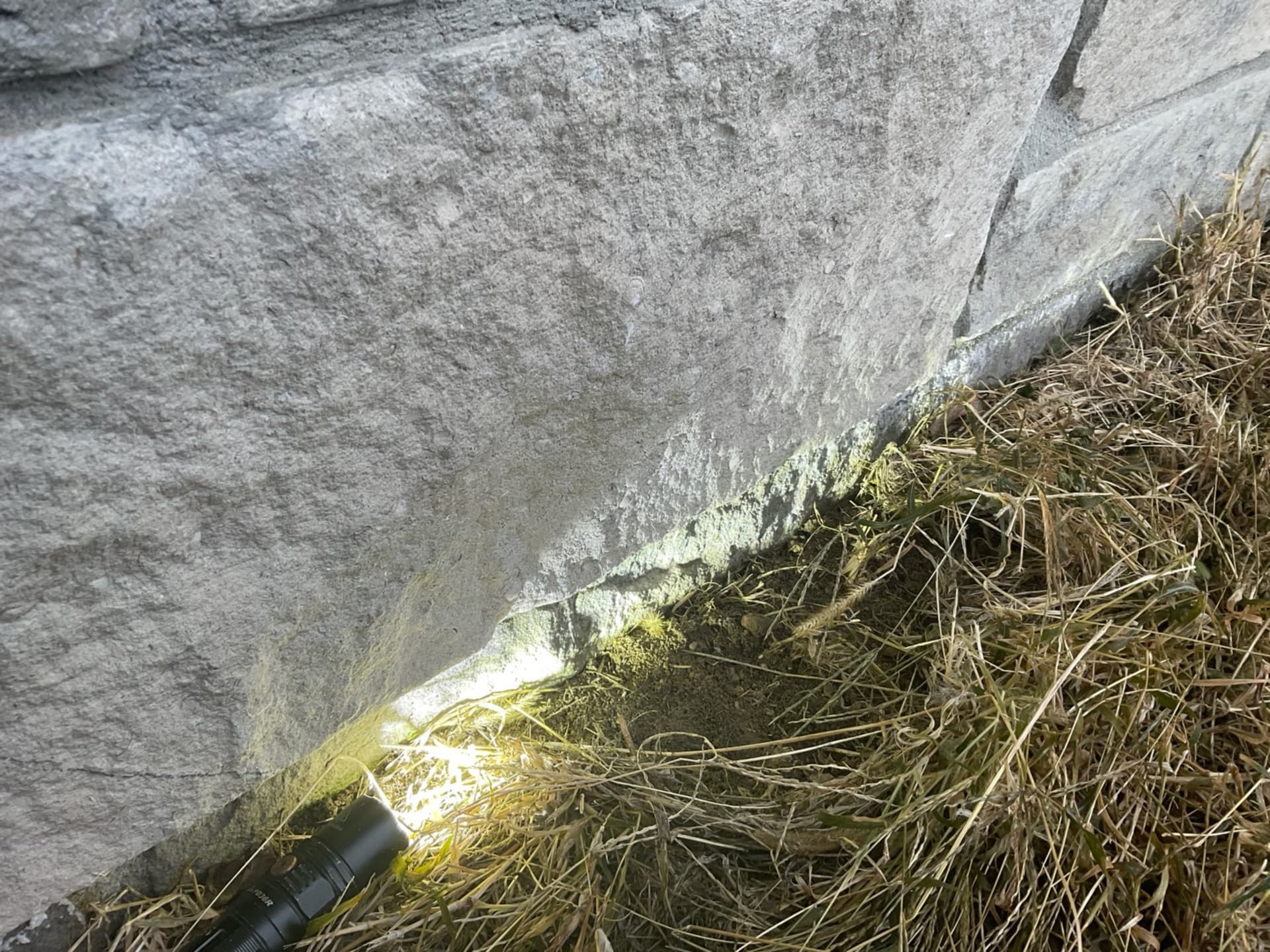

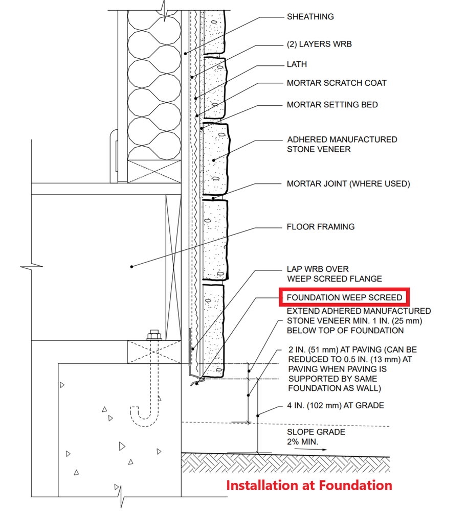

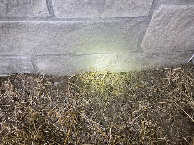

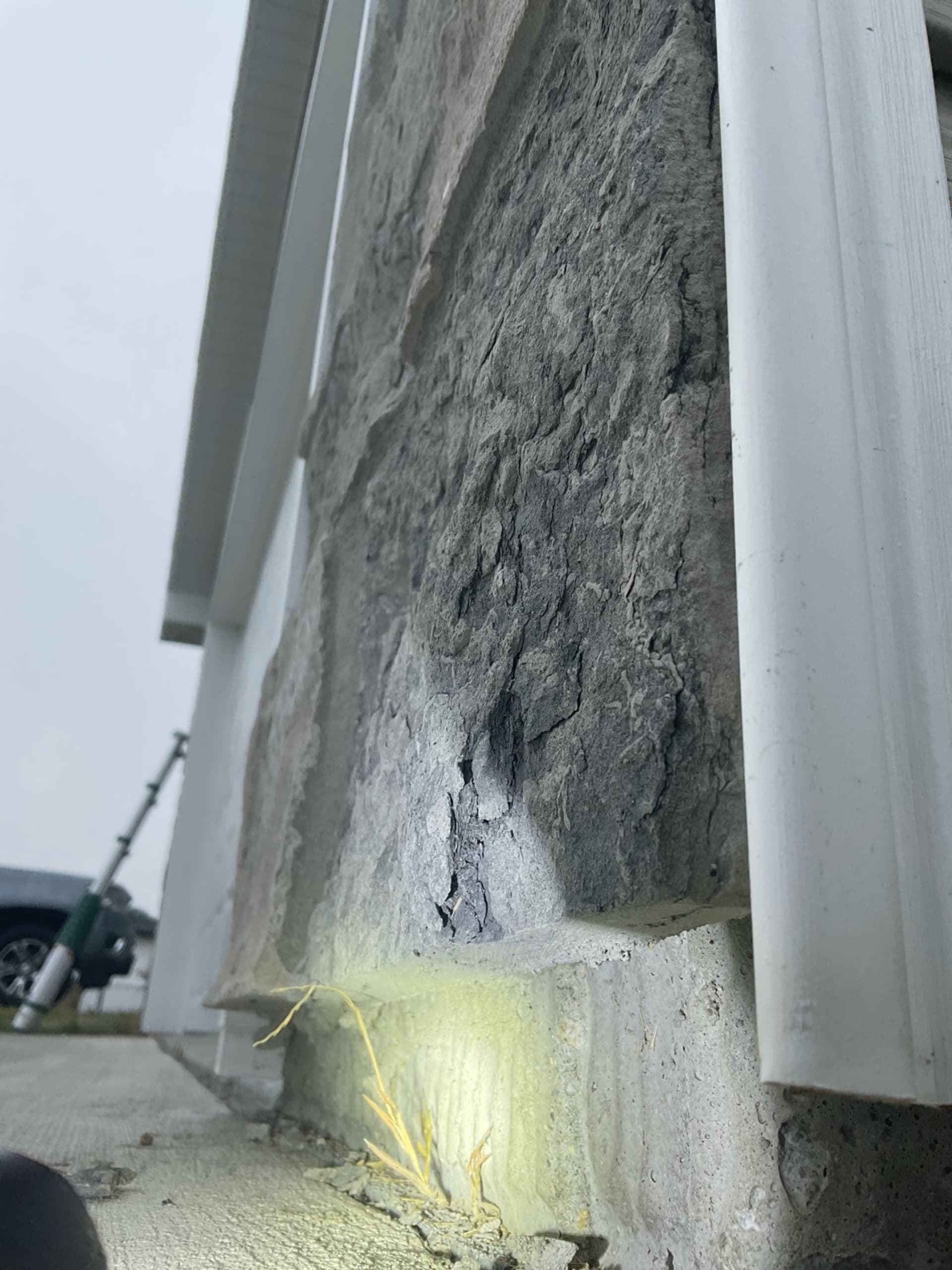

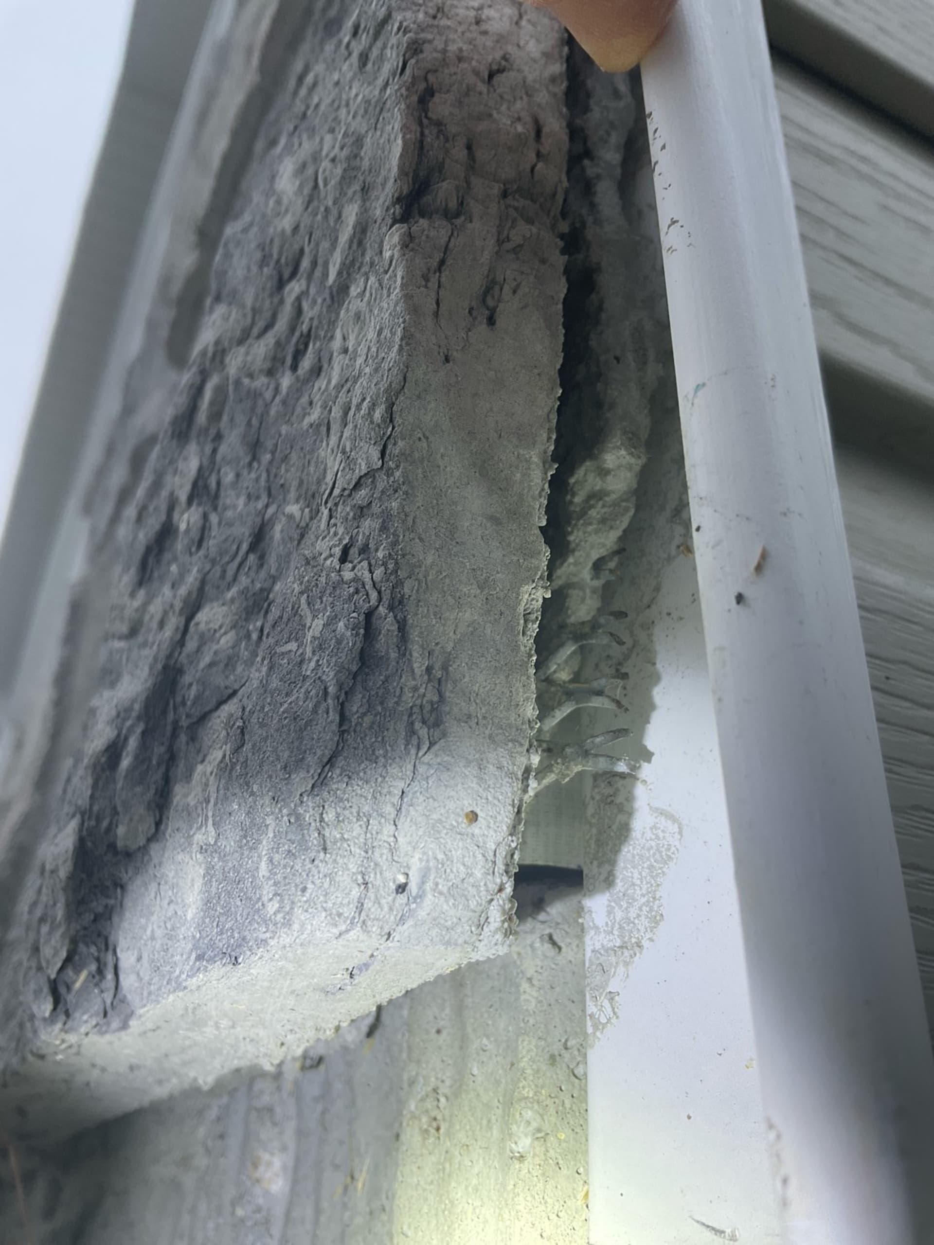

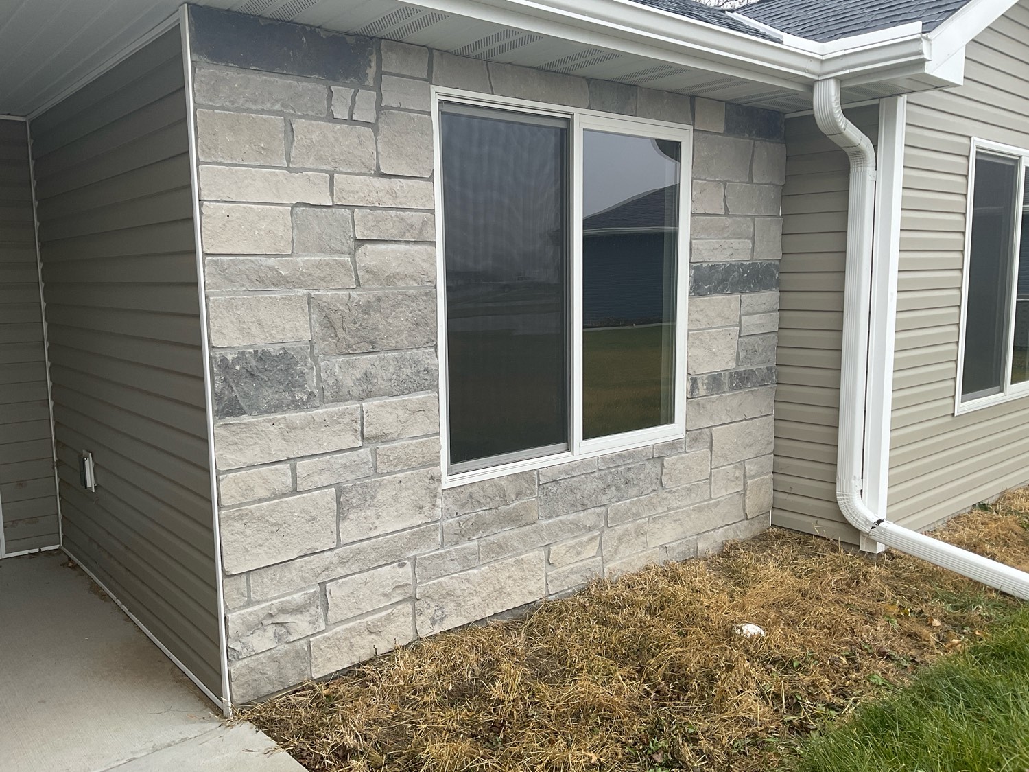

It is rare that I find a weep screed at the base of AMSV (stone veneer) over wood framed homes. Also I have never seen a 3/8 expansion gap with backer rod and sealant when the stone abuts an exterior door, window, trim and different types of cladding. Literally every inspection I am calling it out as a defect, and every single new build on the street is missing this expansion gap at the windows, doors, trim and different siding (EG vinyl).
The local AHJ is obviously not requiring these details on the AMSV and I feel like I am kicking up a fuss with local contractors and realtors when I follow the instructions of the MVMA 6th edition. The MVMA 6th edition can be viewed at MVMA-Installation-Guide_4th-Edition-6th-Printing.pdf - Google Drive
At what point does a “generalist” stop reporting these missing details as a defect if the local AHJ allows it? Typically most of the stone is only at the front elevation, and the entire house is not stone siding, therefore they are not requiring these details.

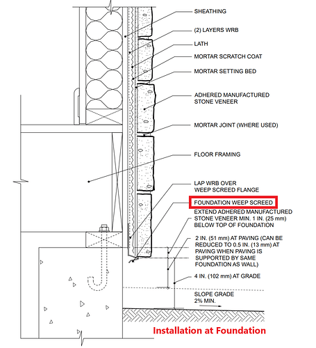

I clearly see these details are required according to major stone manufacturers like Eldorado, Centeron and Cornado stone who all say they follow the MVMA 6th edition. Therefore, I am very curious to know how often everyone finds these missing details on stone veneer and if an experienced inspector is not calling one or more of these details out ? Specifically missing expansion gaps at windows, doors, trim, siding etc… and missing weep screeds?

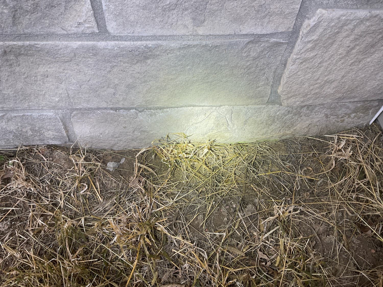

No Weep at garage on small section of stone.
I would greatly appreciate any feedback from an experienced inspector who has seen many installations of AMSV. Thanks!

Looks like you have a good handle on it, backed up with industry standards per the manufacturer. Chapter 7 of the Code has more references if you want more backup. ASTM C1780 or The Masonry Society TMS 402 and 602 have more backup.

In those instances I just note that the installation doesn’t meet the manufacturers requirements. There were no symptoms or conditions of failure at the time of the inspection. If a product or installation failure occurs, the warranty may be affected.
Regarding veneer stone, In Colorado we’re a very arid climate and I routinely see shortcuts from the manufacturers installation requirements and usually don’t ever see failures, even in 20+ year old installations. I think the climate just doesn’t require the measures that have to be taken in other areas of the country and our AHJ’s seem willing to overlook those departures from the “standards”. I just want the client to know it’s wrong and what the consequences may be but to also temper that with the local conditions are that lead to these oversights by installers and AHJ’s.
Thanks Mike. I am not looking at manufacturers specific requirements as I have no idea who the manufacturer is most of the time. I use this statement in my reports: “Any and all deficiencies referenced in this report were based on the MVMA 6th edition.” Just incase a manufacturers instructions may differ.

I agree with both Larry and Michael. The Building Codes will defer to the manufacturer installation requirements. I do not attempt to identify the manufacturer of the material unless markings or documentation is at/with/on the materials. As a result I will cite the Building Codes and industry standards and add a phrase similar to this.
The manufacturer and model of this material could not be identified. I recommend you have the Builder identify this material to you and provide a copy of the manufacturer’s installation requirements documents so that the issues found can be verified as present or correct as per the manufacturer’s requirements.
