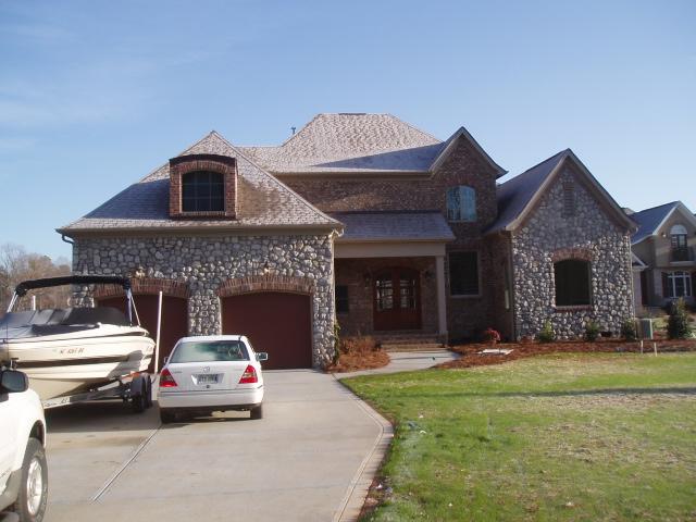

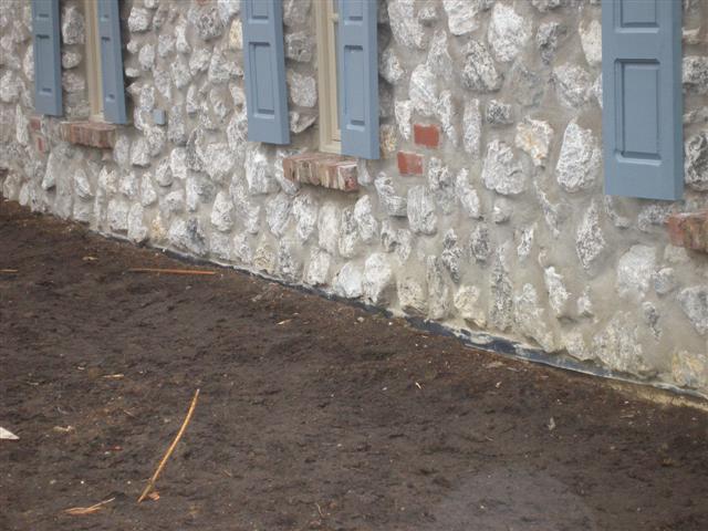

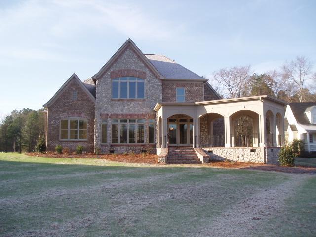

$800,000 custom house. Brick and stone veneer. No weep holes. Has been under construction for 1 year. Not yet occupied. See the pics of water damage.
P.S. Are weep holes required for stone veneer? Didn’t see them there either.

I don’t think this is cultured stone. Weep holes required in a wall like this?
http://www.luckstone.com/arch/designguide/schematics/index.php#
Maybe some of these details will help.![]()

What is on the house for moisture barrier?
And at what location did you find the moisture! Under a window maybe?

I saw one today and checked it out. It had weep wicks every 8 feet.
Ah yes, the old witch, ah I mean the old cotton wick.
Yep, I remember those, actually they old wick oil lanterns used to work pretty good with those.
The only problem with the wicks is that people kept leaving them in and not pulling them out.
The whole concept was to use the wick when starting the masonry, and at the end of the day or during, they get pulled out. Thus creating a tubular hole to let the moisture out.
But, you always get the crowd that fails to follow through. Oh well. what can you do.
Hire a NACHI Inspector to educate the Clients.

I that an OSB sill plate? That ought to explain alot.
No. The OSB was the wall sheathing. The sill plate only existed over the pilasters and you can see a bit of them in the corners of photo 3 & 4.

I got a call from the client today. (She is also a big time Realtor.) She sincerely thanked me for the thorough inspection. She said I “saved her life” as she has breathing problems and thought the potential mold issues would be a concern.
She said she did not use infrared, as I recommended. She had holes cut in the walls. She said that the OSB was wet and black to within 6 inches of the 1st floor ceiling. When I asked what the builder was doing about it, she said he had fans blowing on the walls to dry it out. (Sound’s questionable since not all the sheetrock was removed.) She asked me what I thought about that. I said, “would you knowingly build a house with water damaged, black OSB?” She said, “no”. I said, “Neither would I.”
Told her issues to consider: 1) they need to figure out the cause of the problem, as the condition existed in several areas behind the stone and brick. 2) Was the wood too heavily damaged to be used in its current condition? 3) Would there be a potential mold issue if things weren’t thoroughly dried out?
I asked her how the water was getting in, and she wasn’t sure.
My advice: hire an independent consultant to review the building method and the builder’s plans for correction. Gave her the name of a GC and a Structural Engineer.
Feel sorry for her. It’s her property–lake front beautiful lot. Custom house. She can’t “back out of the deal.”
Right track with my recommendations?
Can’t back out? Sure can, on the grounds of breach of contract, i.e., not built according to manufacturer’s spec’s.
Yep. Manufacturers and architect and builder’s plans.
