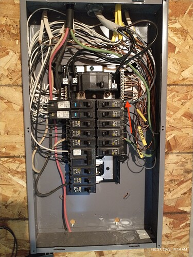

Modified Connector Bar
Yep! But MP beat ya to it. So you (and him actually) get nothing!
There was some goop on the grounds. Looked like paste or similar.
Here is what I and maybe JR was referring to…
Yeah, that’s the goop. Looked like the sparky spilled the antioxidant paste around a little.
That’s why I asked about the feeder OCPD, those conductors are clearly not rated for 100 amps. Looks like #6 Aluminum which is fine with the 50 amp circuit breaker.
Your eyes are better than mine, especially on this panel. From here it looked more like an arch burn than a smidgeon of goop. But hey, that’s what we’re here for and to learn from… :wink:
Same here… The photo was a little blurry there, when it was zoomed in. :slight_smile:

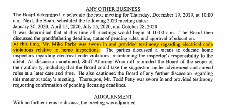

I’ll go find the original verbiage and post it and the changes. Please don’t choke laughing.
Note the change to readily accessible!
“U” is now “T”
Here is where I educated the OHIB:
