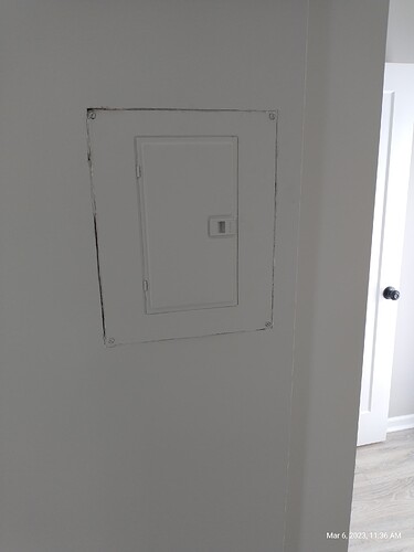

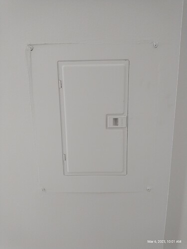

I got the seller’s permission to chisel this one out of the drywall earlier this week. I didn’t find really anything major in it, but I wanted to make sure for my young, first-time homebuying client.
Done and put back on…

That’s a best practice. Usually, the seller isn’t around to ask. I just cut them out and make a modest effort to clean up the mess. One seller (ever) complained about the chipped paint around her panel, to which I replied that panels are not supposed to be painted and sealed into the wall and thanks for reminding me to put that in my report, too.
