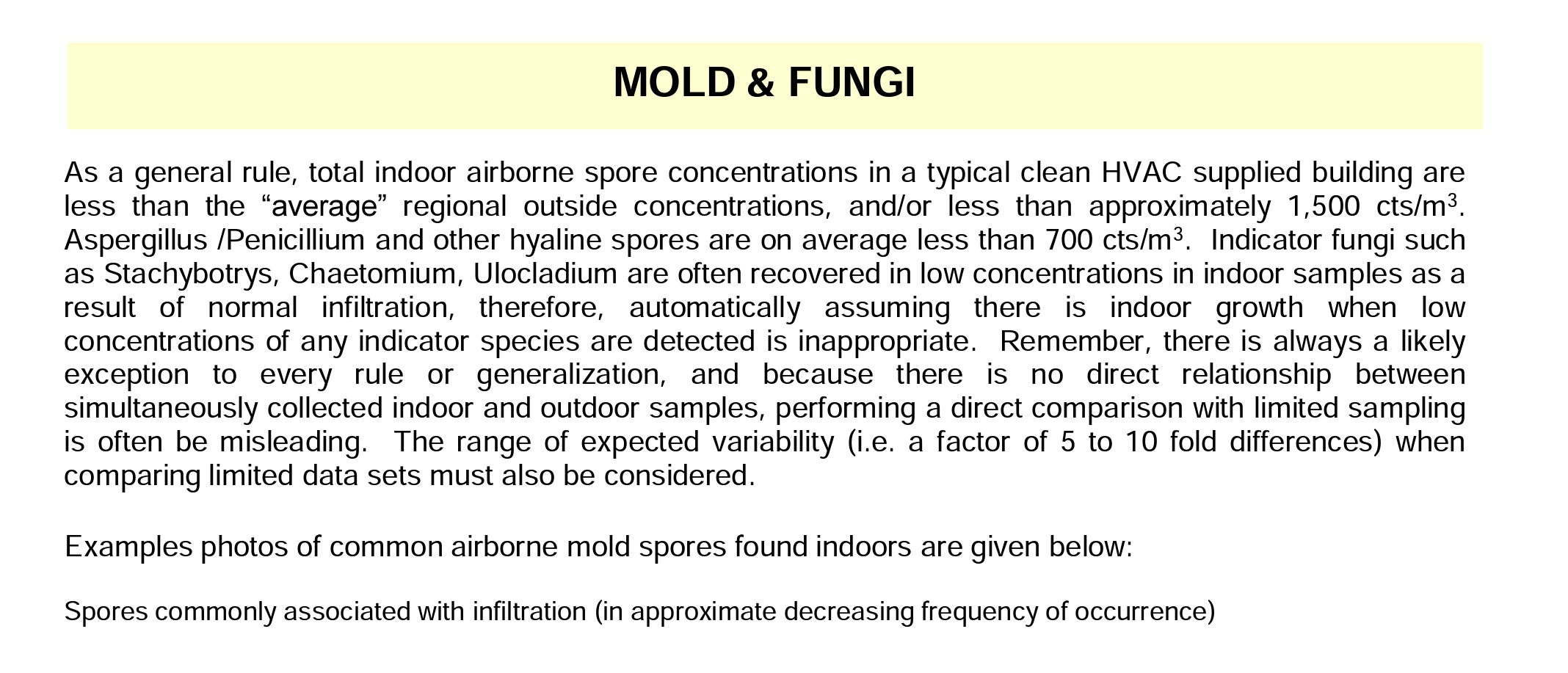

I don’t see how any true value can be obtained only doing inside.
For example, penn/asp is quite common & can be more than 600 spores/m3 naturally inside. If there is no outside sample any assumption could be very inaccurate.
I’ve seen counts come back pretty high inside, but the basline control was much higher. You just do not know.

If you get an indoor spore count in excess of 5000 spores/m³ would it be considered problematic, even if you don’t have the outdoor sample(s) for control? I don’t know the answer. I’m curious if anyone knows.
I’m not a mold guy, but wouldn’t it depend on the type of mold spores?
BUT, there is this:
Problems with indoor versus outdoor spore counts - comparing apples to oranges … A count of 200 Stachybotrys chartarum mold spores / M3 of air would be unusually high … What indoor mold spore level is considered “contaminated” then depends in part on what … Airborne Mold Spore Counts under 5,000 spores per m3.
