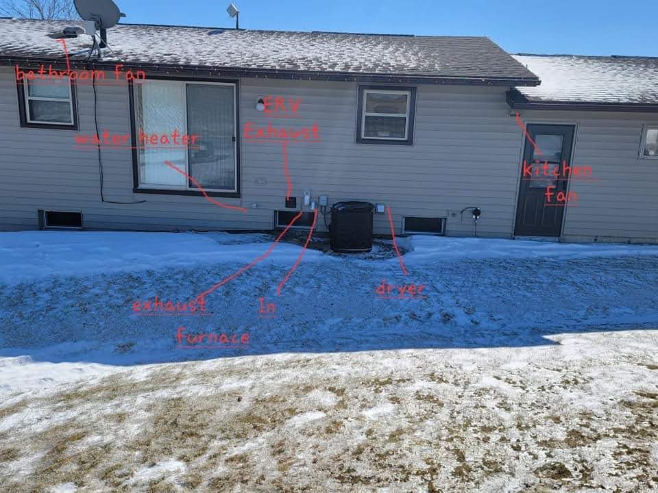

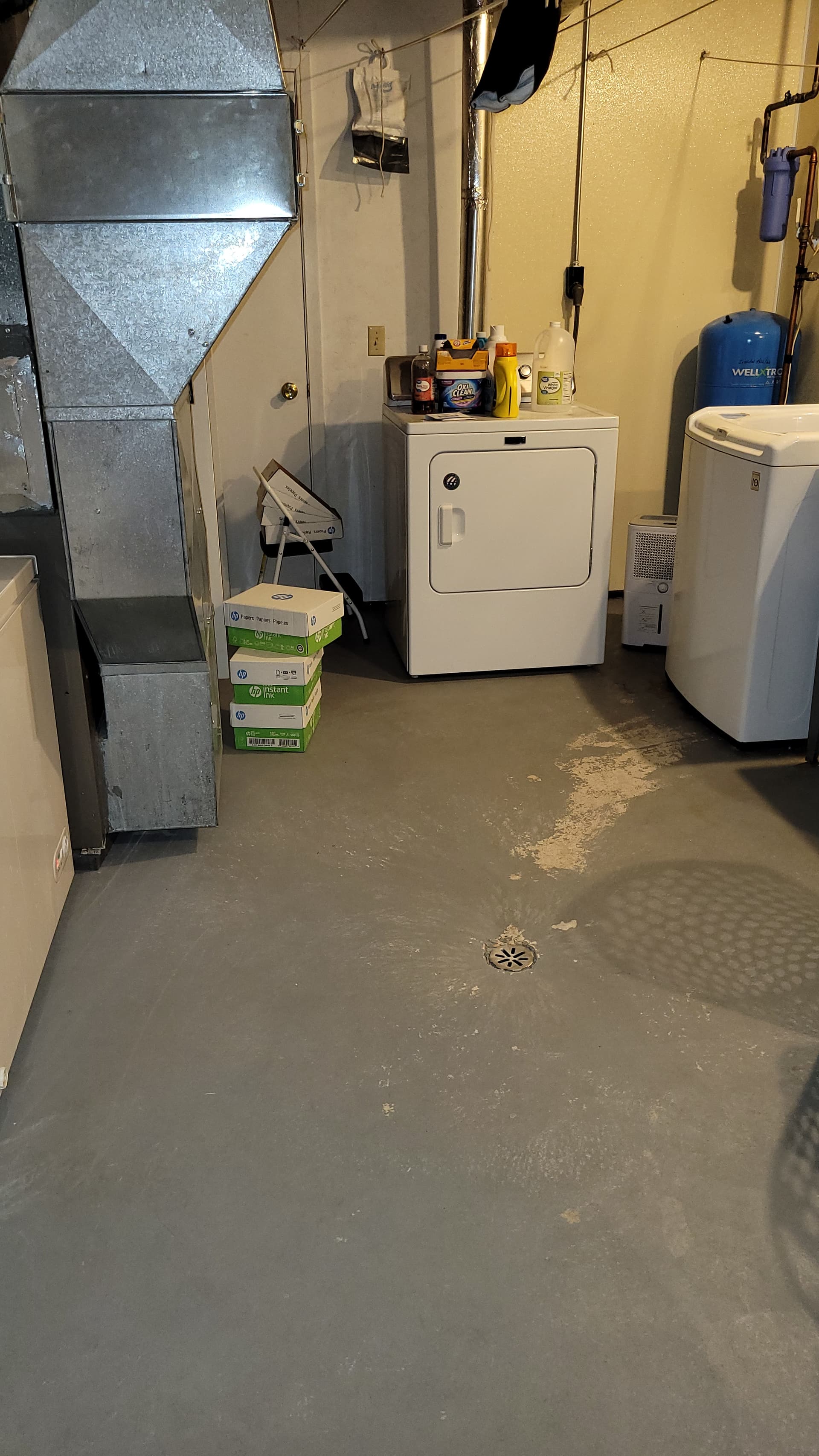

In my opinion, this water vapor that is very evident as i take videos with my phone anywhere in the house, watching it seep out of baseboards and see the worst of the rooms to be my laundry room, is coming from the dryer itself. If my dryer is too backdrafting as the other two appliances are, wouldn’t it make sense as to where this vapor type of matter has come from? My clothes come out too hot to touch upon a cycle ending. We conducted simple “toilet paper tests” with holding them to the outside venting of the furnace and water heater, as well as around the fan of the gas powered water heater inside, to have them all show our peices of toilet paper being sucked up to the exhaust pipes all by themselves. More so upon the kitchen range and bathfan being turned on. The toilet paper peice we held up near the fan of the water heater inside of the house started blowing outward. This water heater seems to be pulling air in when its not even running. CO2 levels are high anywhere i go in the house as i took readings with an air monitor i received from my furnace company to use for some time.

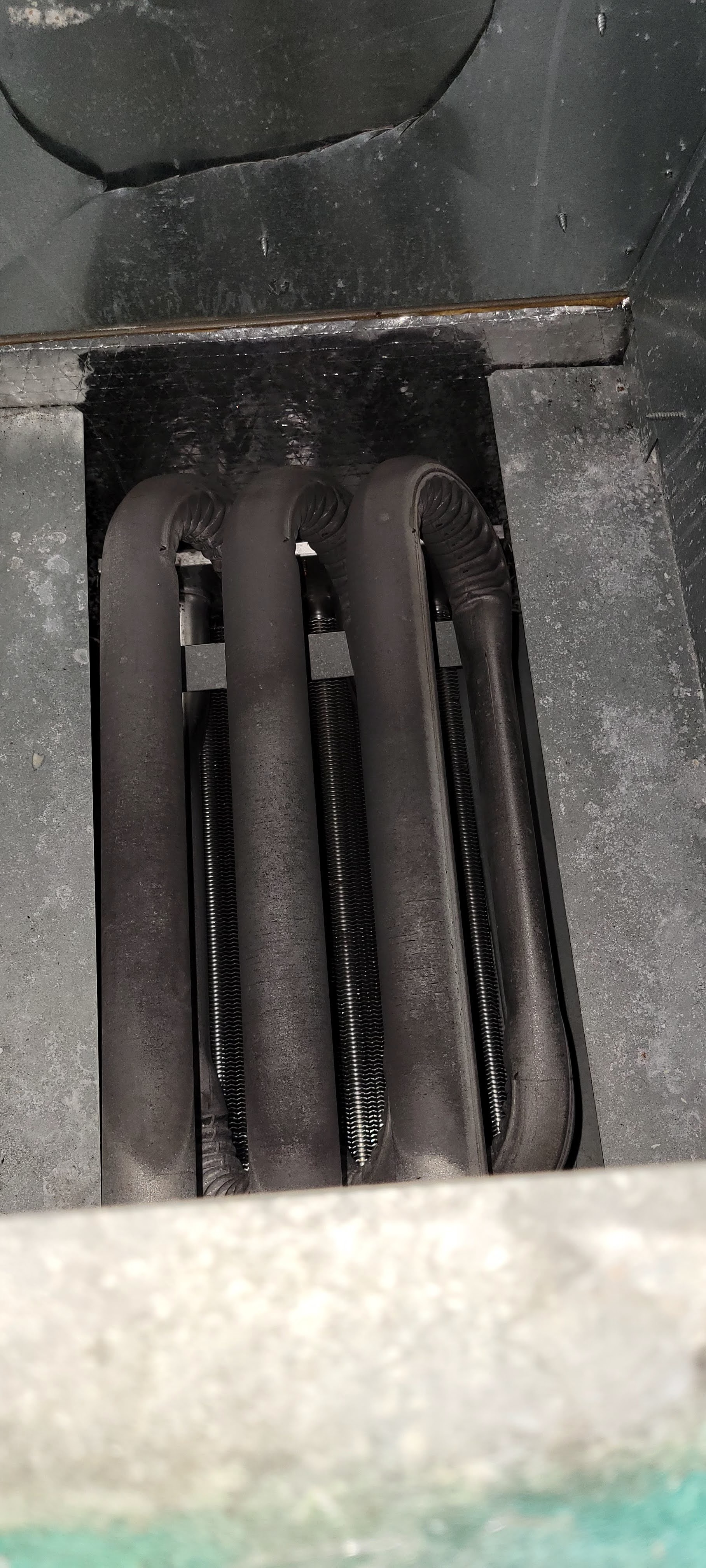

Photos of my furnace and heat exchanger appear to be so moisture ridden, it looks like a smog filled mess in there, with debris as well. Corrosion is what it looks like, with bits of black stuff that has a distinct shape to them. Which are the exact substances i am seeing in my carpeting and vacume. Just so you’re aware, our A coil and entire AC unit was replaced last summer. Due in large part to not being able to keep up with dehumidifiing the house i believe. Our electricity bills have never been higher, and are still to this day showing as being 60% higher than previous years. We have also went through nearly triple the amount of LP.

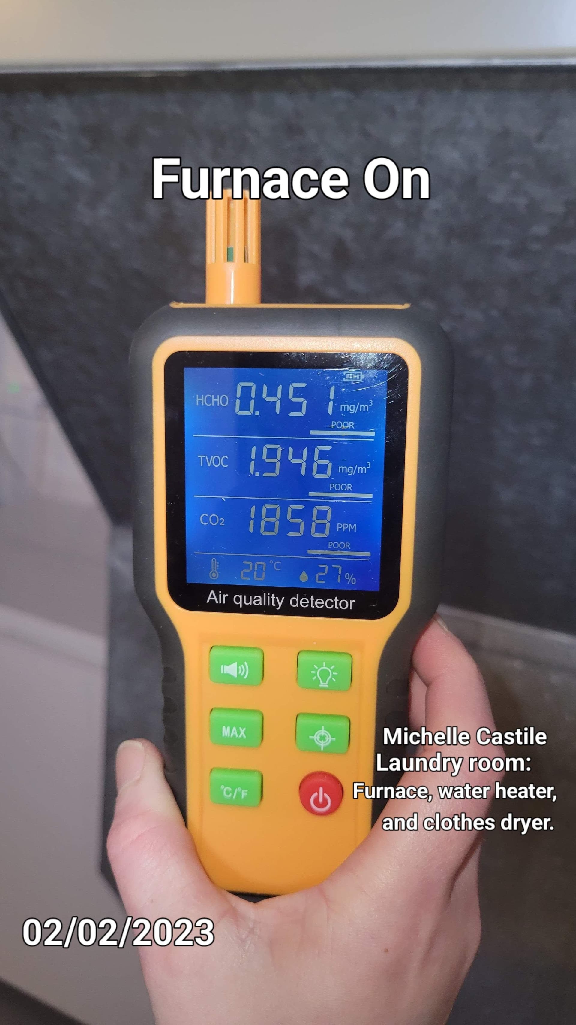

RH readings are around 30 this time of year but I’ve seen it as high as 70 as it read in my laundry room during the summer months. The fruit cellar, which is always colder, became humid the first year this started to occur. The floor in the laundry room is painted cement and shows many areas of staining in odd areas and markings of lines. Like air flow trails, which is exactly what is occurring in my carpeting in every single room, air flow lines of this stuff, packed with the sandy-like substance that is every where and in everything. These lines come from the walls as well, and also run along the lines of the marriage line of our modular home. Perhaps this negative air pressure has caused air to flow backwards from the attic up through the marriage line? This does lead to the attic somewhere, correct?

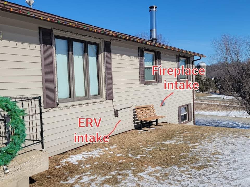

Is this thing not installed correctly? The ERV? This has been mentioned previously by someone, then again the Renewair company says its perfect. :woman_shrugging:
Appliances are backdrafting still to this day. The water heater upon it not running is when this occours. More so when fans are turned on such as bathfan and kitchen range.

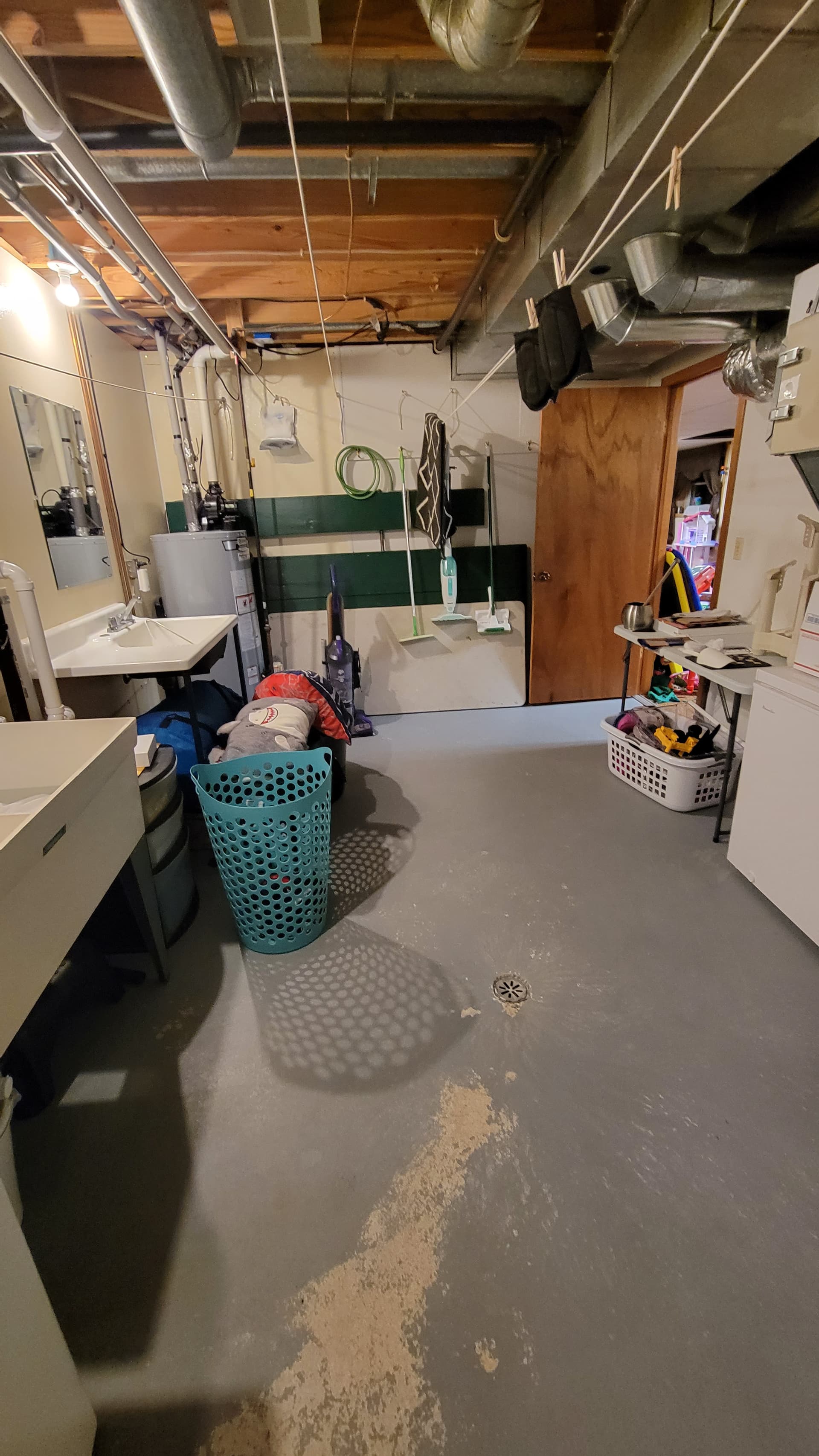

I tried calculations for BTU amounts and i don’t know what I’m doing. I did take these photos of my laundry room though. Where all three appliances are at, furnace, water heater, and clothes dryer. Also ERV.
For sure the furnace and water heater are backdrafting or pulling air backwards from our owb testing. Please read my posts that explain this in more detail.
