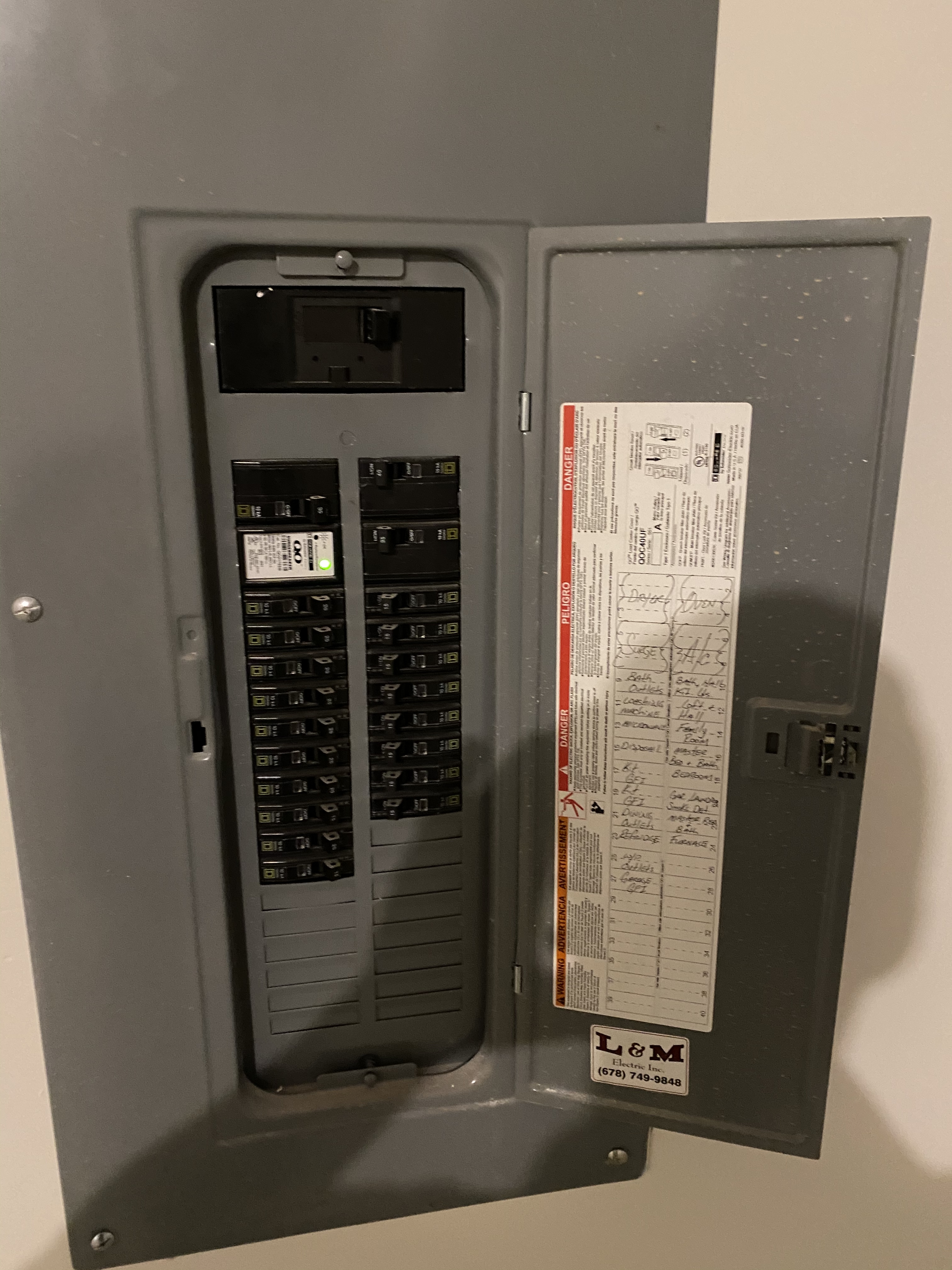

New Construction- Missing GFCI
Lol done and done :ok_hand:t2: Sent the report before creating the topic but was curious if it was a wild miss or common defect on new builds

What kind of circuit breakers were protecting these circuits?
Nothing closer up of the actually breakers.
No AFCI protection either.
Is this home in an area with no local jurisdiction, city or county code authority?
It is not, there are local and county code enforcement agencies.
Then I would refer to whatever year of the NEC they are using. For both GFCI and AFCI requirements… You probably already new that, just saying.
I wouldn’t refer to the NEC. I would make a recommendation and they can do it or not.
Call L & M and ask them if they are installing AFCI/GFCI in their new installs :slight_smile:
Remember, these breakers are $50 a piece vs $10
But at least in my area new construction is supposed to be built according to the local codes. And the various AHJ’s in my area use numerous different years of the NEC. So if the Builder wants to argue about it you have that.
Good point on new construction, as the title says. :sunglasses:
