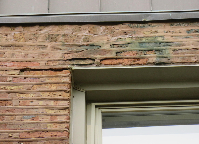

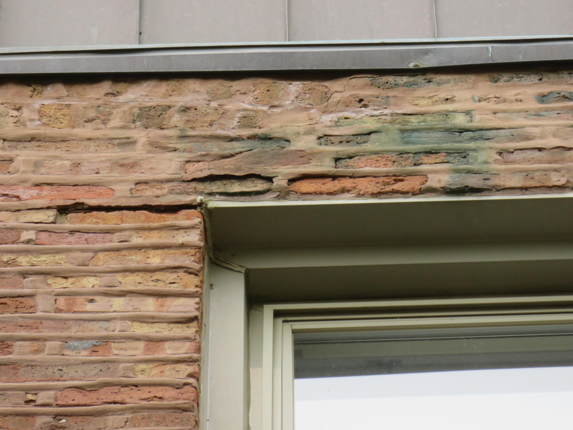

Saw a building, this morning. Old (1920) 3 story 6 unit apartment building that was converted to condos in 2005. Added 4th floor (copper standing seam) and put new stone fascade. Every window and door lintel covered with the window cladding and the lintel spaces caulked. Water intrusion over the windows in every unit. The old Chicago brick was parge re-pointed (no grind out, just parge a convex joint over the old. They also sand blasted the old brick. Spall city.
Not a pre-purchase inspection, but a water intrusion inspection.
More from the same building.
What a disaster.
