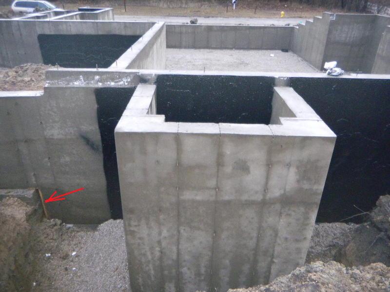

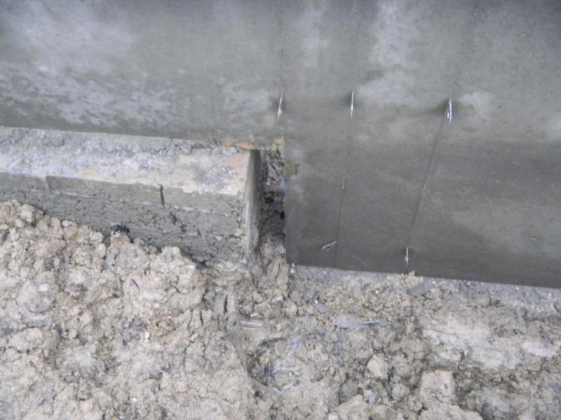

I inspected the new poured foundation today for new construction. I noticed under the garage poured foundation wall there is a structure built and a gap on one side. Is this normal, and why would be there? The built structure under the foundation wall is mostly covered with backfill and the footings are not visible on exterior.

Michael, it appears that was left out on purpose. Usually, with this type of form system and the fillers used for the step down footing, this gap would have been filled with concrete.
With the form panel layout that I see, and evidence of a piece of wood on the footing, the gap shown was created with a piece of foam in the form system and then removed.
They might have intended this to let water go out or in or whatever.
Not normally done for water. PVC sleeves are cast in the foundation for water release or passage.
The form ties should have been broken off and patched. It appears the was was sprayed with something due to only the fillers that I see with the ties.
Those are alluminum form system from Kansas City, Missouri or similar.
The ties look like this;
You are correct on the ties!! And there is a framing member present, which made me think it was purposeful, and you jogged my memory, about 6 feet to the right on the other side of the wall there were styrofoam forms laying there. They are removing the ties, they just haven’t done all of them yet.

they might not have had step down fillers for their forms at the step downs. Sometimes called jump fillers. They are panels with holes every inch to drop down the panels at the step footings.
In this picture, they added wood to compensate.

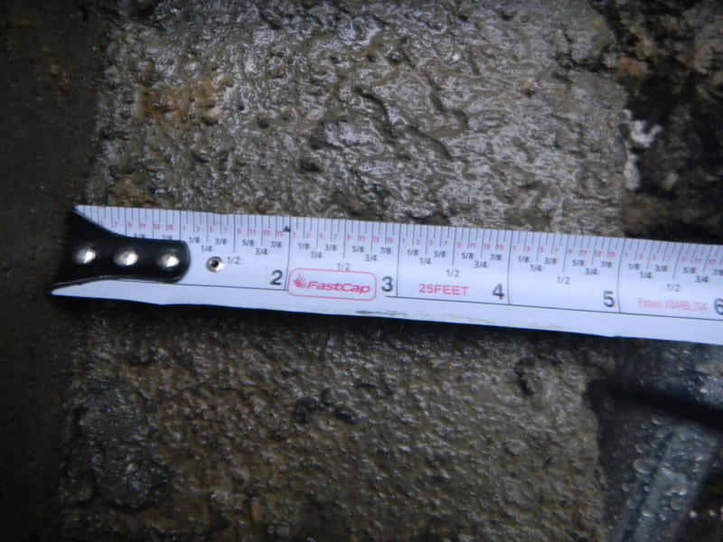

I think I did him a great service. The walls are 10 inches thick, but some of the exposed footings on the interior are only 2.5 inches, which would make the footing only 15 inches wide, or the footings or foundation walls are off center. Plus he had several cold pour joints, although it may not be a structural issue, they could leak and he is having the basement finished by the builder.

My references show that the footing width should be twice the foundation wall width. And most of the footings measure at least 5 inches from the wall in the interior and exterior, which would make the footing 20 inches wide with the 10 wall width.
