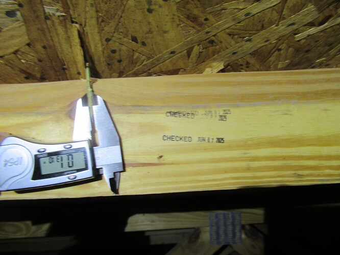

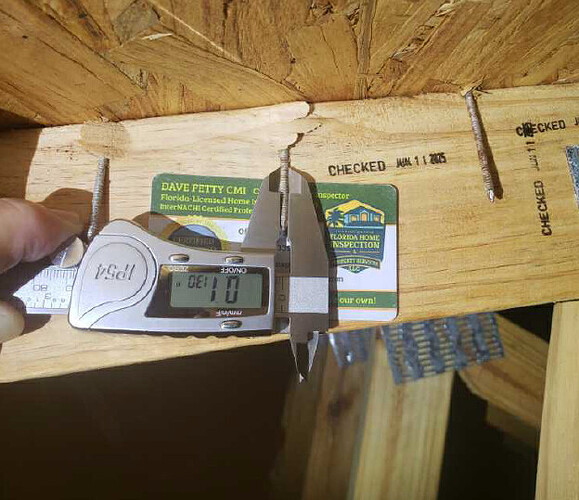

Nice, correct sheathing installed with the correct fasteners. Rarity in this area.
Good article about (mostly) shingle fasteners not being properly driven by pneumactic devies.
Dr. Prevatt is mentioned in this article making reference to roof sheathing nails being over-driven which caused failures.
Well, they used the right nails with the 19/32" roof sheathing. Too bad it’s OSB used with the concrete roof tiles.
Oh boy! Quadruple whammy, Wrong roof sheathing thickness, wrong nails fastening roof sheathing, OSB used with concrete roof tiles, high profile tiles have only one screw installed. SMH
This new SW Florida home costs more than $1M, unfortunately it seems the builder didn’t properly supervise the project and the roof was installed with incorrect roof sheathing fasteners.
At least they used 19/32" PLYWOOD (not OSB) as roof sheathing for the concrete tile roof.
Wrong nails and wrong sheathing OSB installed with concrete tile roof. :roll_eyes:
We watched them build these moderate (for this area) priced duplex/villas. I was pleasantly surprised to see them using plywood for roof sheathing. I wondered aloud “are they using the correct sheathing nails”. Got to inspect one today… Hot dog! Winner, winner!
Some builders do better than others, hat tip to Dr. H on this one. Still plenty of other issues but at least they got the roof sheathing and fasteners right.:+1: It only took them 5 tries and 6 months to figure out how the shower was leaking into the closet.:roll_eyes:
Oh boy, wrong nails used for roof sheathing fasteners. again.
Not to mention OSB used with tile roof.
