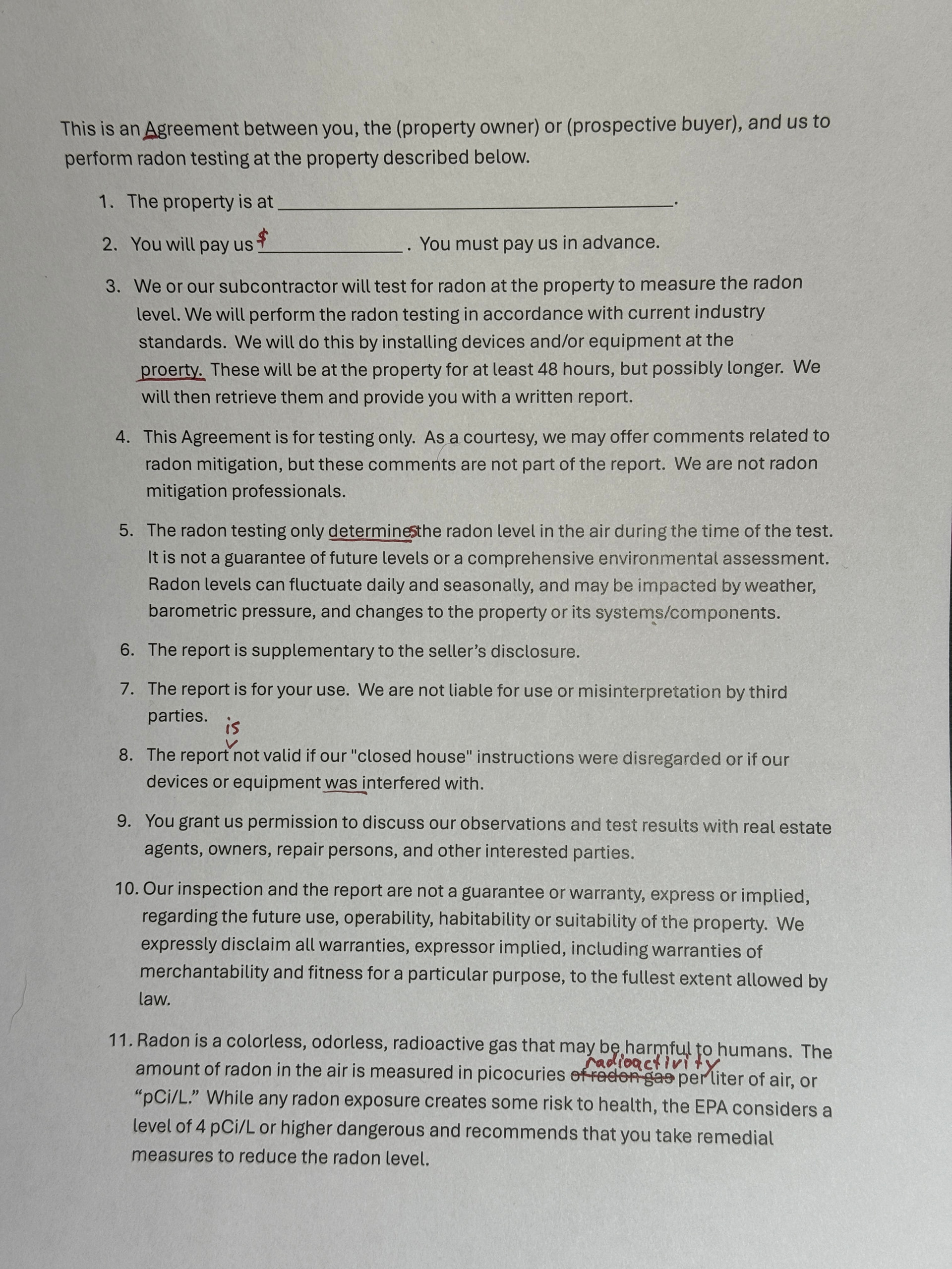

Released today: InterNACHI's Radon Testing Agreement
The updated agreement is shorter.
It also works with all types of radon testing devices (charcoal, E-perm, continuous monitors).
It also works with commercial properties.

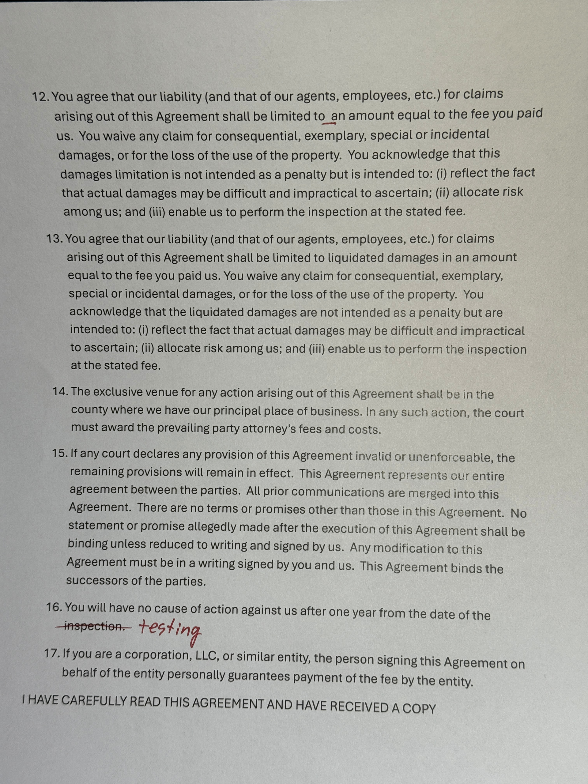

Thank you Nick and the Team for the updated contract.
I would like to submit for your consideration a few revisions to this document you gave us today.
On the first line, “agreement" has a capital “A”
Item 3. spelling error 4th line: “property”.
Item 5. fifth word “determines”
Item 8. “The report is not…” “equipment were interfered with.”
Item 11. Change “of radon gas” to “radioactivity”. It’s a technicality, but we are not measuring gas. I live 2 miles from Oak Ridge National Laboratories so many of my customers know a thing or two about uranium and its decay product, radon.
Item 16. Change “inspection” to “testing” . As stated in Item 4 and item 5, we are only testing. We are not determining the cause or proposing how to cure. We are only testing. Not inspecting.
I offer these as examples and not a complete listing of all errors that may exist in the document. But, honoring forum rules, everyone feel free to blast me for every error that I missed, and why I’m an idiot, and probably voted for the wrong candidate in the past presidential election. :rofl:
