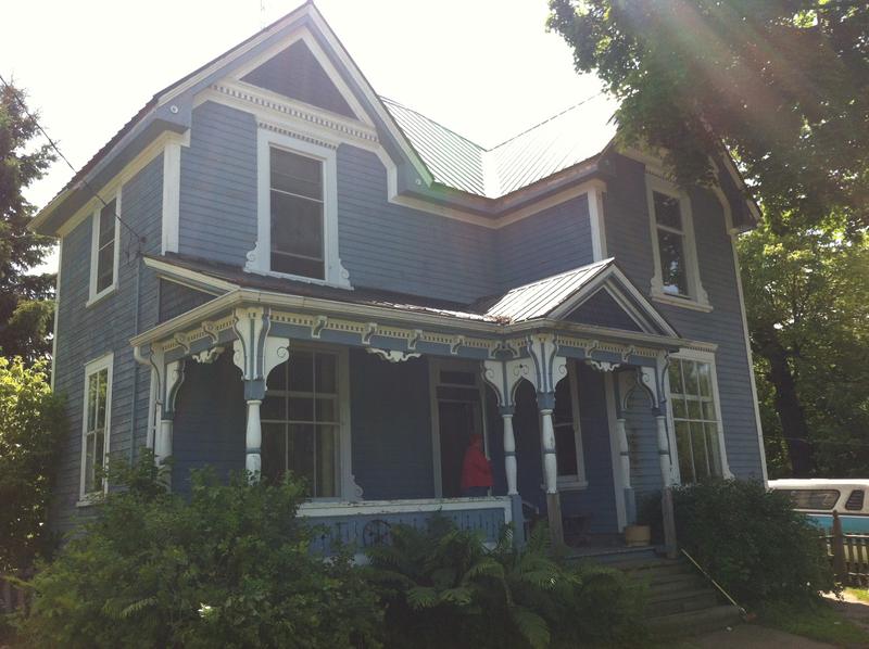

Inspecting a 100 year old home is my preferred inspection, I am a Heritage Carpenter by trade. My house I live in was built in 1877. See picture at bottom.
When inspecting a home that was built 100 years ago, you have to take in account the type of individual that built that home. Would I measure each step to see if they are uniform, NO absolutely not. That would be a waste a time, walk up them and if you trip there is an issue. The only time they are going to have differences in the risers is if there is settling occurring under them. The stairs them selfs were built better than the stairs of today. They were built the house to last by people who knew what they were doing.
One in every third house on average I inspect has a stone foundation. More often than not I am finding issues with the block foundation of the '70s than the stone foundation of the 1870’s.
There is issues to find in century homes like any other home. Those issues are usually related to poor maintenance, not how the house was built. So if you are inspecting that older home don’t look for the code flaws or the way a carpenter framed the rafters. They have already proven themselves, look for issues with from poor maintenance (deteriorating siding, roof covering, electrical).
