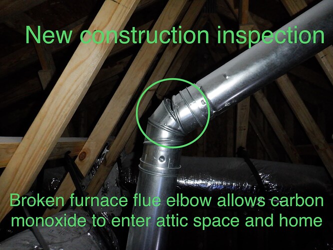

Oops, I think they forgot something!
If that is the case, I am mistaken.
Truly criminal setup.
When almost is not enough.
Brand new home :flushed:
If the room volume is sufficient, combustion air can be drawn from inside even with a 90% appliance. In the photo, it is the flue discharging into the house that is the problem and defect.
